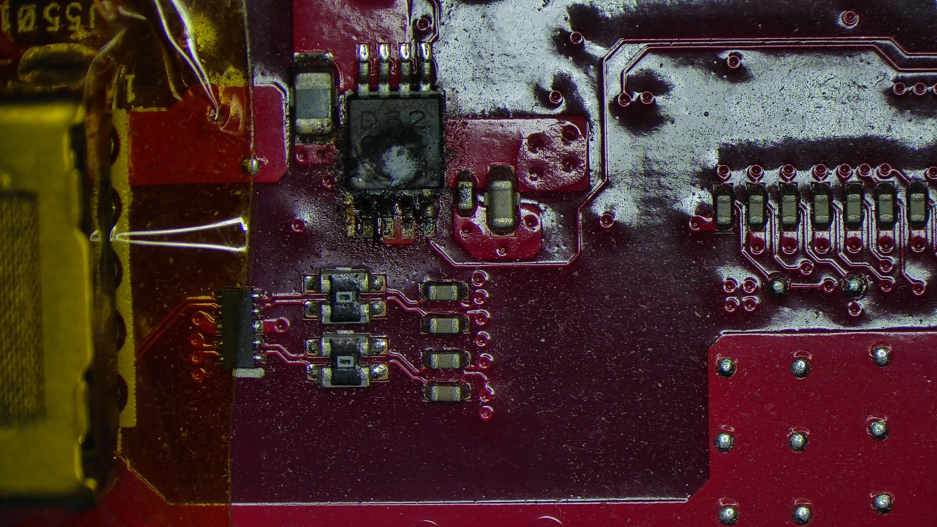

asus rog burn component, G703VI main board rev. 2.0
  • crozoki
    • Feb 2013
    • 44
    • Croatia
    Hello!
    Here is a motherboard from asus rog G703.
    G703VI main board rev. 2.0.
    On motherboard is burn one component and cannot read that component.
    The component is located on the opposite side of the laptop power button connector. I can turn on the laptop, but there is no picture and the fans are spinning at maximum speed
    can you help me figure out which component it is. thank you

    Can read ‘D82’ on the top line.

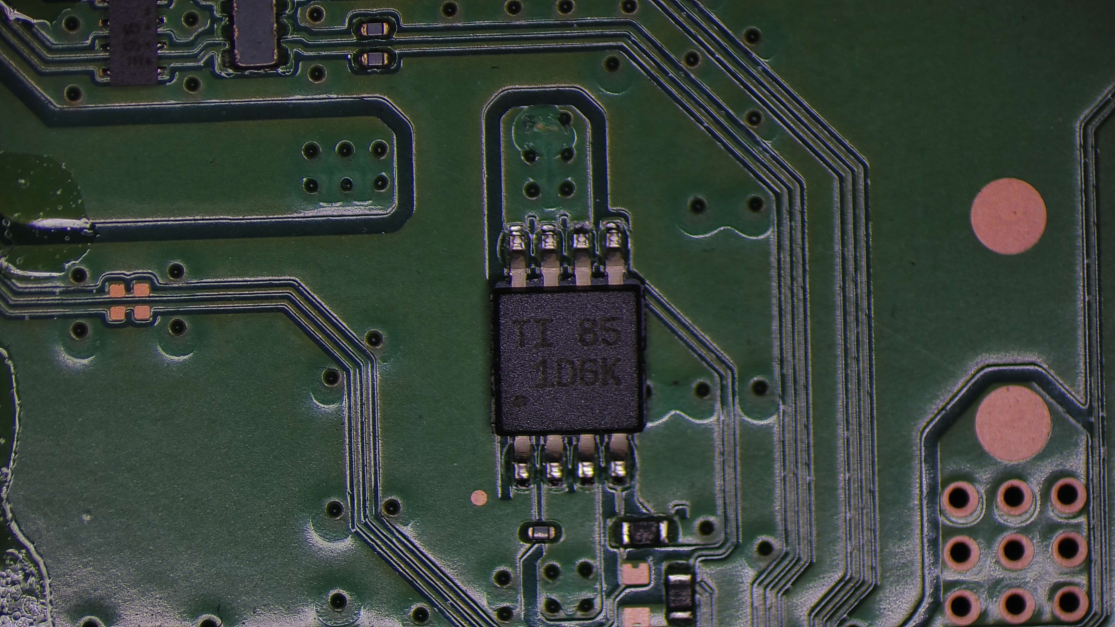

    It may be the following:
    https://kasynparts.com/product/ps4-s...c-replacement/

      I have a donor board from a ps4 pro. it has this component on it.

        Search for a similar looking part but with 'D82' SMD code on the component. The original component is apparently a load switch. The one on the shared pic is a part from TI and does not appear to be the same (may be a ADC / DAC).
