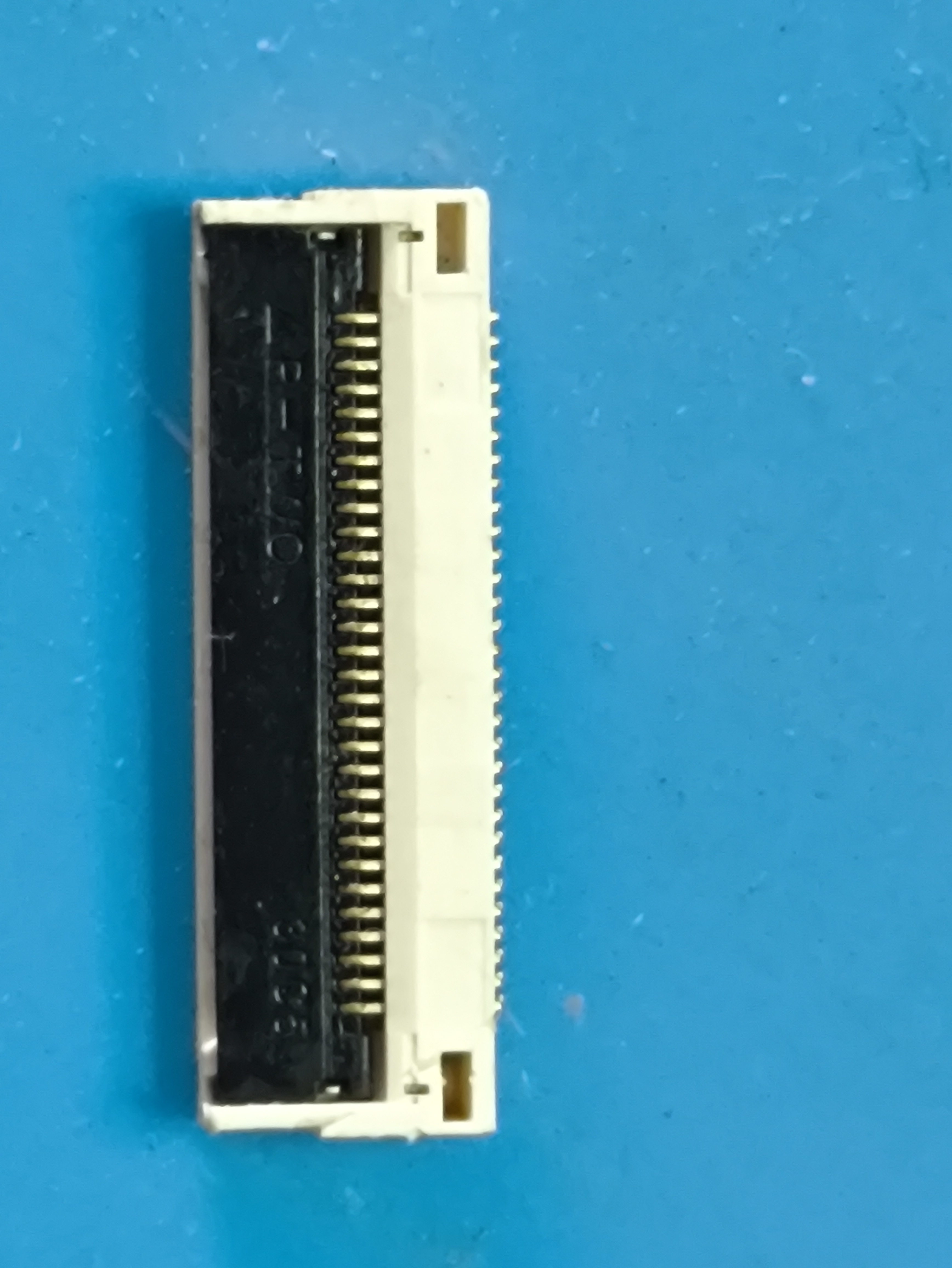

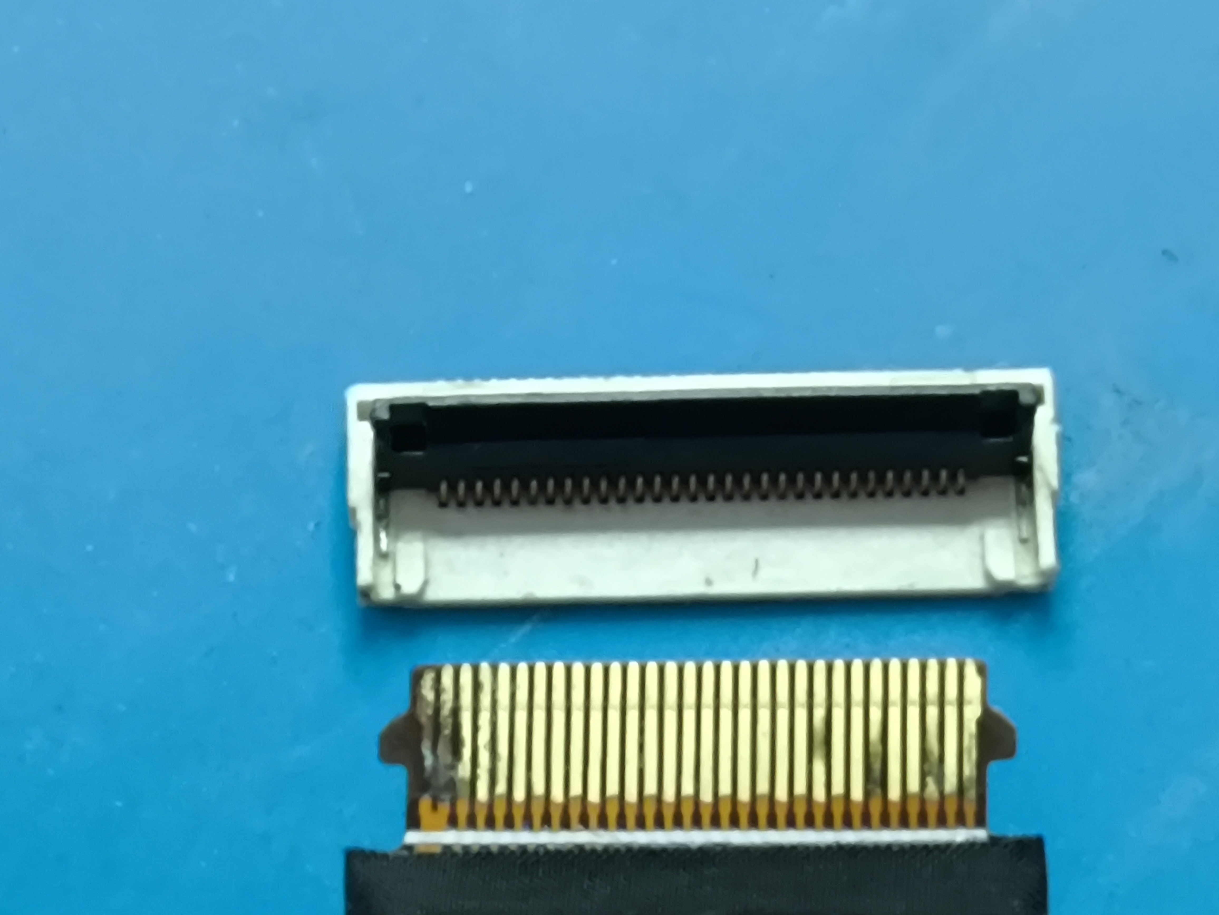

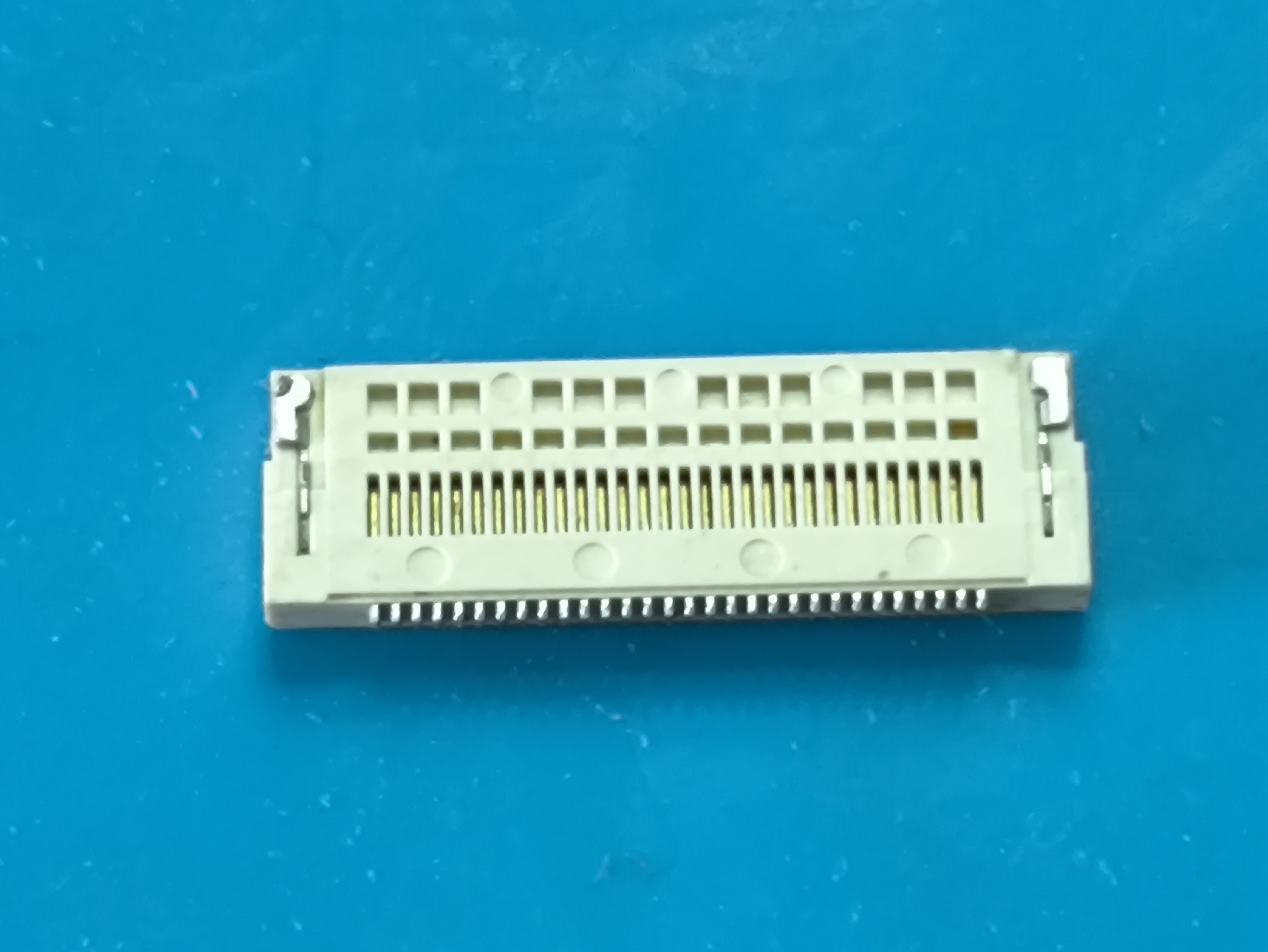

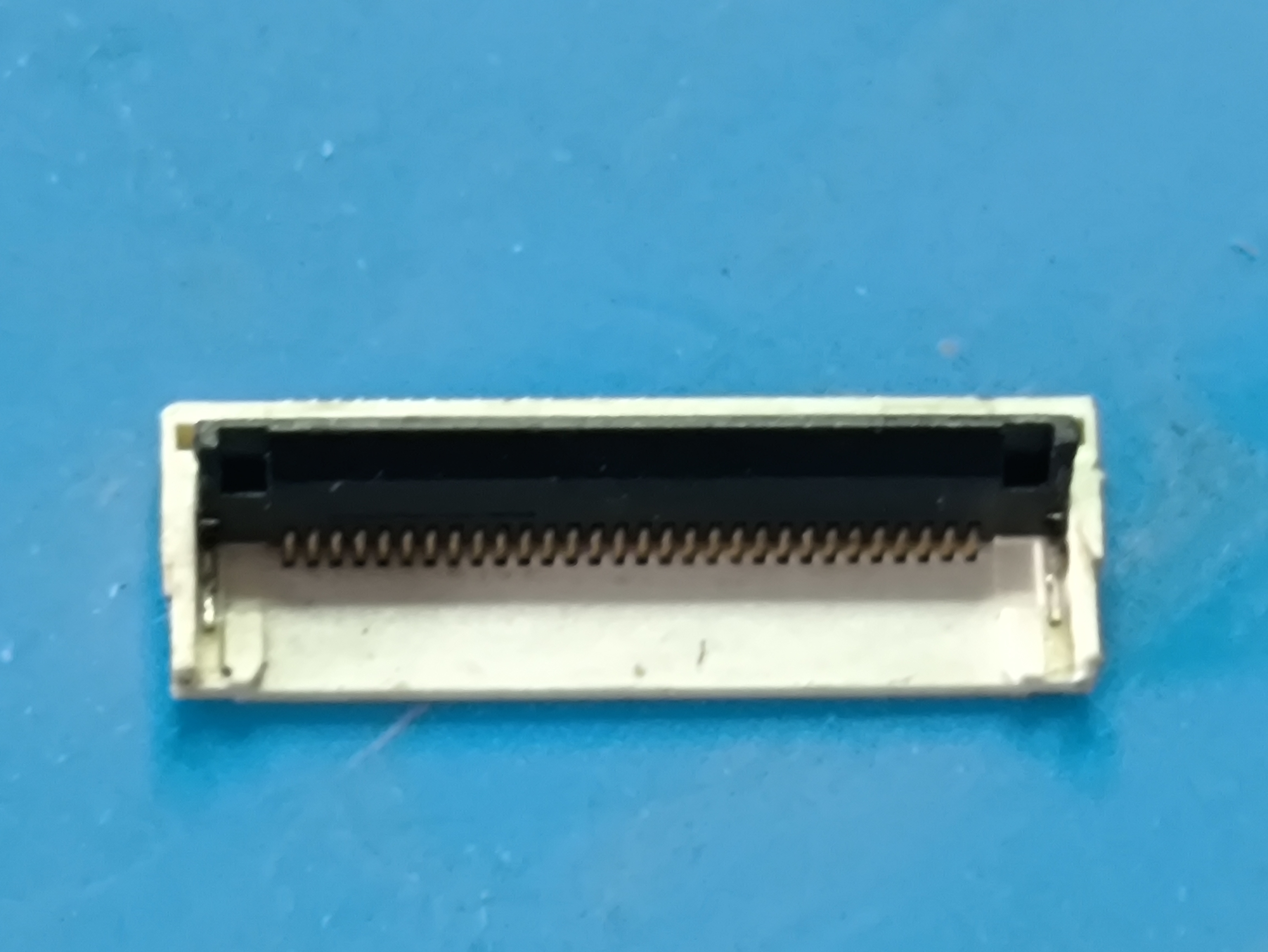

    Trying to identify where to source the LCD connectors on the motherboard side for a HP 14-cf2051la. This one came in with liquid damage to the connector and the flex cable. It appeared to clean up ok, however customer says that display blanks out intermittently. It's a 30 pin EDP flat ribbon cable on motherboard side. Believe it to be a HEDWIG-6050A3155301-MB-A01 motherboard.
    I've stolen the connector from another HP motherboard which matches up but it's not the best since it's been kicking around my donor pile for a while. This connector is different to most flip type ones I have in that it has the small ears on each side of the connector to make it's correctly inserted.
    Only thing on the connector is 'P-TWO' and '30C5'. Pic's attached.

    https://www.p-two.com/index.php?do=prod&tpid=45
    • reformatt
      • Feb 2020
      • 1494
      That website wasn't much help. But it appears that this connector is also an ACES 51519-xxxxx-xxx connector as well.
      https://www.acesconn.com/series/51519-xxxxx-xxx/2079
      Still working on where to source it.

        You can try the method we use in case there are no alternative ingredients. We will use empty pins to replace the damaged pins of the connector.

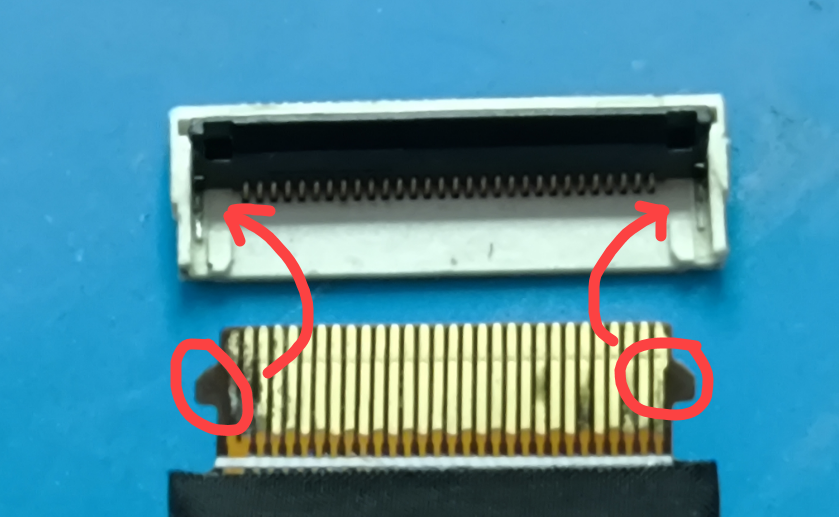

                Is the attached what is so special about this connector?

                  Yes, those tabs are the difficult part when scrolling through Aliexpress for a suitable replacement. The other issue is the location of the ground anchor.
                  But did a parametric search on Digikey, and found what looks to be suitable from Kyocera. Tabbed and ground anchors line up ok, part # 046288030000846+
                  https://www.digikey.com.au/en/produc...000846/2001004
                  https://au.mouser.com/ProductDetail/...FYbA40zA%3D%3D
                  • reformatt
                    • Feb 2020
                    • 1494
                    FYI. Ordered that connector off Digikey, and is a perfect match.
