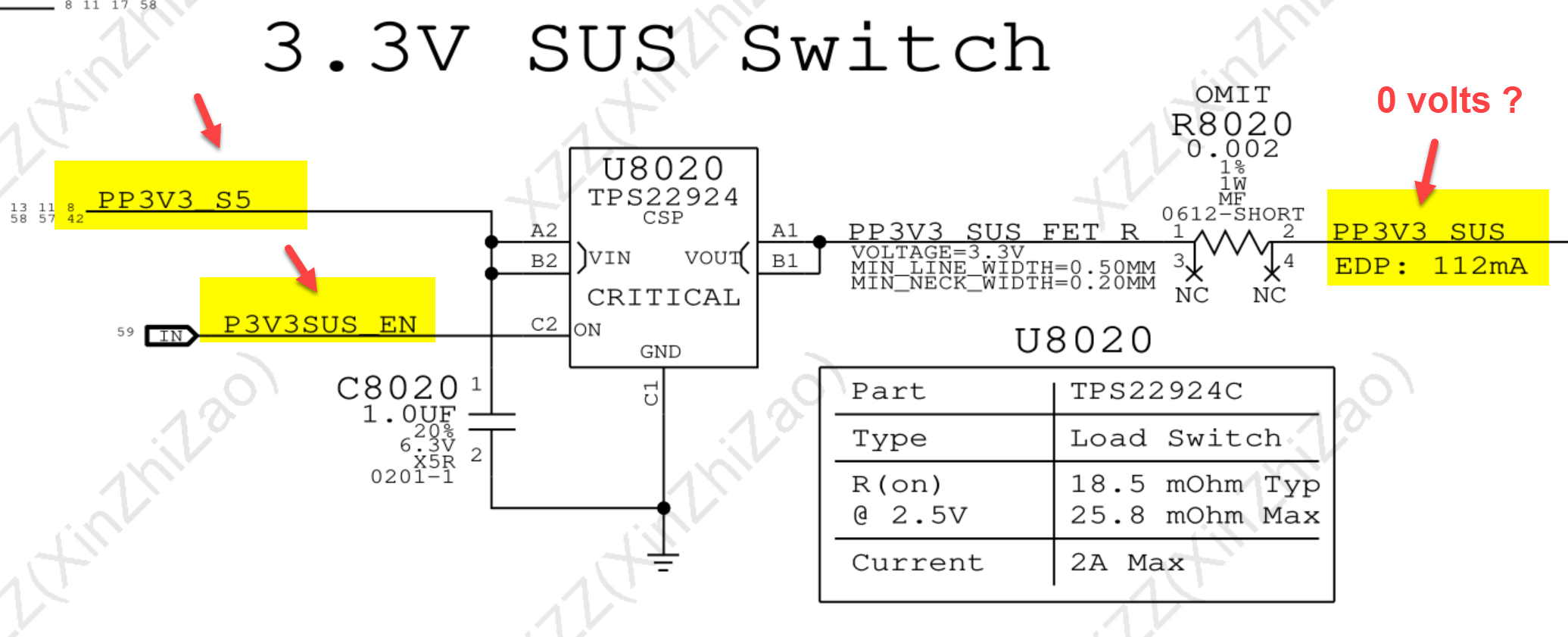

                                      Confirm the voltages to ground (not diode mode) for the following load switch which is linked to the PP3v3_SUS line. Since it is 0 volts - check if this low current rail is being enabled. If it is being enabled AND the Vin is present, then this load switch is defective.
                                      Confirm the exact voltage to ground (not diode mode) for PP3V3_S5_REG_R @ L7560. This must be a stable 3v3. Provided it is, then pin # 20 of U7501 should be a logic '1' = power good is OK. This logic '1' will be present only if U7501 is working; soldered properly; external 100k pull-up resistor @ R8141 is present; the pull-up voltage of PP3v42_G3H is present on this same resistor. If this external resistor is missing then you will observe little to no voltage on this power good output because the output signal is 'floating' when the output state is OK = high impedance / like an open switch. The external resistor is required to park this floating output signal.
                                      This power good status is not linked to the bios provided the above conditions are being met by U7501. It is quite important that U7501 is properly soldered and without any contact shorts, etc. Flux it well; heat it well and make it swim into the liquid solder.

                                        i have pp3v3_s5 but 0v on pp3v3sus_en
                                        on l7560 i have 3,325 stable
