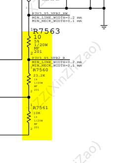

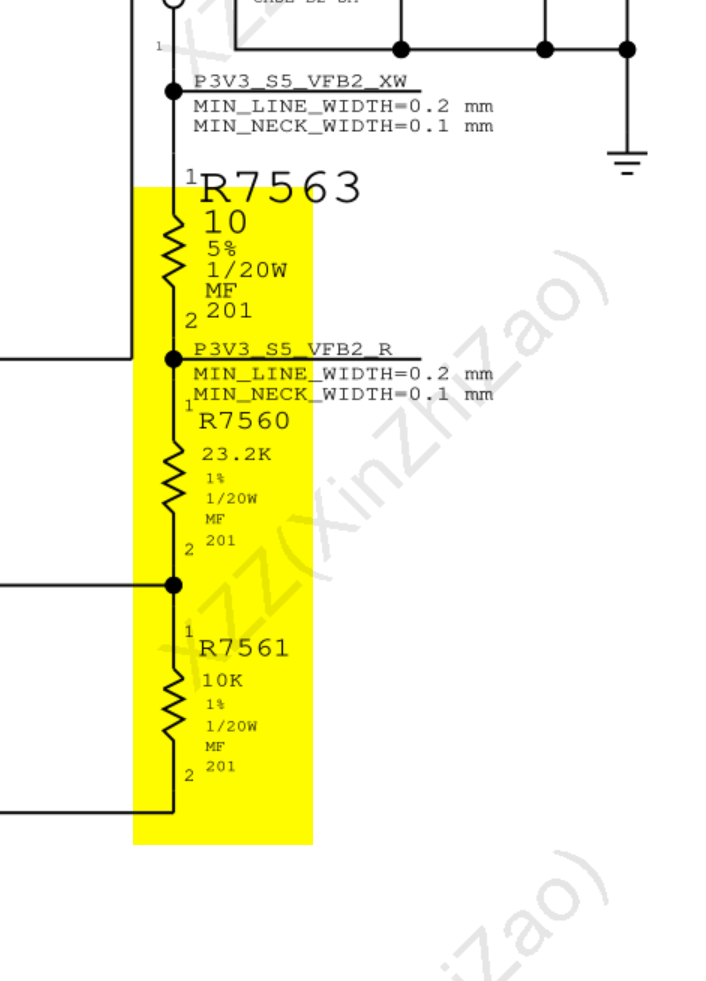

                        2v8 is too low for this 3v3 power rail. You should have a stable 3v3 at the output. The enable signal is fine since you have a voltage. Replace this regulator. The 2v8 is too low and the power good signal is being pulled low to announce this status of this power rail.
                        Also see attached. These are the feedback resistors that must be present and accurate to dial up the 3v3 output voltage. Do check these without power to the board. Then proceed to replace the regulator. Keep posting your updates.

                            Double check your work of this replacement part. The resistors are ok as requested in post # 12 ? Monitoring 20+ posts per day here so do bear that in mind.

                                R7563 15 ohm
                                R7560 9,5k
                                R7561 7k
                                same readings of another motherboard
