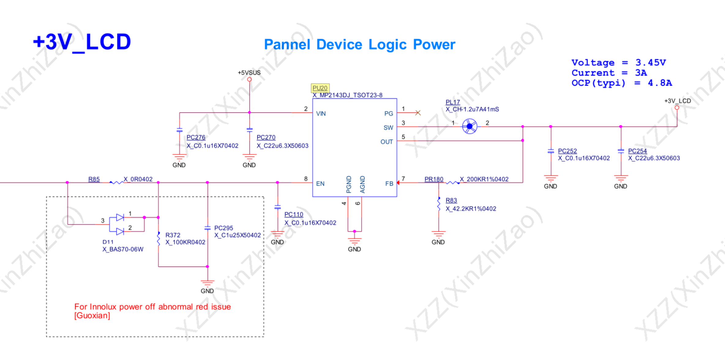

Hi, i need some help to identify what component is pu20, this was burned literally and in the boardview i cant see the name of the component , this is the boardview, thanks.
					need help identifiying component pu20 msi 17f31

 From an alternative MSI schematic, PU20 is MP2143DJ.
 MP2143DJ-LF-P Monolithic Power Systems Inc. | Integrated Circuits (ICs) | DigiKey
