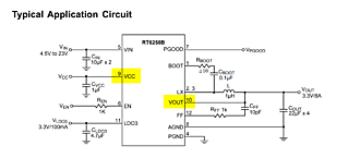

    hi , my motherboard is short after ram change. here is some pics. i think this component is short. thank you

    The angle of the shared last pic is not clear but appears to be with topside markings of "LE=" ? If there is an '=' in the markings, the part is from Richtek. Only the first 2 letters of the markings are relevant. The markings after the '=' are the manufacturer's datecode for this component and can be ignored.
    In searching for 'Richtek LE=', the part is:
    Richtek RT6258BGQUF
    https://www.richtek.com/assets/produ...S6258BC-03.pdf
    To confirm if this part is shorted, remove all power -> meter in resistance mode -> measure the resistance to ground for the output of this regulator. Also a good idea to test the same in DIODE mode on your meter. Red meter probe to ground; black meter probe onto the output of the point to test.
    Post each measurement.

      thank you mon2 . i see now from datasheet that VCC and VOUT have short to ground also when component removed . but now there is no overheating component . when i test the component outside the board there is no short on it . how can i know what component is short ???

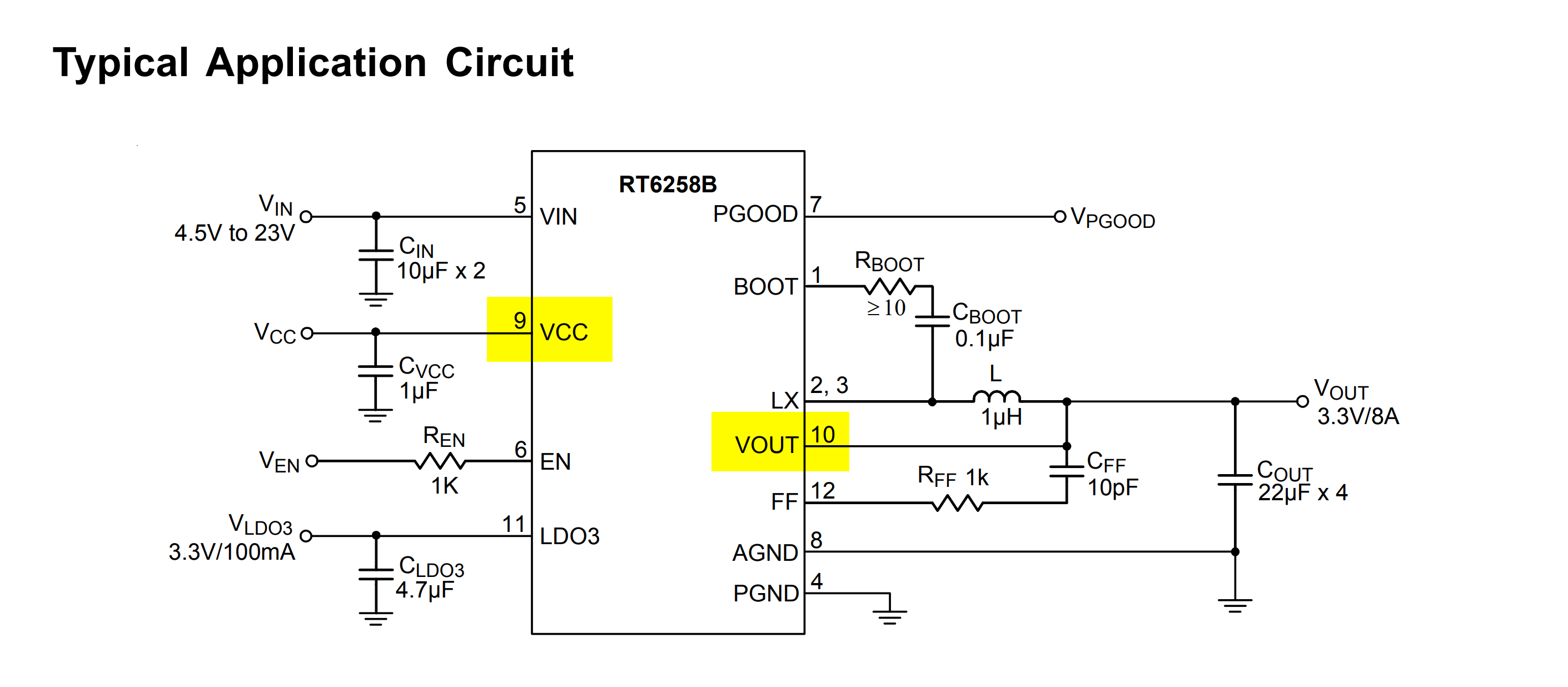

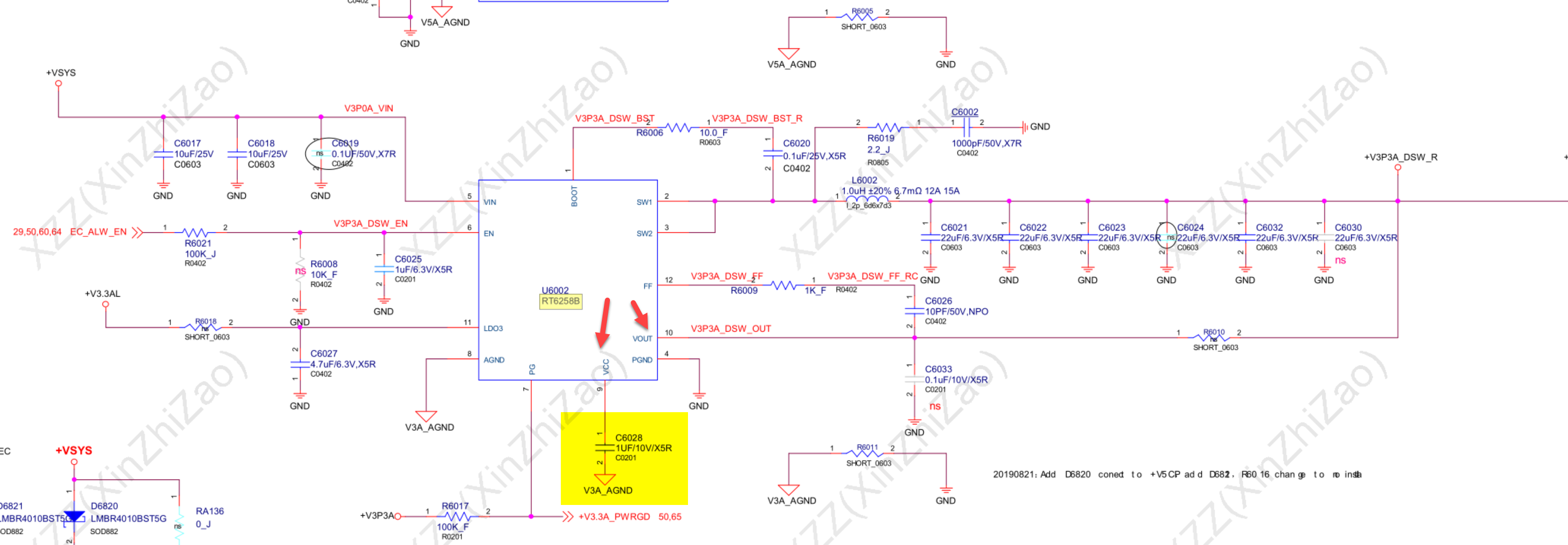

        From the schematic, there are a number of this part onboard. This exact part must be the one with a 'B' in the suffix. Based on this search, your defective part is @ U6002.
        Can you confirm that VCC (pin # 9) is with a short? Remove all power -> meter in resistance mode. What is the exact resistance to ground? Same question for VOUT (pin # 10).
        Respectively, VCC is a LDO (low current) output rail that accepts the high voltage on VIN and lowers it to a suitable 5 volt to power thic IC. Only being loaded by the IC and C6028. Carefully flux and remove C6028. Then check the resistance to ground again for VCC.

          ok thank you .i think cpu is shorting
