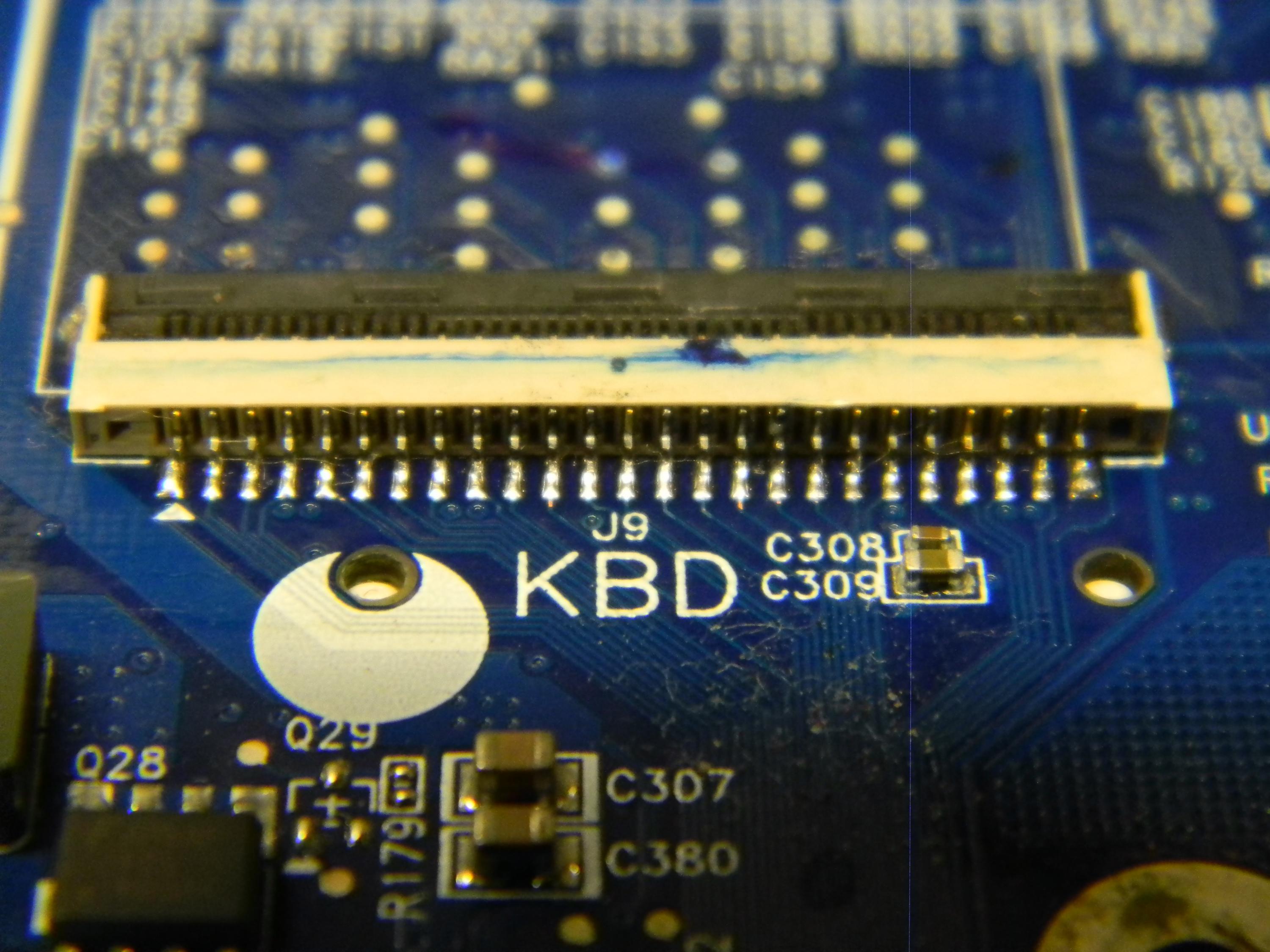

    first you need the schematic for the board so you can see what pins goes where.
    about the soldering job.
    i did my share or xp with cellphones its not that hard, you just need to be confident on your tools.
    after a few years i realize that i can work even with a cheap 40w wall plugged iron.
    Ex(kb connector).
    on samsung galaxy s3 its very hard to solder the legs because they are so small and only a few weeks ago i manage to find a way to solder them perfectly.
    I touch the leg with the iron and and i putt the solder on top of the leg and when its hot it melts on the pin. on small pins i use the iron from a Gordak station because it got a small tip(it heats the leg slower but you can do the job nice)
    I think in your case you need find the location of the pins where they go and just jump it with a wire
