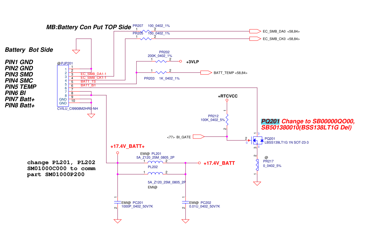

            Found out the problem, laptop work now on the battery, problem is with BATT_B/I does not go to 0V, while jumper is done on the battery connector to ground battery being charged, and laptop does work on battery & charger as well. Is that safe to leave it like that? If not, i can only suspect PQ201, i don't have replacement to test and i can't find it online.

              Use 2N7002 for PQ201.

                Laptop fixed, I had problem with first mosfet (internal short in mosfet) and faulty diode pq201, I've replaced as well BQ however I did not confirmed if that was needed. Thanks for all help.
