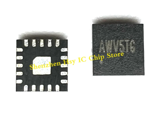

    Hello guys, I'm trying to fix this laptop hp 15-cs003, which when i removed the battery it suddenly stoped turning on and even the led, which indicates that's charging isn't turning on.
    I am trying to fix it, and i found a problem with this chip "AWVAAH", which I can't find on the internet or AliExpress, anything...
    I found some chips that look like that, but nothing equal.
    Can someone please help me find this "AWVAAH", i will show a picture of him.
    Thanks a lot for the help!

    Here it is -> https://www.badcaps.net/forum/troubl...12#post1538202

      I have found this "AWV5T6" it looks like what im trying to find which is "AWVAAH". You think they are the same / it works is i replace with that?
        SMDFlea commented
        Editing a comment
        The last 3 digits are a date code it could be anything AWV*** .If the part is SY8286BRAC it is the right one
