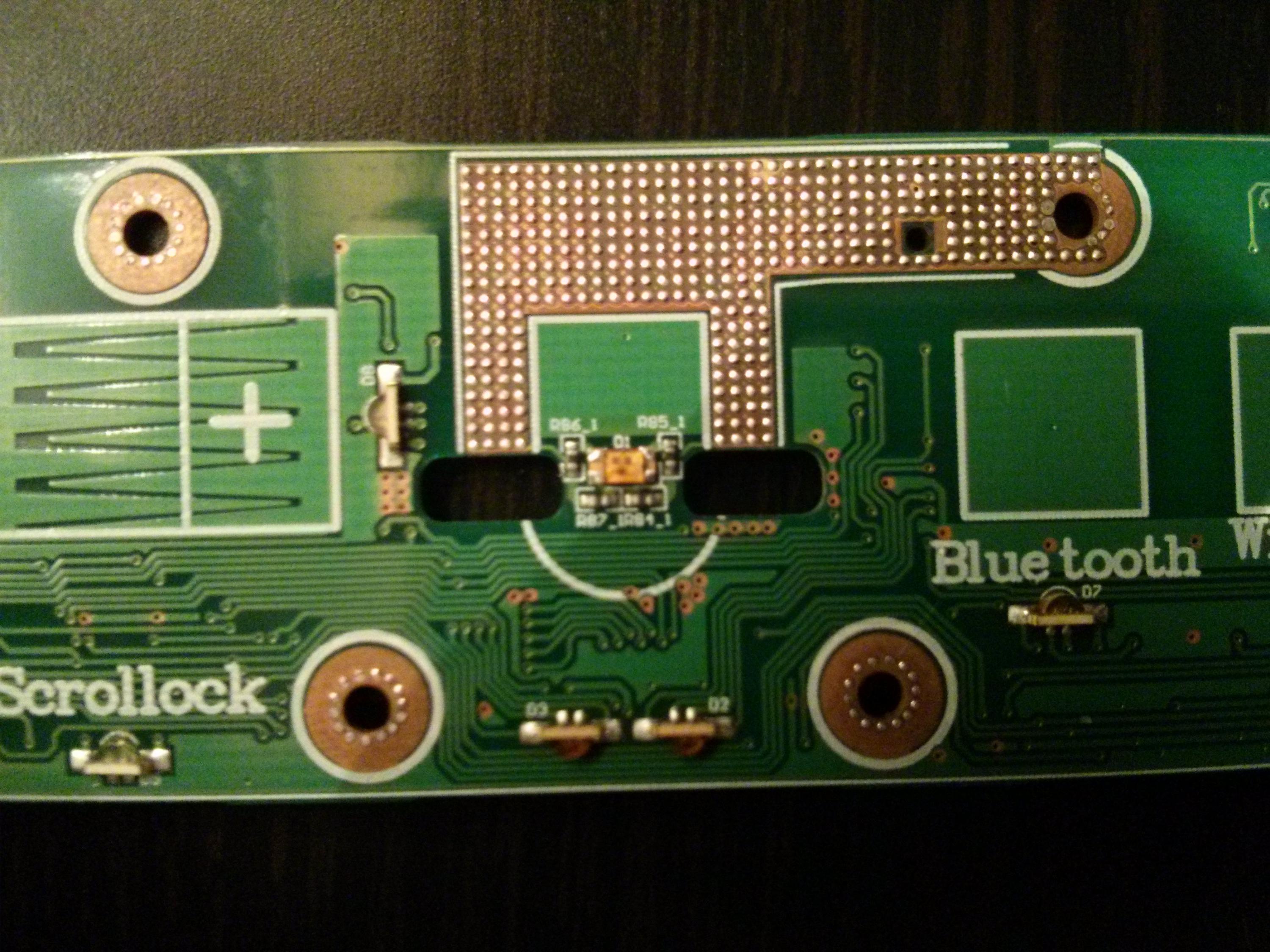

    The board underneath the power button that has LEDs for Capslock, Numlock, Scrollock, Power, Bluetooth, Wireless, Alienware and Low Power - none of which are lighting up. I have to admit that since I got it the power button was stiff and had to be pressed fairly hard to switch the machine on. Although I didn't often use the power button as if put the machine to sleep and then wake it with any key.

                Re: Alienware M17x R1 - No Power LED
                Morning mate

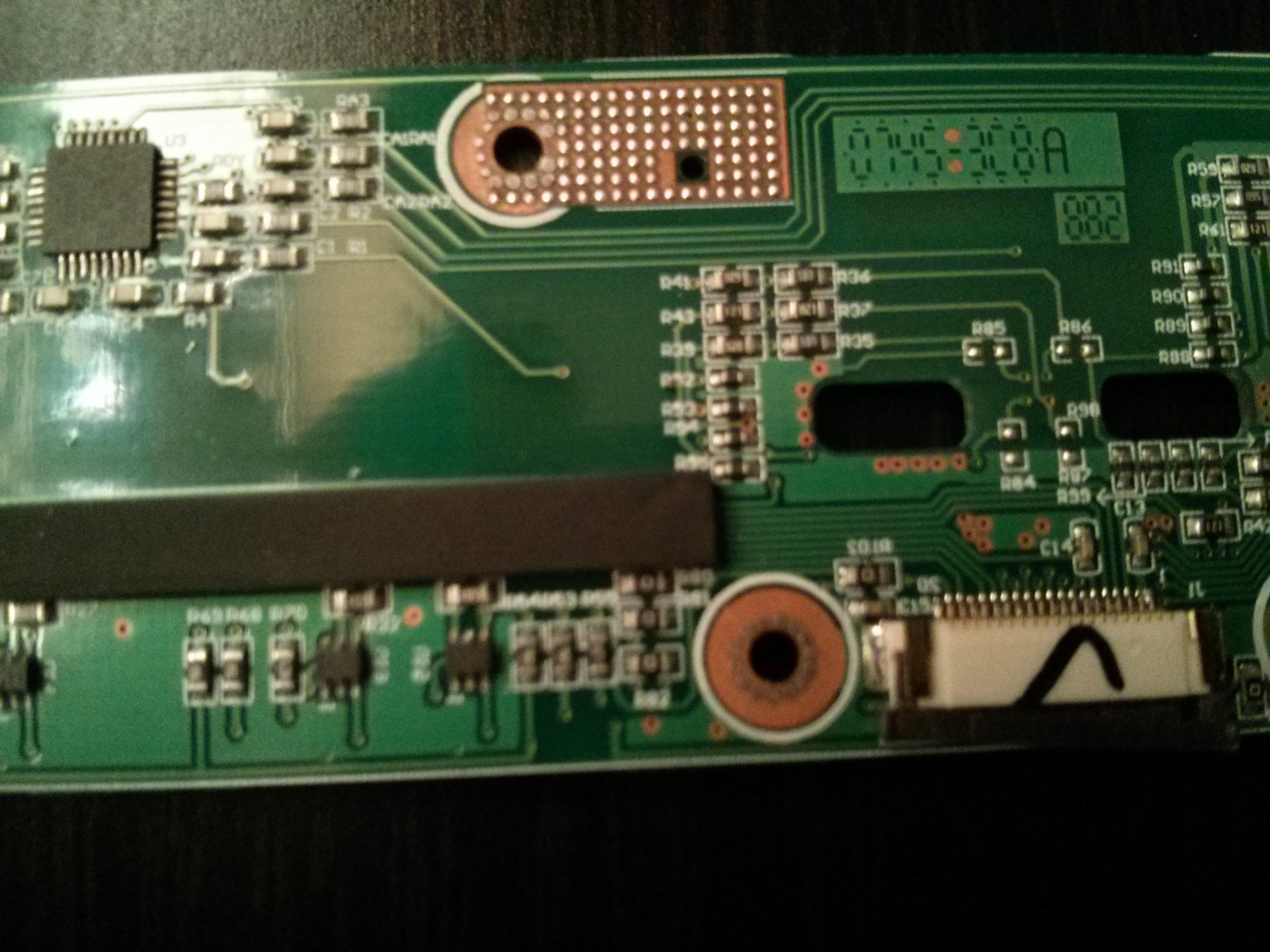

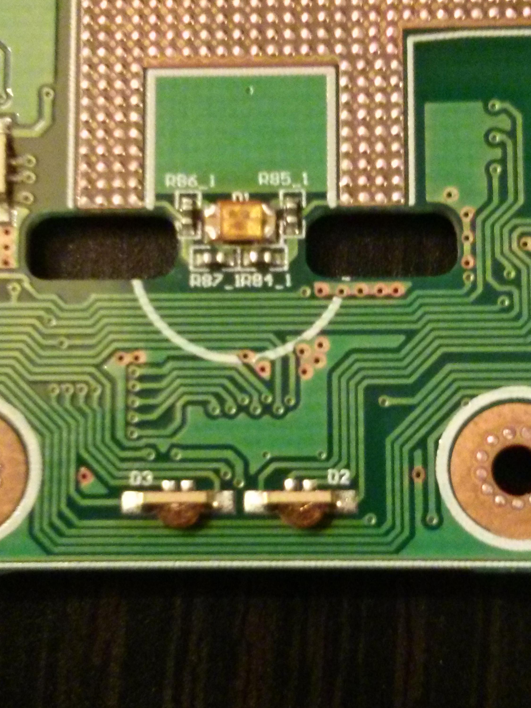

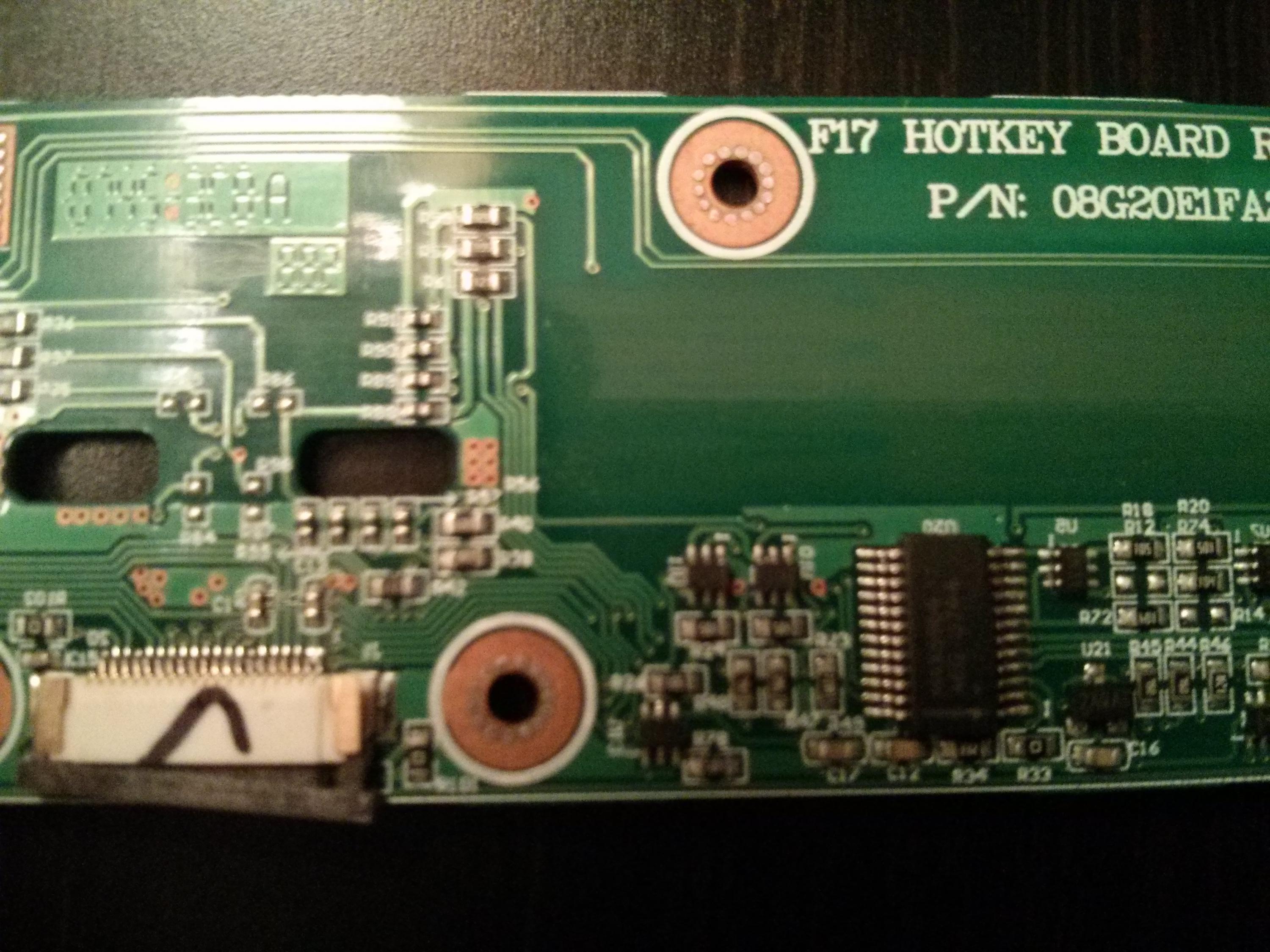

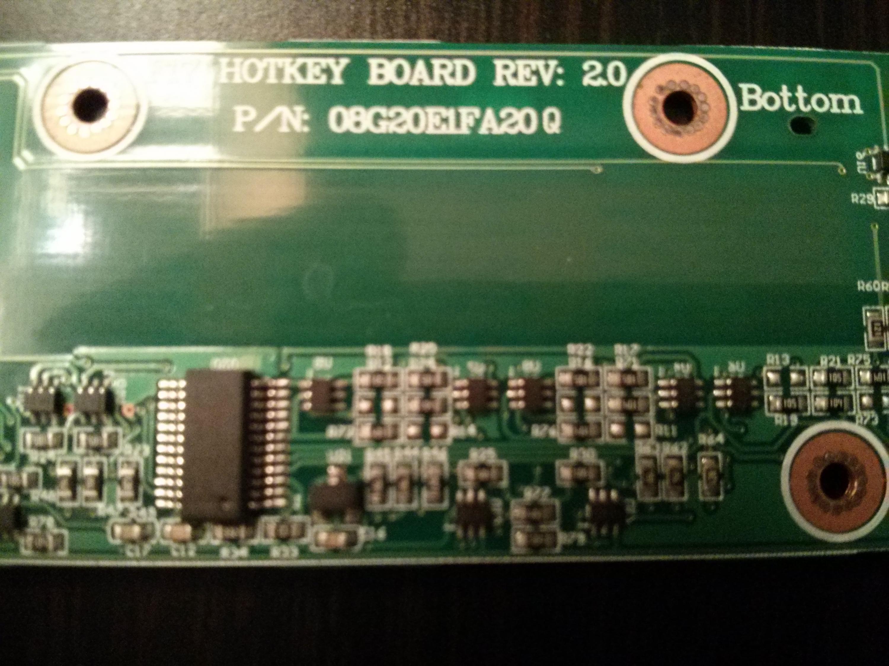

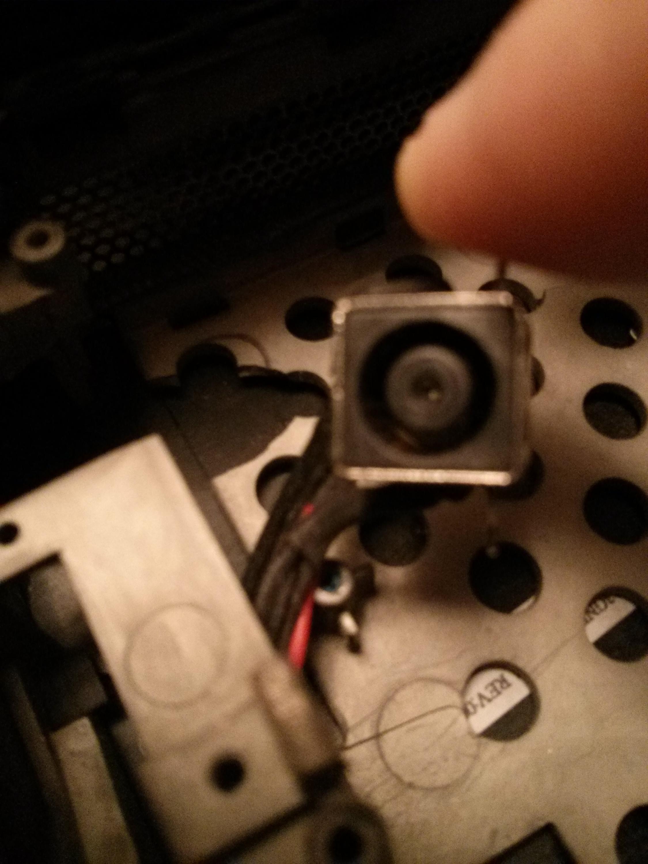

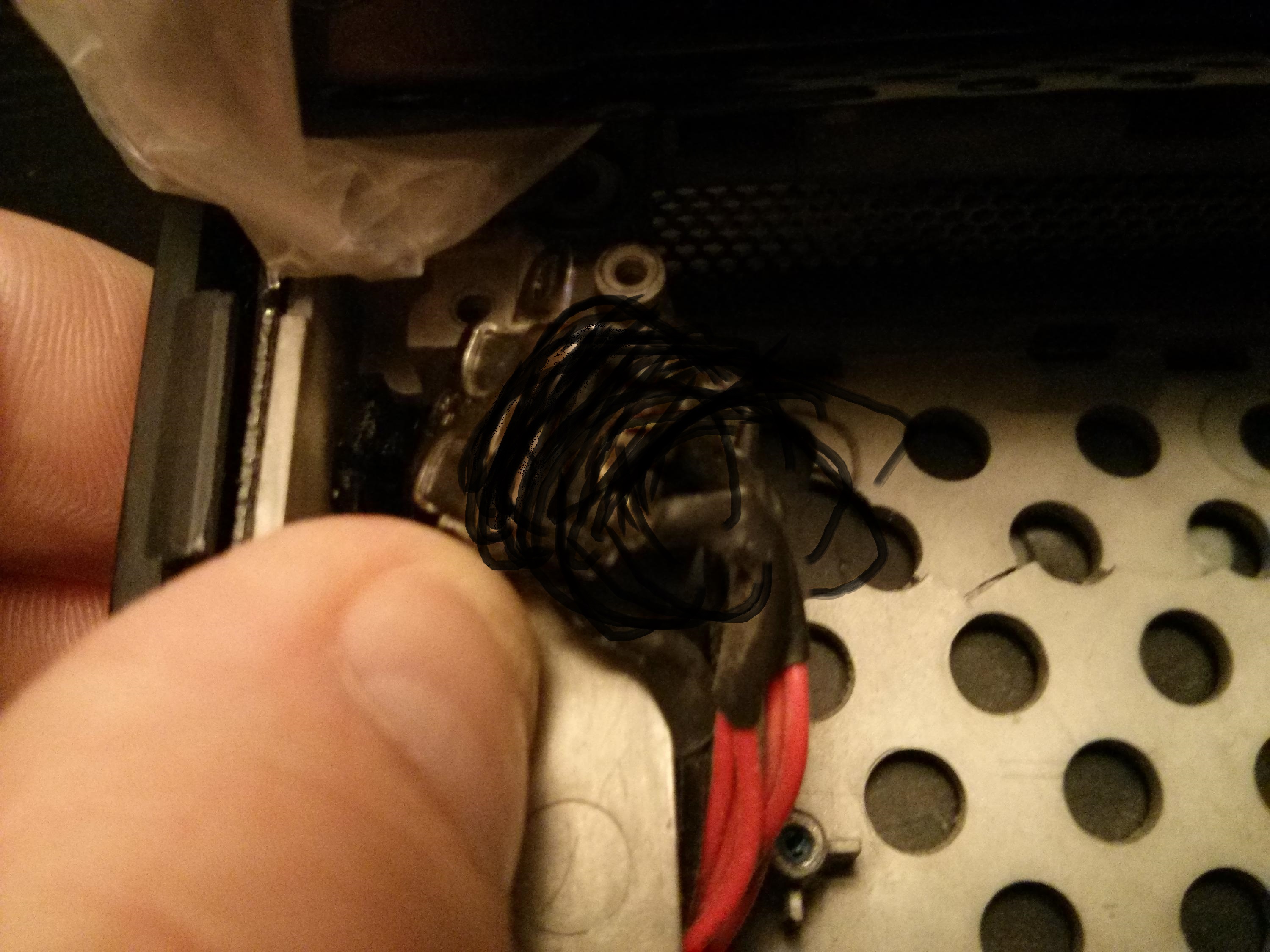

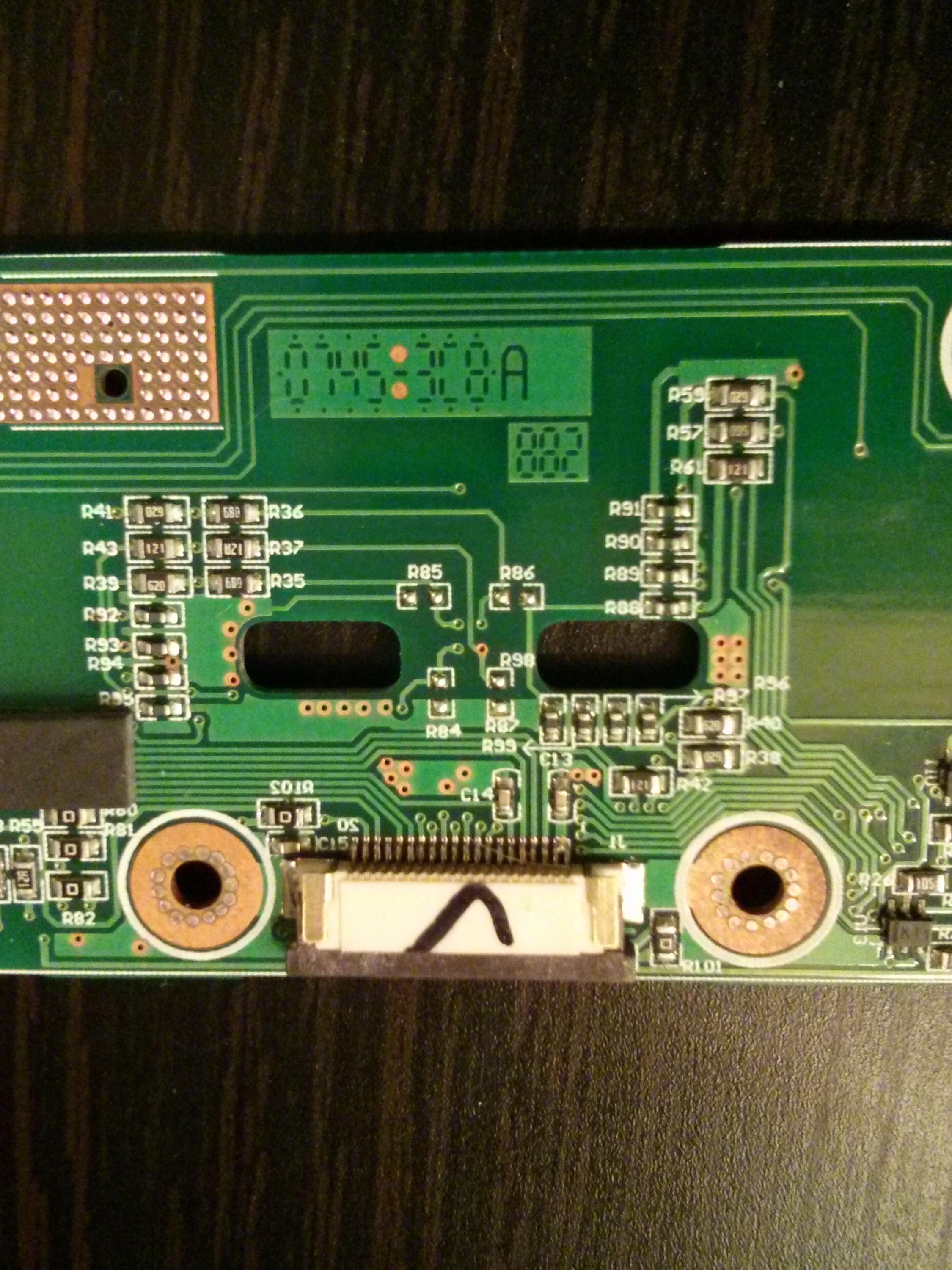

                I've taken some photos this morning.The weather isn't showing any signs of brightening up so I bit the bullet and tried to take some photos underneath a light. They haven't come out fantastic as my Nexus 4 isn't always very good for macro shots. I can try again with my son's iPhone when he gets up if you can't see things very well.

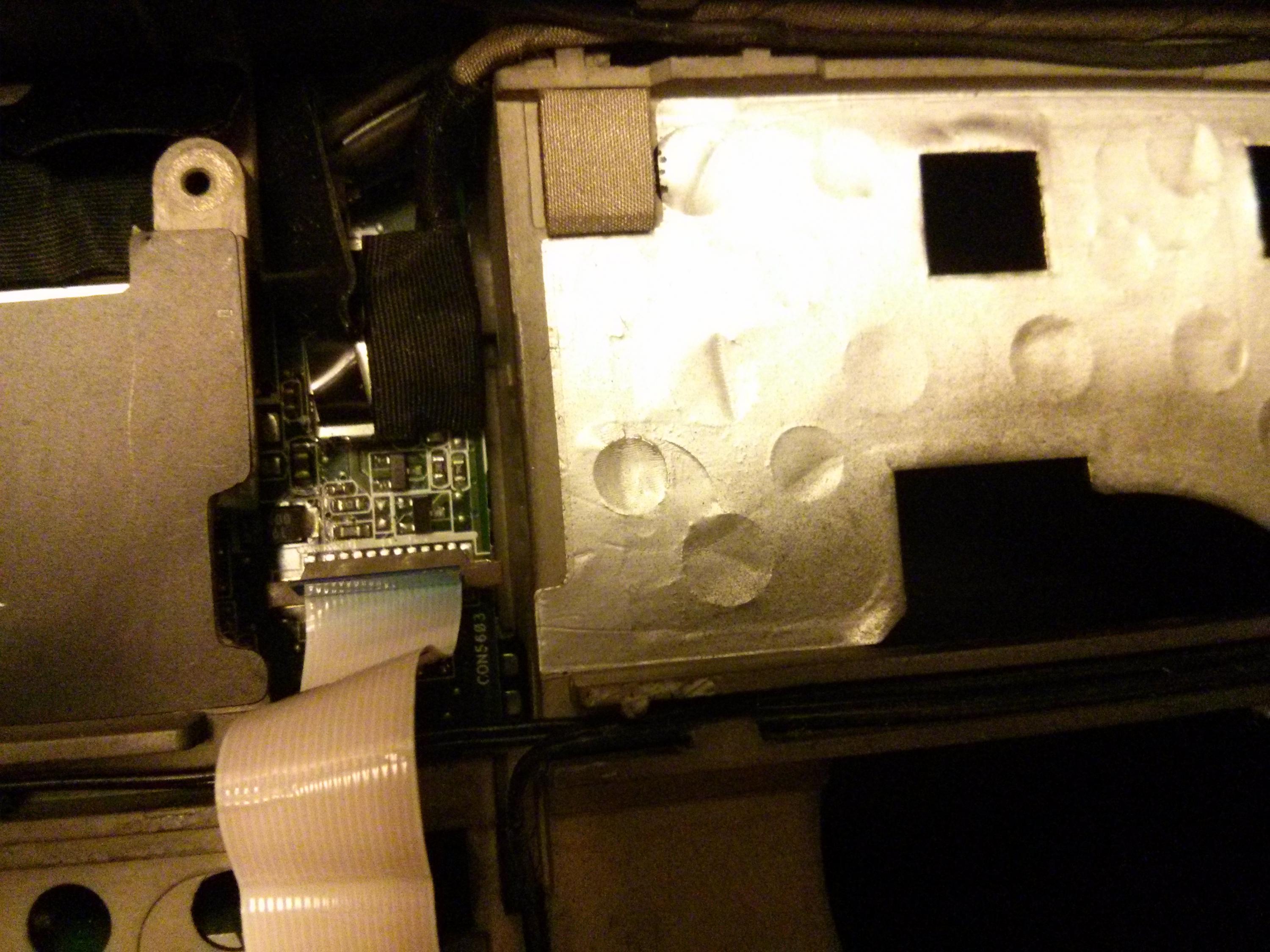

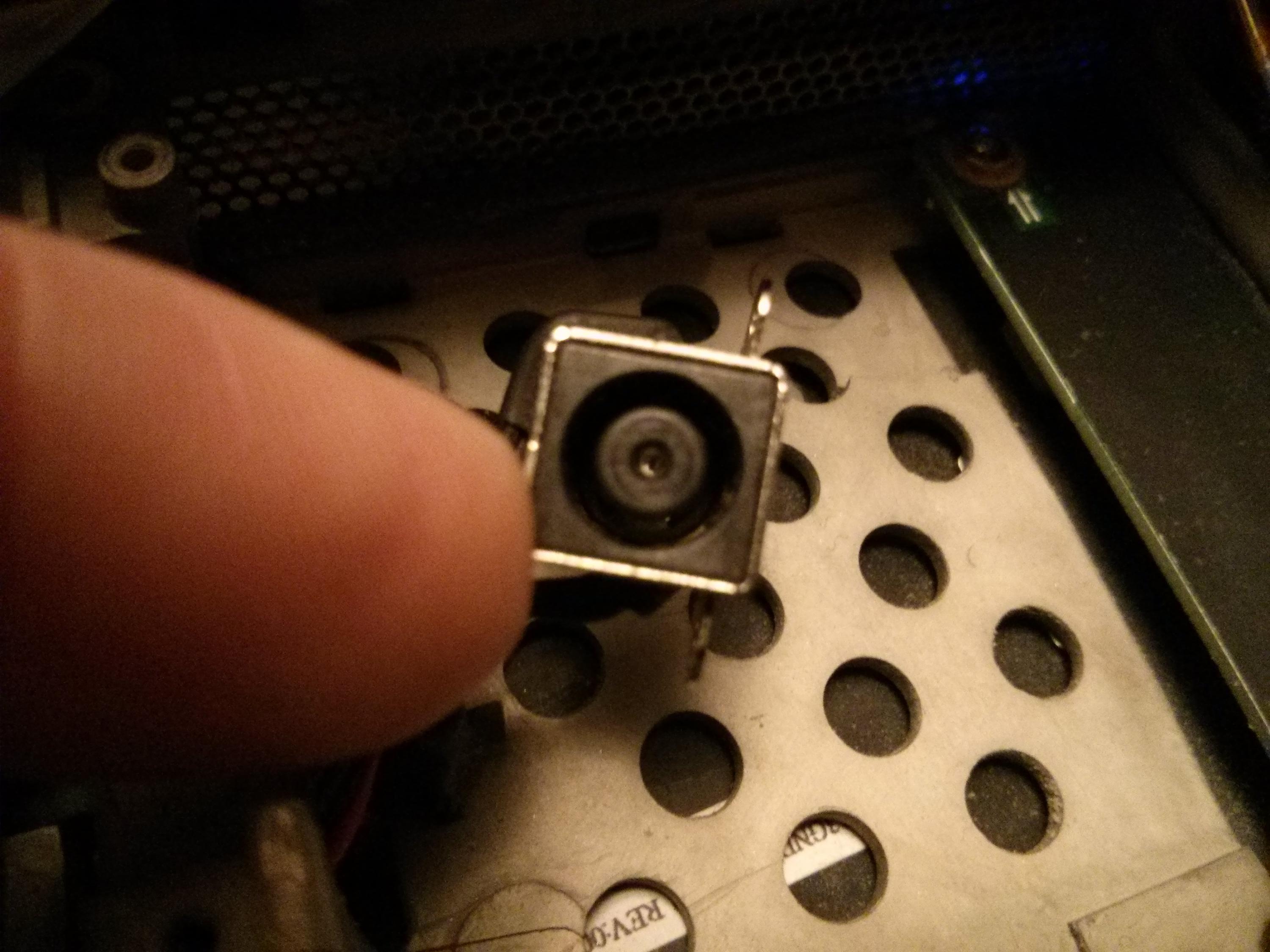

                I've taken a few photos of the DC jack, front and back, plus where the cable plugs into the motherboard. Also, there's quite a few shots of the Hotkey Power Board, and there are two shots of where the power button sits, this is indicated by a white semi circle underneath.
                I've got my DMM at the ready and some time set aside today so I'm hoping you can point me in the right direction please

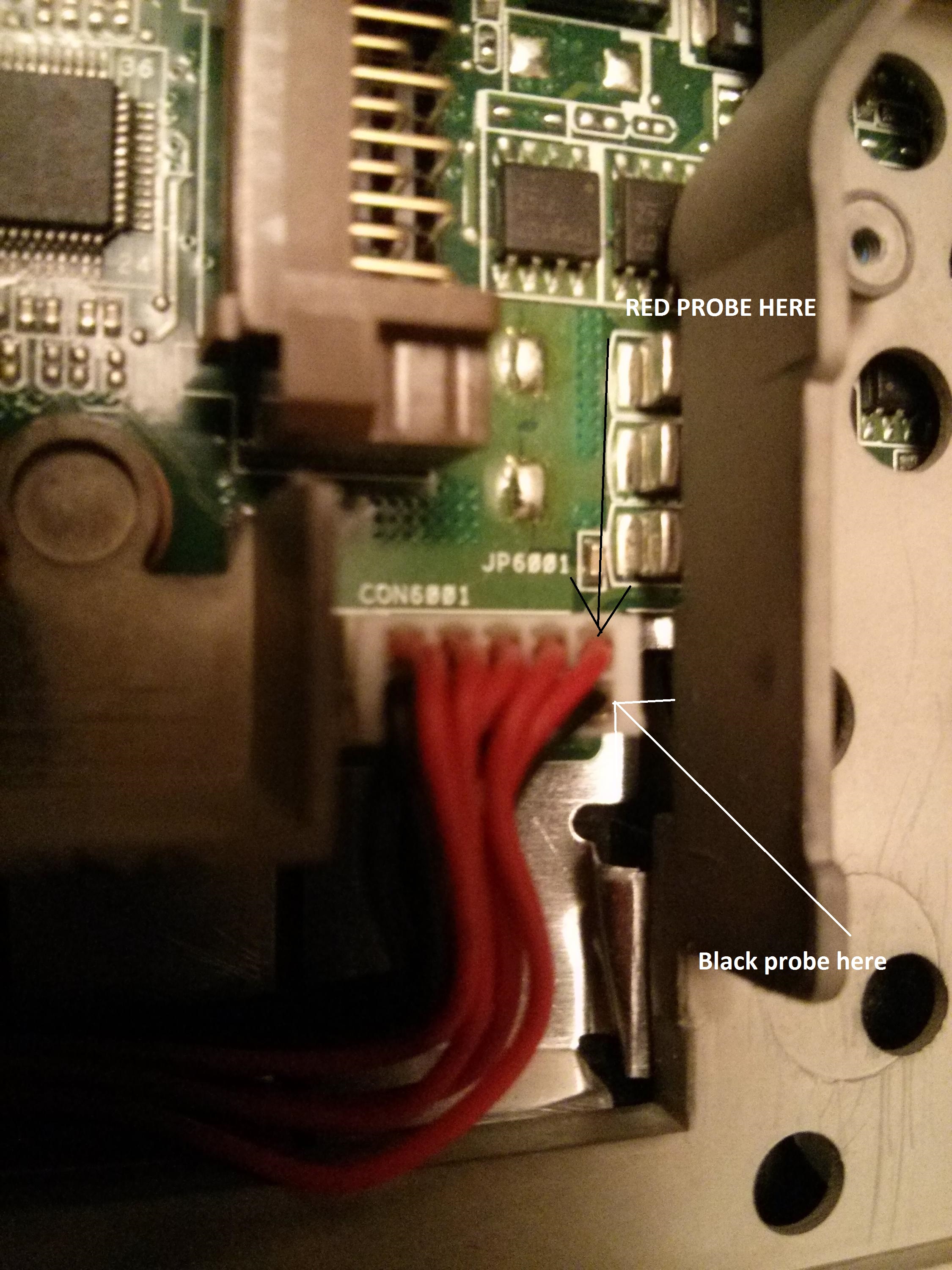

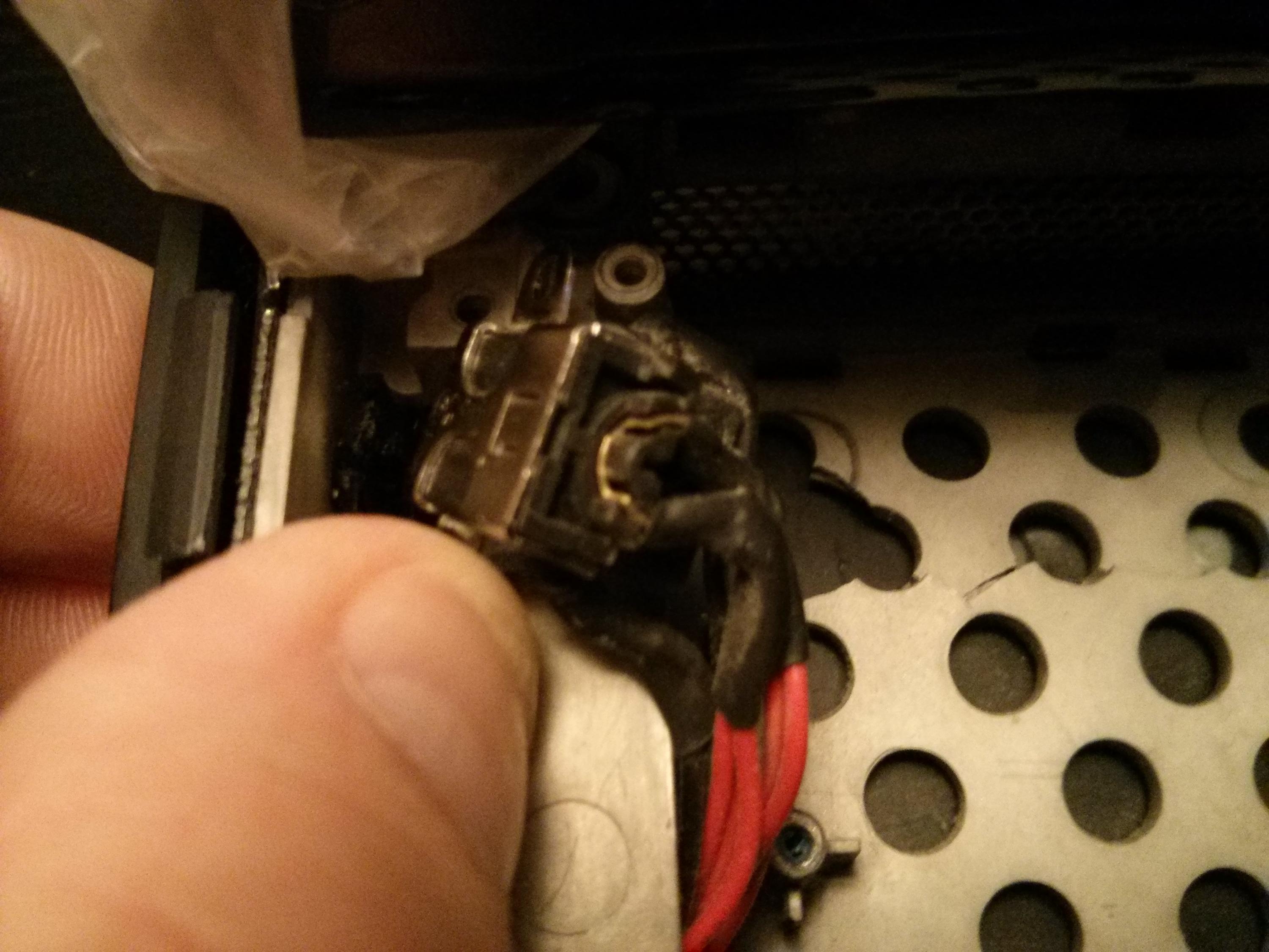

                  1. the power jack you need to rap it up in electrical tape . you know better safe then sorry
                  2.with the dmm after you connected the adapter( don`t let any metal touch the MOBO ) putt the probes there and see how much V you get.
                  see if you get 19v

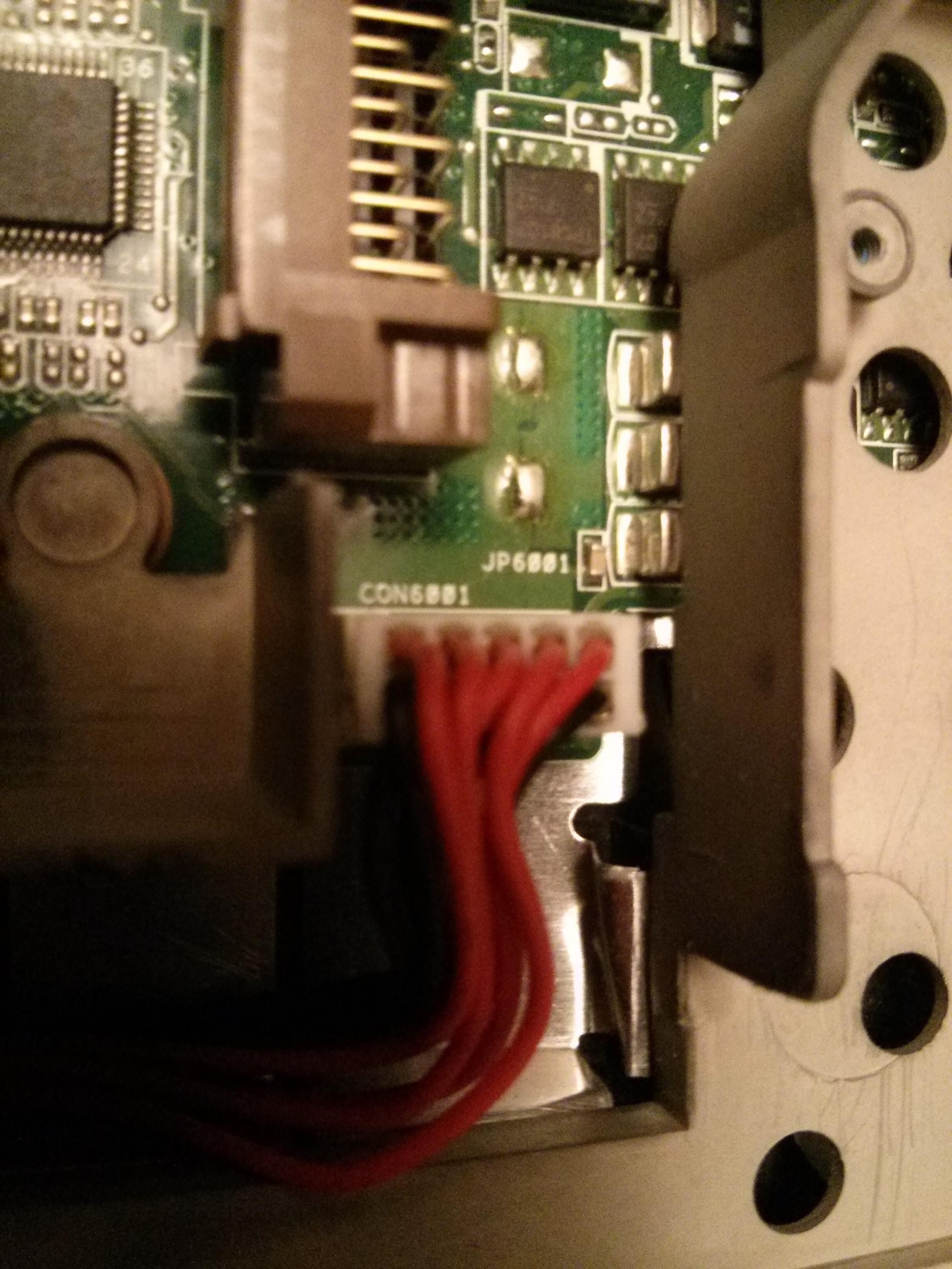

                    I'll dig out my tape and cover the back of the DC jack as suggested.
                    I've tested the probes on each of the wires going into the white connector.
                    Red Probe > Red Wire
                    Black Probe > Black Wire
                    Each wire across the connector reads between 19.6 to 19.7v.

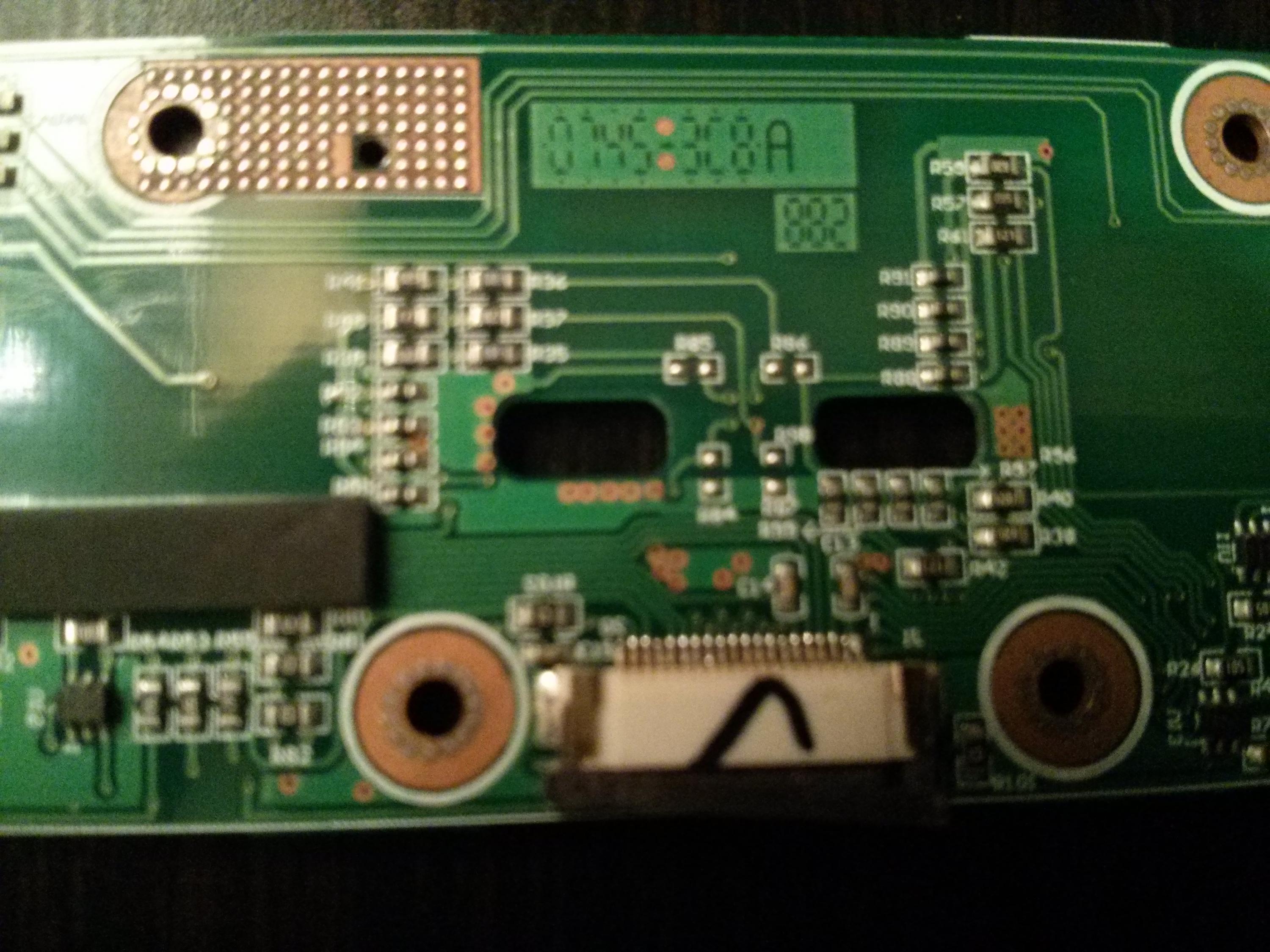

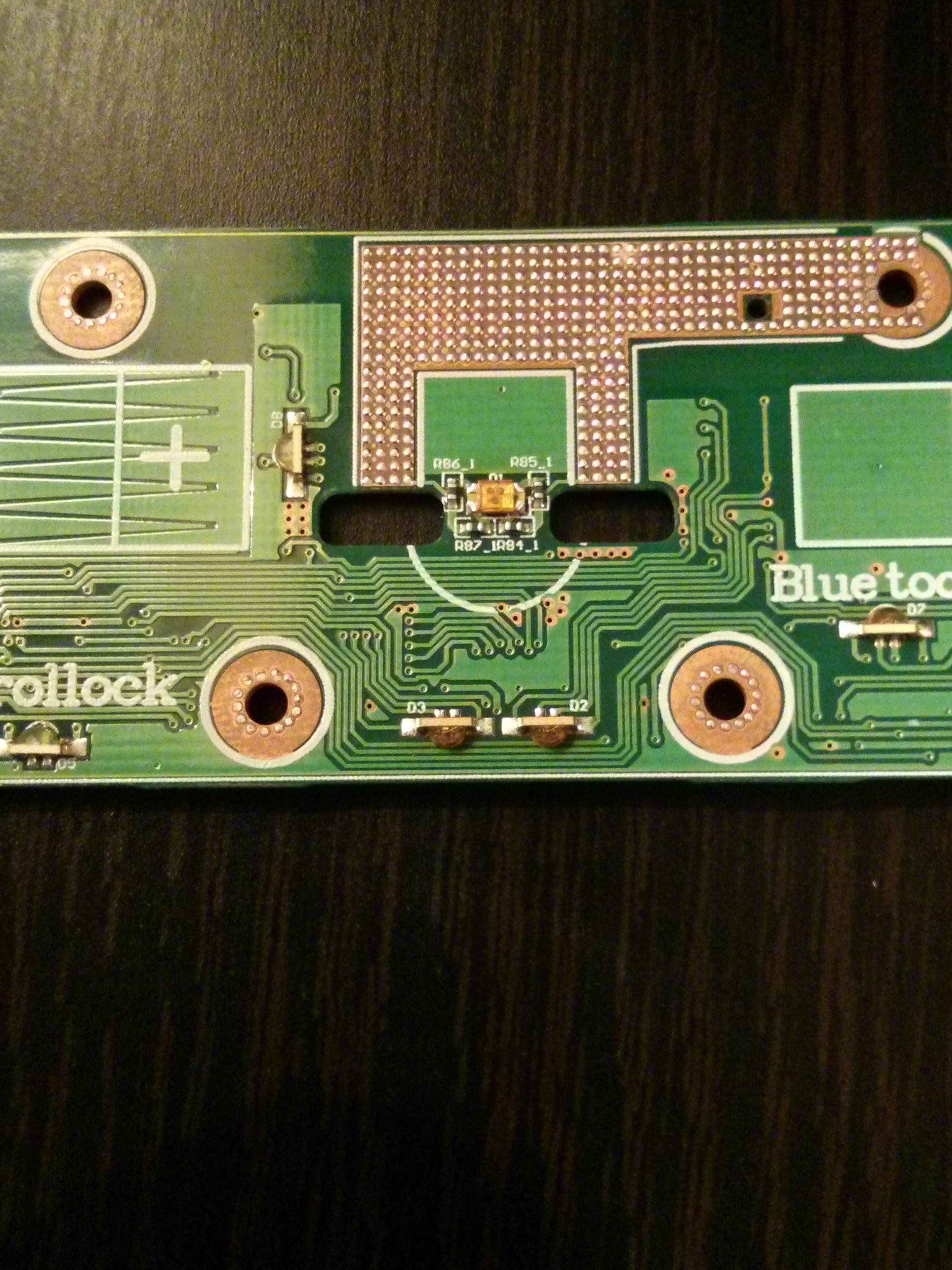

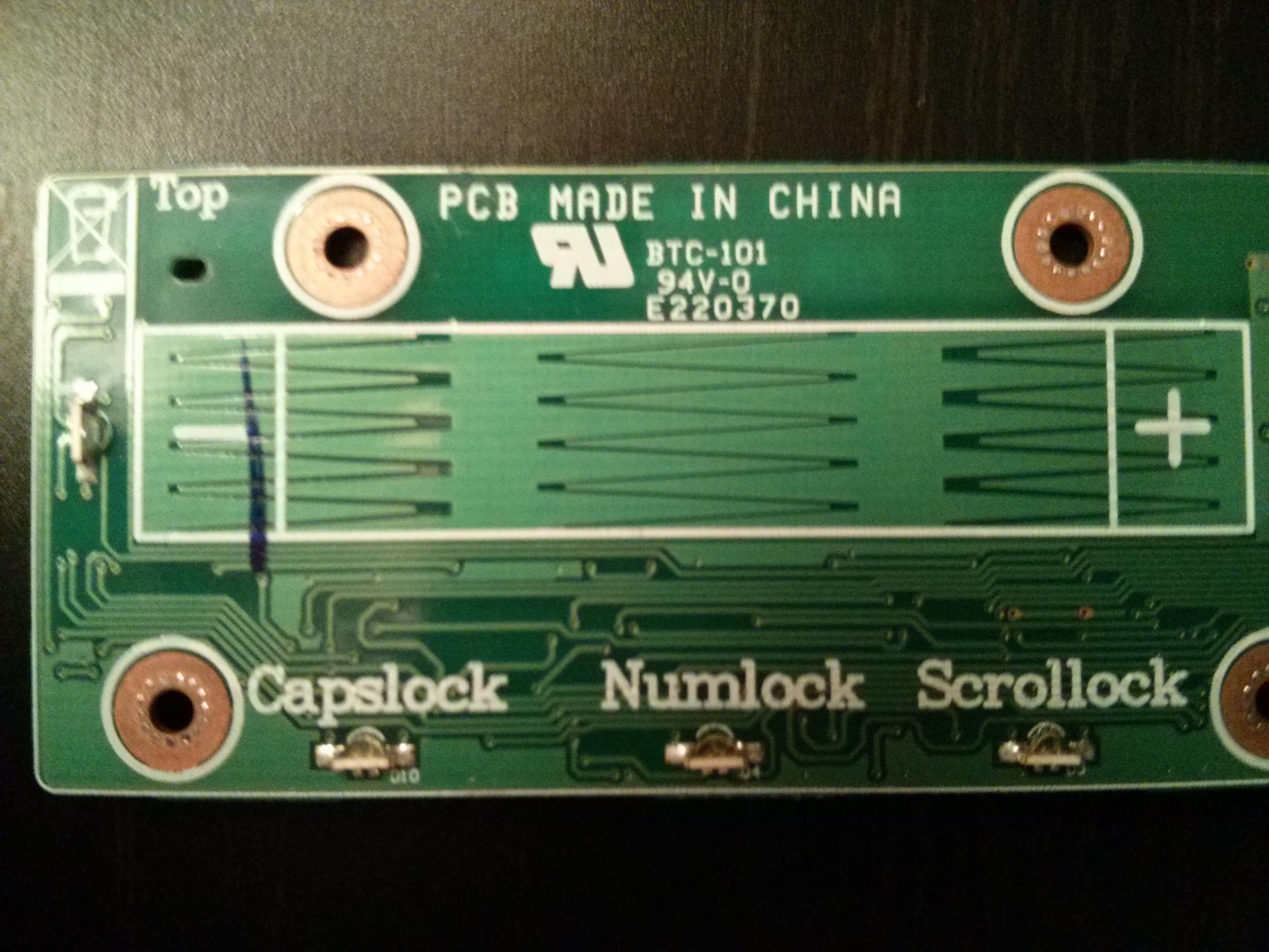

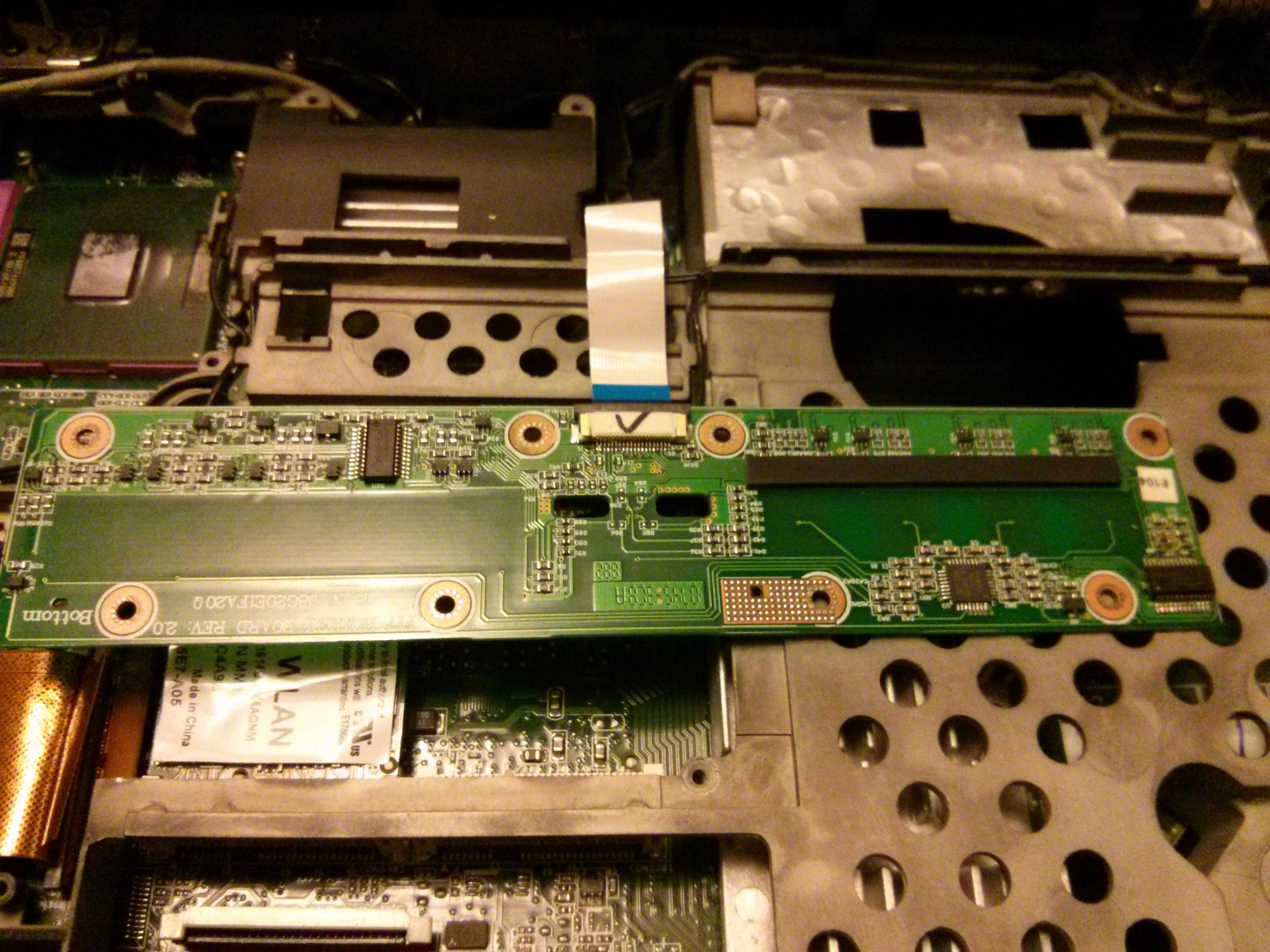

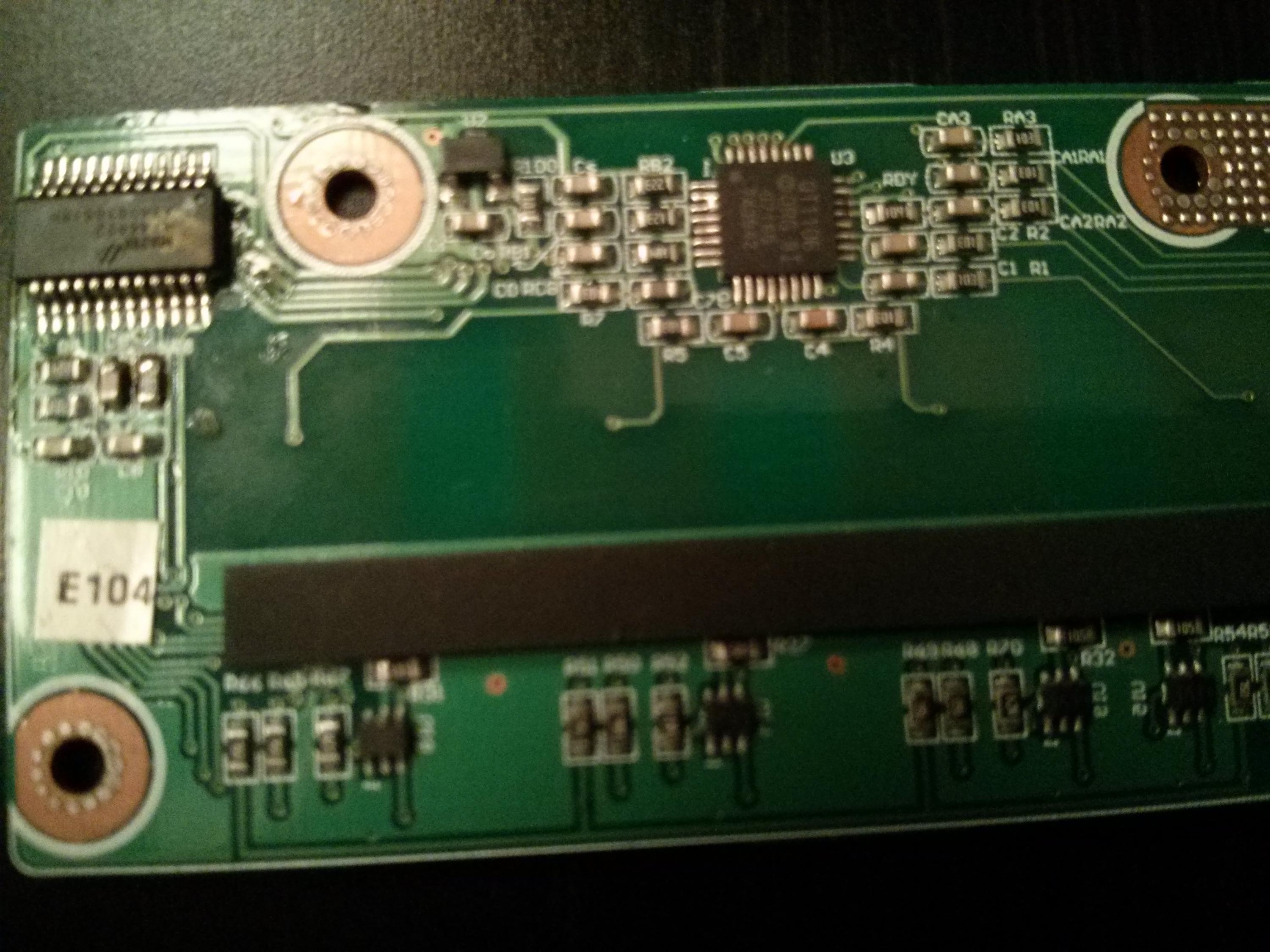

                      • DJ4D
                        • Nov 2013
                        • 44

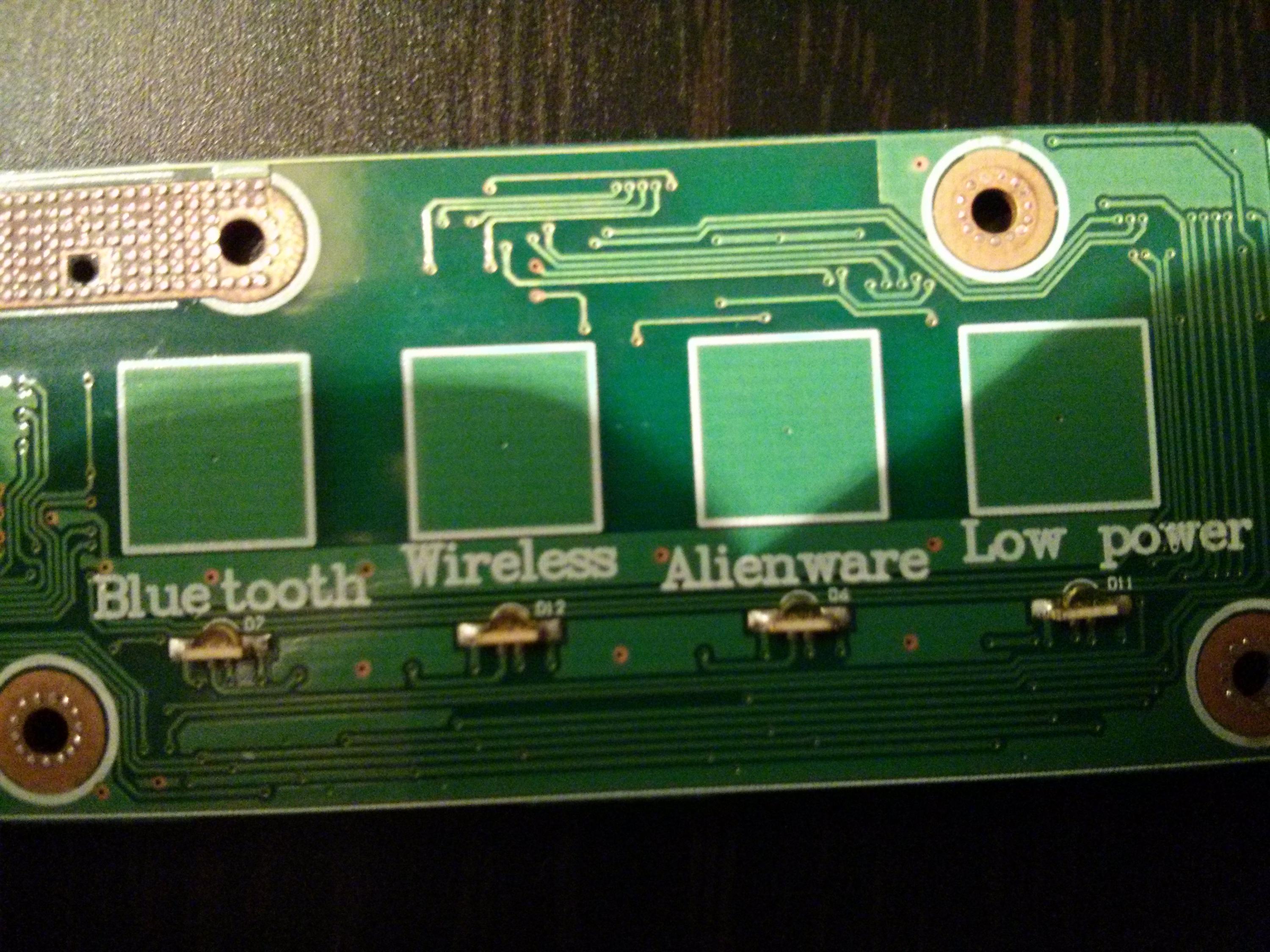

                        These are the best two photos I have of the power button. There is normally a plastic alien head button that goes over the point in the middle. Specifically its the cluster of components and an LED in the middle, just above the white semi circle in the middle of the two holes.
                        I can't remember fully which LED it was when this was working, possibly the LED marked 'Alienware' in the third pic which lights up when the charger is connected to signify that the machine has power. Alas, it doesn't light up at the moment.
                          probe here with the dmm (on the connector)
                          just be careful
                          i was searching on ebay and everybody its selling dj jacks like this : http://i.ebayimg.com/t/DC-Power-Jack-PLUG-IN-PORT-CONECTOR-SOCKET-FOR-ALIENWARE-M17X-R1-M17X-R2-/00/s/NjAwWDYwMA==/z/uq4AAOxyB0VRvo26/$(KGrHqZ,!nwFG1PiWj9YBRvo26N8Lw~~60_35.JPG
                          why its yours with wires?
                              So you want me to probe each point where the white connector is on the photo of the board you posted [I think it's called the 'Hotkey board'? Just probe the different points 2 at a time?
                              Should I do it with the charger connected to the motherboard, ribbon cable between the motherboard and the Hotkey Board connected?
                              The DC jack you linked to looks like it's for a different motherboard, one where the DC jack is soldered straight onto the board.
                              Mine is more like this - http://www.laptopinventory.com/Model...DC%20Jack/4131 - except mine has 5 Red and 5 Black wires going into the white connector which plugs into the motherboard.
                                yes!
                                probe around the power button .
                                put something under so t won`t touch
                                Black probe on a screw(from the mobo) and red pok around on pins and sensor
                                draw on a picture where and how much
                                • DJ4D
                                  • Nov 2013
                                  • 44
                                  Nothing at all unfortunately. Nothing around the power sensor, the LED or anywhere else on the board for that matter.
                                    not even on that connector?
                                    power button connector
                                    • DJ4D
                                      • Nov 2013
                                      • 44
                                      Nothing on either the connector on the board, or on or around the power button. None of the micro components on the board either.
                                      I checked the connector other end of the ribbon cable where it connects to the motherboard. Some of the pins on the edge of the connector show about 1.3v.
