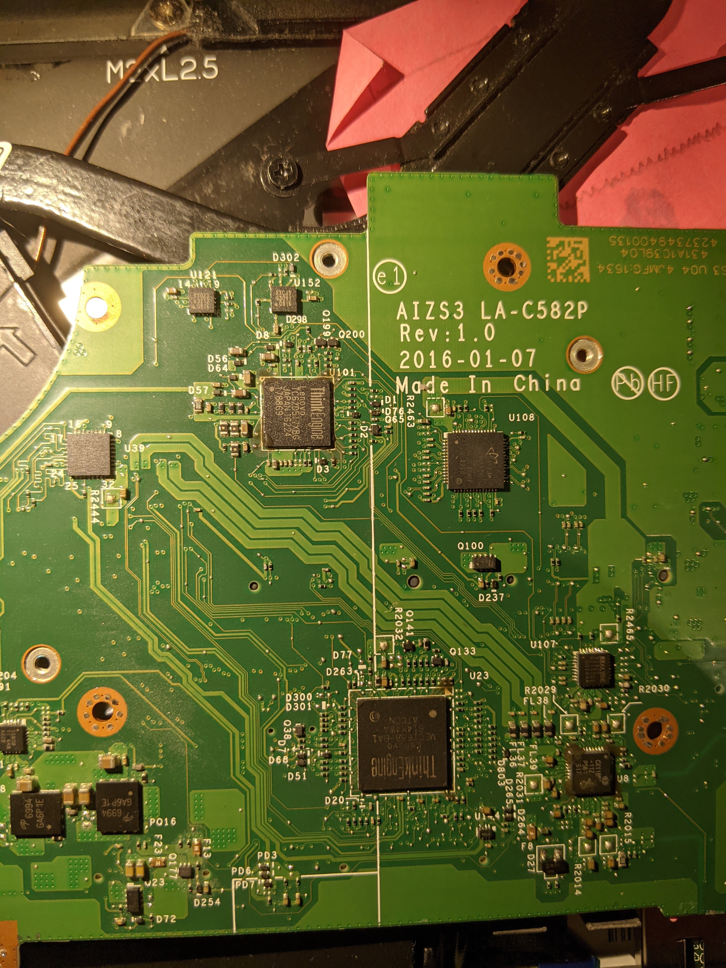

    la-c582p blown transistor

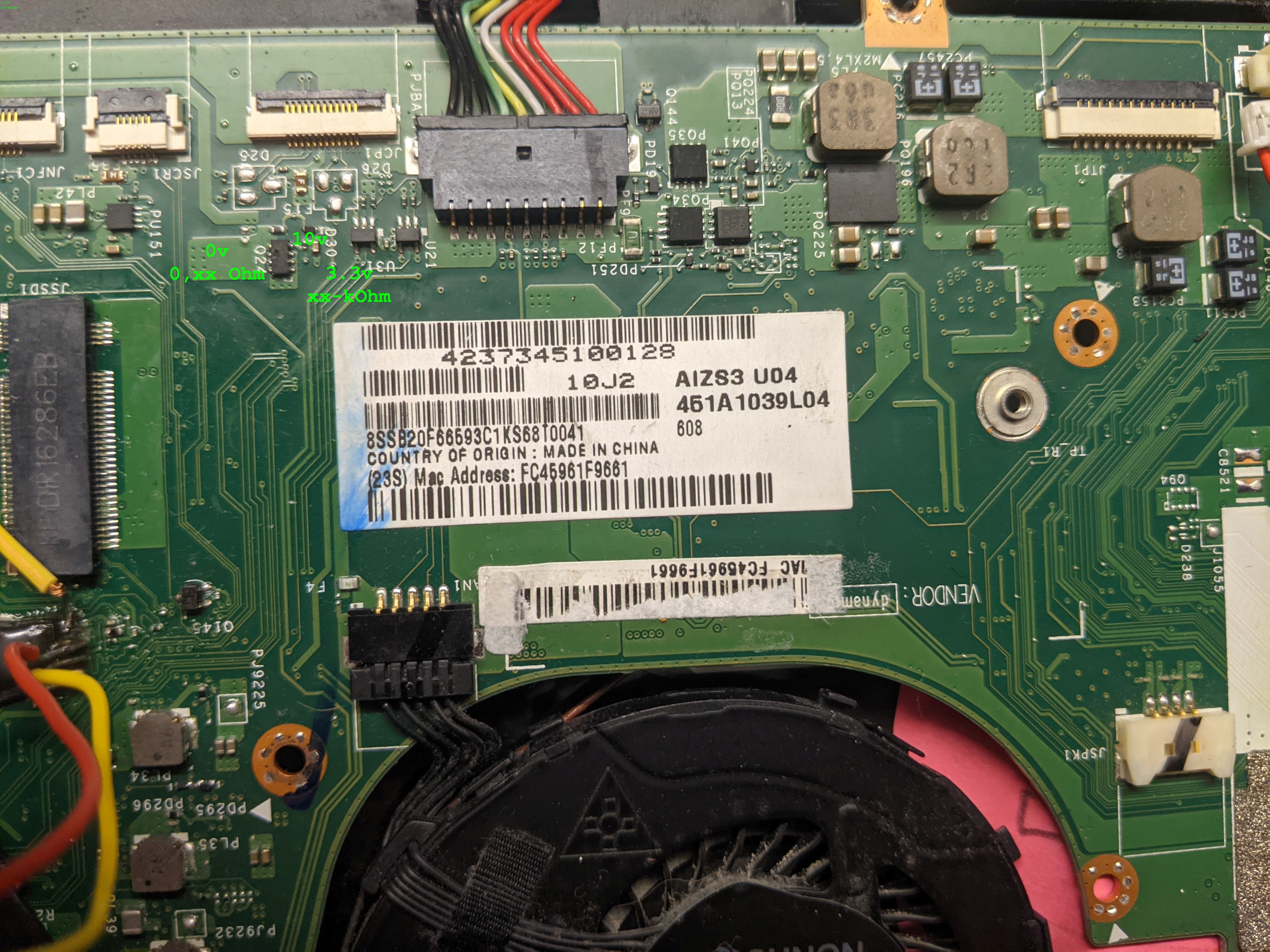

    I found a blown transistor (q24) in the picture. I replaced it, and it blew again 🤔
    If I measure the Voltage while turned on without the transistor on the pads, it is 10V, 3.3V, 0V The resistance if turned on: High, High, 0.
    Anny idea how I could proceed?

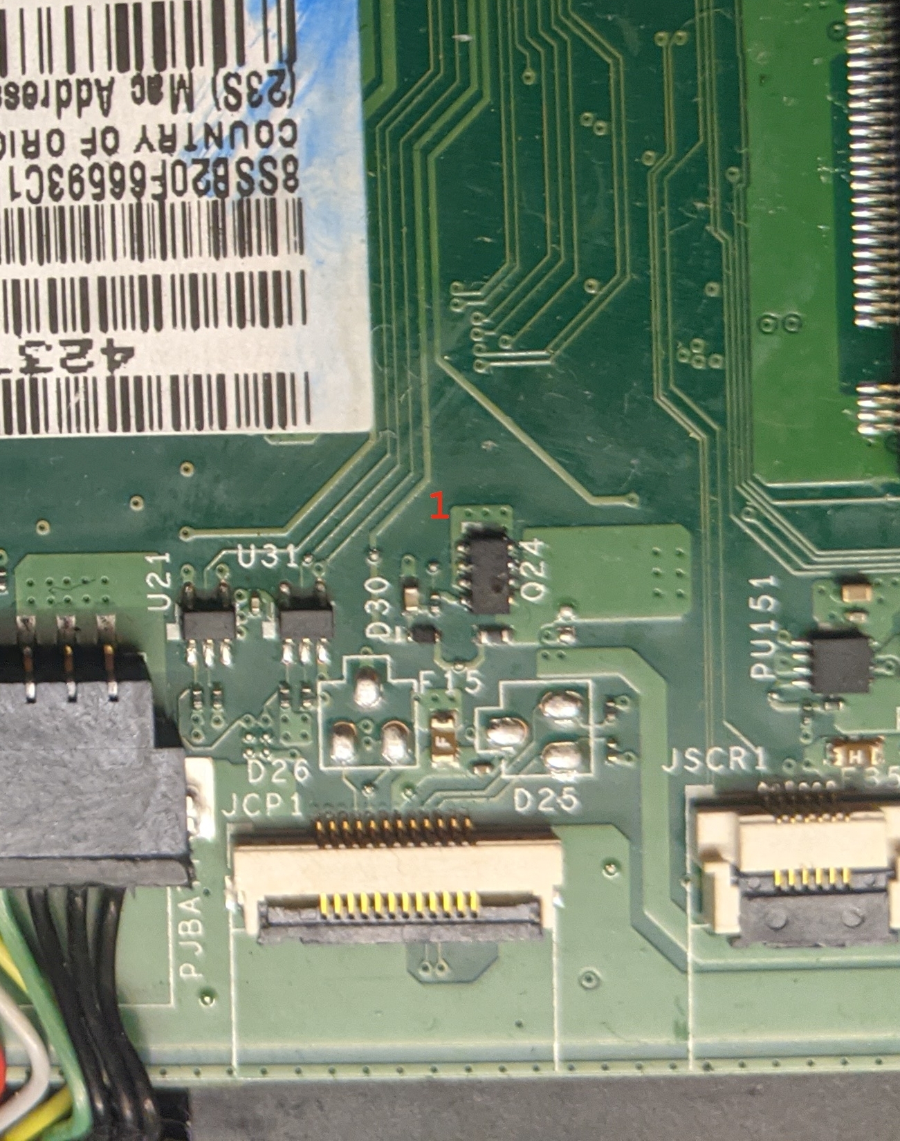

      Resistance with power off:
      5 MOhm, 55 KOhm, 0,2ohm.
      The part is supersmall but As far as I can read on a similar looking one on the other side its F28 (Picture attatched)
      Pin 1 is marked in another picture.
      Thanks in advance
      Mawa

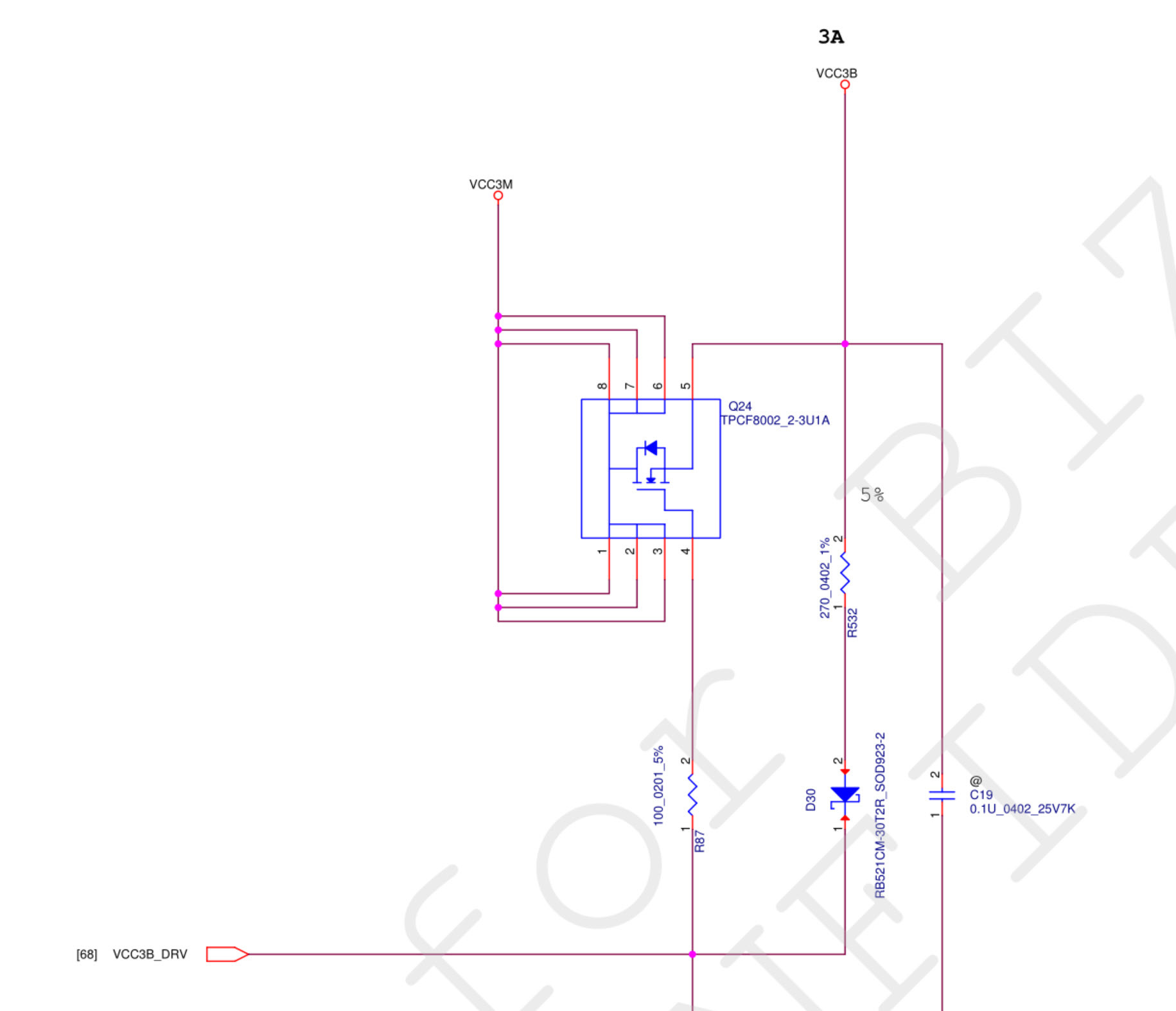

        From the LA-C581P schematic, Q24 = TPCF8002. There is a polarity to the component so be 100% the replacement is aligned in the same orientation as the original. Part should be inexpensive so do order some spares and test again.
        Q24 = TPCF8002
        reference:
        TPCF8002 N Channel MOS 30V 7A SOT23-8 MARKING F2B Low drain-source ON resistance Low leakage current|Welcome to Eric Online Store - Shenzhen ERIC Electronics Co., Ltd. (eric1688.com)
        Tpcf8002 Printing F:2b F28 F2b Sot23-8 - Contactors - AliExpress​
        Datasheet is attached.
        Click image for larger version  Name:	Q24_LAC581P.jpg Views:	0 Size:	122.6 KB ID:	3167232

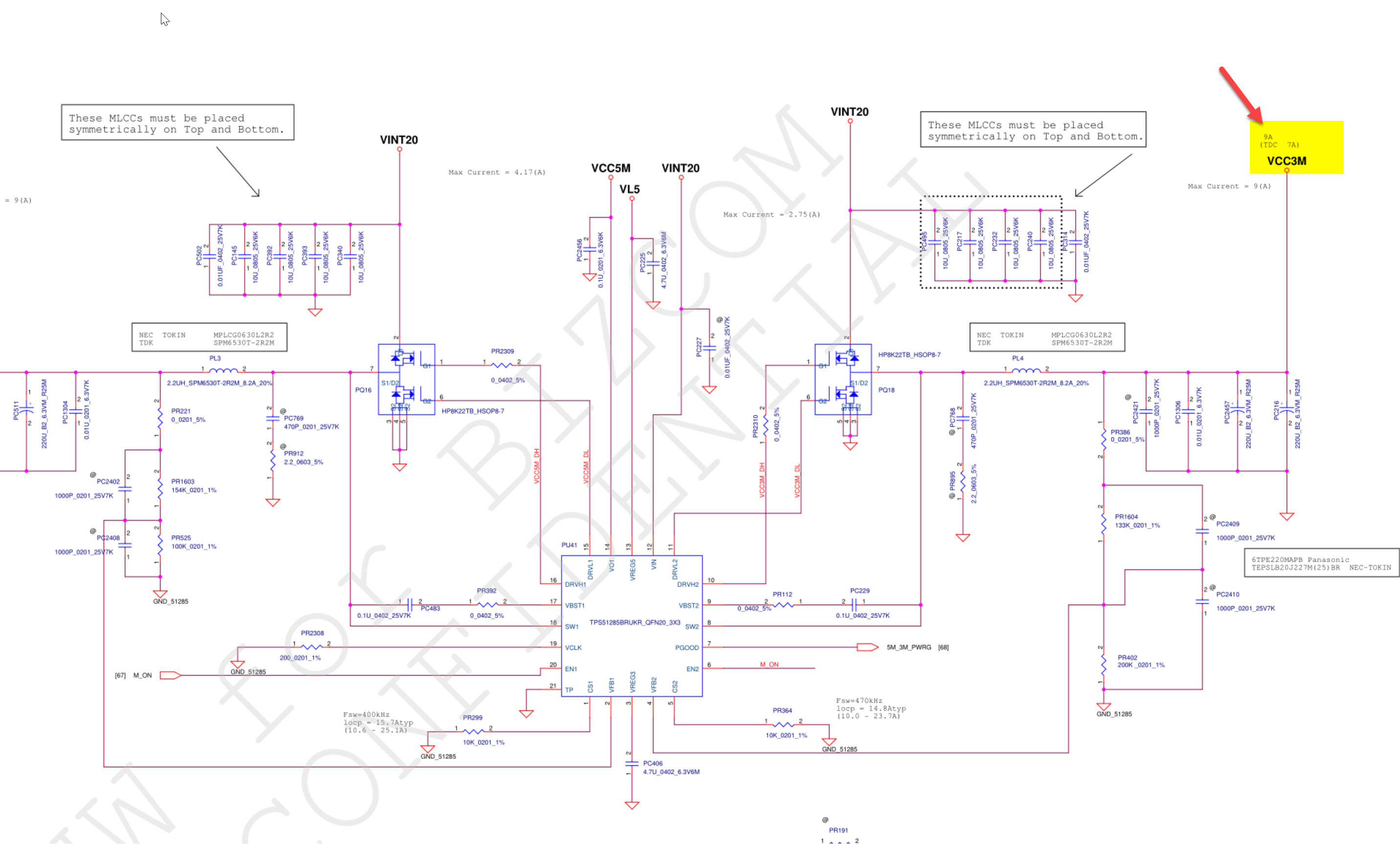

            Suspecting that you have an excessive loading condition on VCC3B which is causing this mosfet to burn out.
            Remove all power -> meter in resistance mode -> measure the resistance to ground of VCC3B. Perhaps a good idea to flux and carefully remove this now defective mosfet out of the circuit before you make the resistance measurement.
            Will post the source of this switched power rail in a sec from the other similar board schematic. In summary, this mosfet is acting like a solid state relay to power the downstream rail of VCC3B ON / OFF. When it is ON, the load is too much and burns out this part.
            VCC3M = power rail producer.
            VCC3B = power rail consumer.
            Click image for larger version  Name:	vcc3m.jpg Views:	0 Size:	456.4 KB ID:	3167276

              EDIT: I mixed the readings between working and broken😣
              Okay,
              on the broken board, that I need to run once again:
              between Pin 5 and GND we have 0,3Ohm
              between Pin 4 and GND 8,45KOhm
              between Pins 123678 and Pin 4 10k (rising)
              between Pins 123678 and Pin 5 440Ohm /Reversed Polarity: 500k

              Could c19 be broken? And how can I identify "Cs" there is no writing on the silkscrenn.

                Is it possible that the readings are reversed from the good to the bad part?
                pin #5 to ground are the measurements of interest.
                if a low resistance = heavier load = burning out this mosfet.
