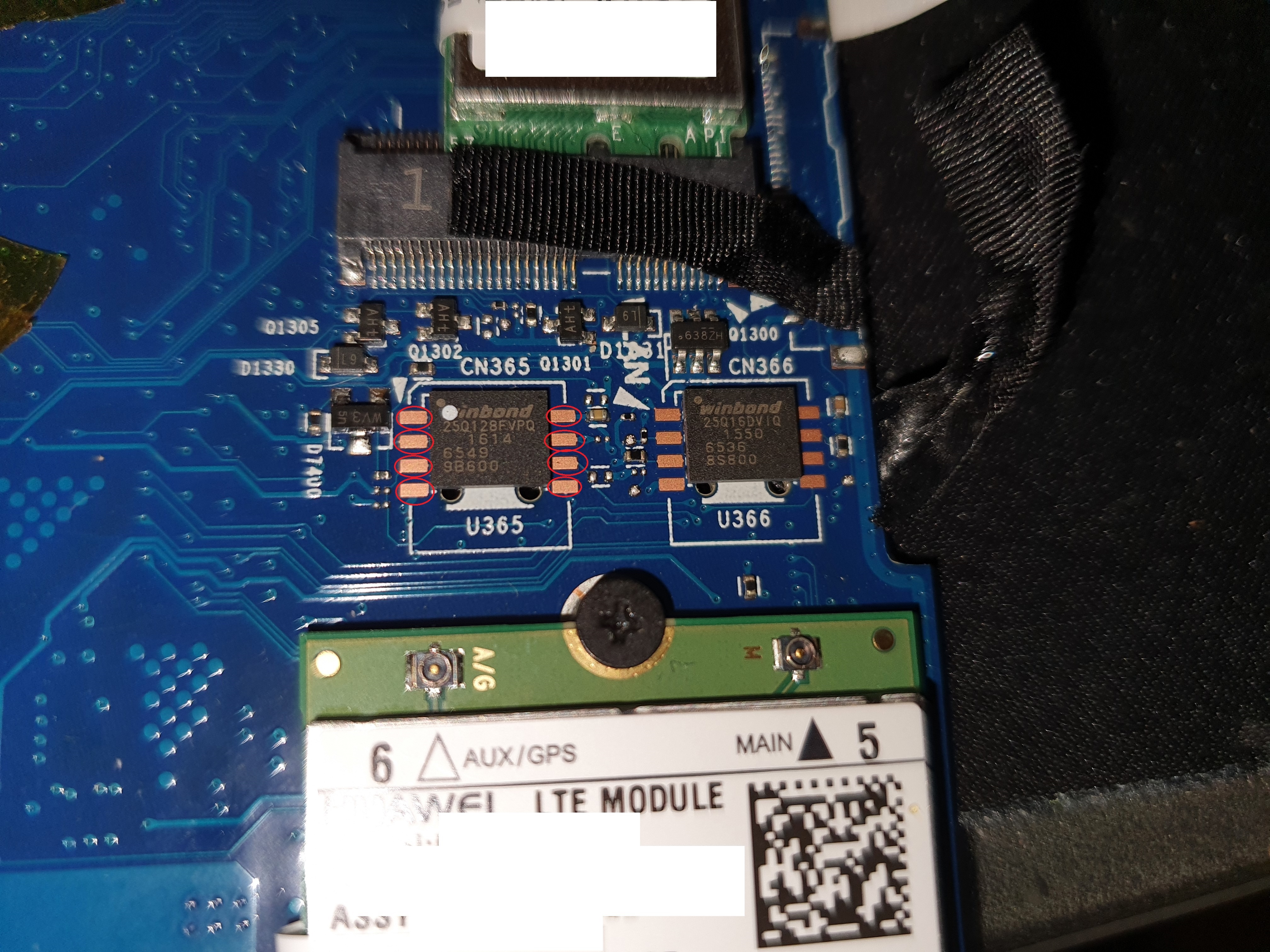

    Dear Badcaps, i got a HP PRO X2 612 G1 with a BIOS password. Im pretty new to the whole BIOS flashing game but i was able to flash a HP Probook 2 weeks ago with help of this forum.
    Now with the HP PRO X2 612 G1 i have the problem that im not 100% sure if i got the right IC and if i am doing everything right in terms of reading it.
    I use the CH341A to read the BIOS. The Chip i try to flash got "771AW G GBA 609B" writen on it. I tried with the 25xxx and the 24xxx slot but i dont get a read from AsProgrammer :/
    I solderd it out and put it on the 25xxx frame that came with the CH341A(visible in the picture i attached)
    Anybody got some help or some idea?
    Should i just try it with linux and flashrom? I only tried it with windows yet...

    Nah. Try looking under some black tape.

      Maybe those? Winbound were making BIOS Chips right? But then, which of those should i read out?

        First things first:
        The first IC you tried is definitely not the BIOS chip, but most likely a temperature or voltage monitoring ICs
        BIOS-(Flash-)Chips can be identified by their marking starting with 25... (or in some cases 24 ...).
        Note that 24...-Type ICs will have 16 pins, so you need the bigger area on your programmer, but 99% of the times, you will encounter 25...-Type chips.
        So as you can now see, the two chips you found (U365 and U366) are indeed 25-Type flash ICs. So you're on the right track.
        The next number in the marking (25Q128 and 25Q16) indicated the size of the flash in MBits. So 128MBits = 16 MB, 16 MBits = 2 MB.
        So from that, we can be sure, the first one with 16 MB is the actual BIOS chip.
        I can't say for sure, what the 2nd one is, but you definitely want to start with the first one.

          Incorrect. 24 series is I2C and usually 8 pin and not used as bios chips but may sometimes be used on laptops for other purposes.
          25 series is SPI and they usually are 8 pin (soic8 and wson8) but can also be 16 pin (soic16) like on some older HP laptops.
          Otherwise, yes. Larger capacity is main bios and smaller capacity is EC bios. You need to modify main bios.

              25Q128 will be your BIOS. The other is likely USB-C ROM or something like that.

                As I said, the 16 in 25Q16 denotes this is the smaller chip with just 2 MB, so NOT this BIOS chip.
                Go for the 25Q128, this is your 16 MB BIOS chip ...
