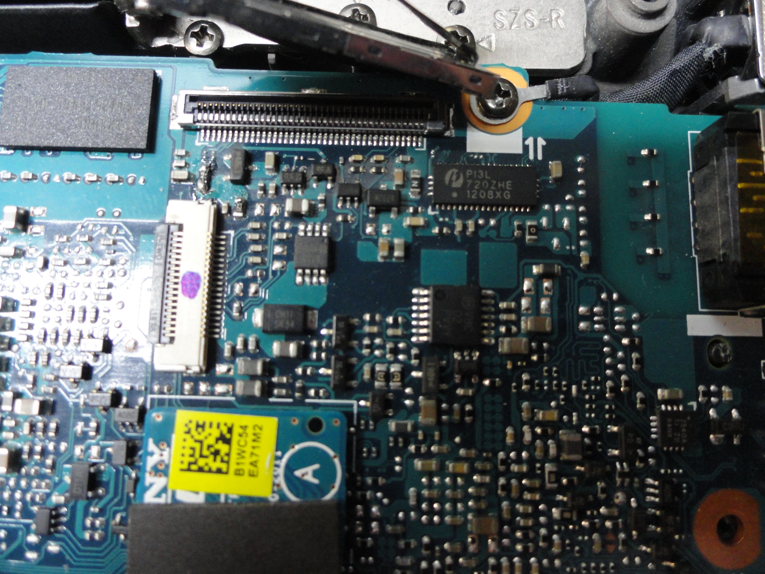

    This one doesn't have picture on the lcd screen. With external monitor works perfectly. Fuses are OK and the cable seems OK too. The mainboard is MBX-259. Is it possible that the schematic diagram will be found?

        Nope there is no picture at all (like you haven't connected the panel). There is a missing voltage 3.3V on the connector and I wanted to trace it..

          check if there is any small 5 or 6 pin ic around which switches the 3.3volts maybe it is damaged which can happen when you put the connector on the board while the machine is on.

            Please check the photo. I think that without its schematic diagram I can't do anything right not. I have searched for it with no result.

              i see a jump wire!
              why you use it?
              it was a fuse?

                You got me there Yes that one was off but nothing changed.

                    Thank you for your reply. The problem is not from the gpu. On older models the same thing happened to me once but on this one as I have previously said 3.3v don`t exist on the connector for the panel. Also after bridging that fuse picture on the panel came but after 10 minutes it disappeared. Can anyone provide me with the part number of those two 5 and 6 pins ics that are there please?
                      Re: Sony vaio SVS13A1S9ES no picture
                      It blows the new fuse, so it means that the T-CON on the panel is drawing too much current due to bad components on the T-CON board.

                        Thanks for your reply. I am measuring on the mainboard side of the lvds connector with the panel disconnected so I guess the panel is OK. Also the fuse on the panel is OK..

                            what is this 3.3v for ? did you check the voltage without plugging the connector ? try separating that pin from the connector and apply 3.3v externally(or from the mobo) and see if it worked.
