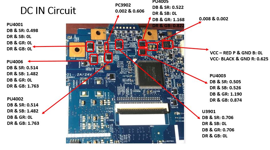

      Hi same with me I have the same issue and as per my checking the schematic is different with the actual board layout.
      What could be wrong here I already checked using diode mode and it seems there is no 19v at DCbout.
      Please help me

        Originally posted by Francisco.s
        Re: No power, Sony vaio
        Resistance looks good, but you can check its value with ohmmeter. (2.2 ohms)
        This voltage is wrong, check voltage of pin 14 (S5_ENABLE) ic U2701A, (NPCE795P) if low, could be bios data corruption, or NPCE795p with leakage problem.
