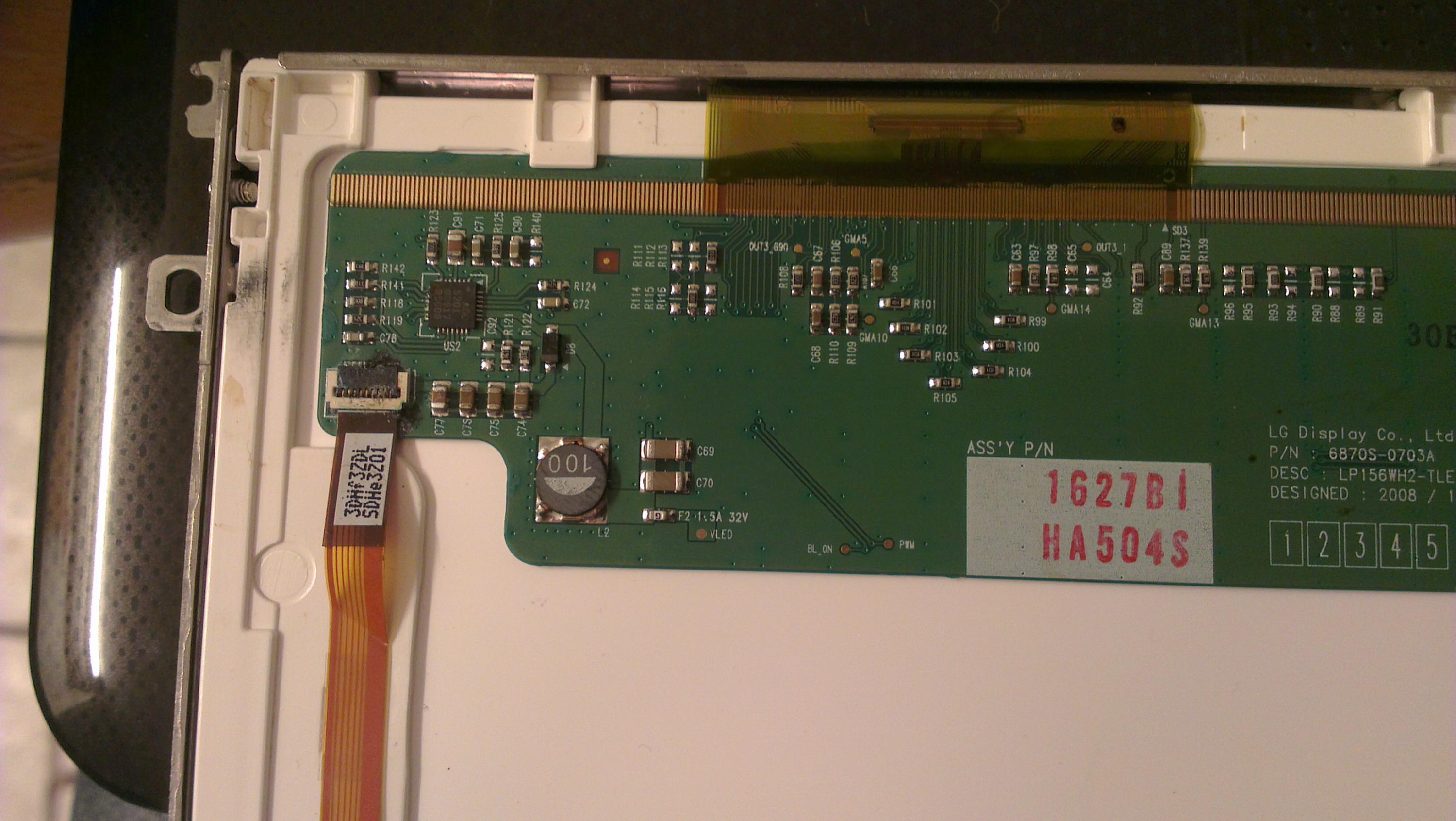

    Hello. My friend gave his broken laptop to me and now I want to fix it.
    It is an ASUS K50IJ and the led is LG lp156wh2 There is no backligt when starting the laptop but I see picture when using a flashlight. I have taken out the led and I saw a kind of burned connector. I have cleaned the cable and connector and it looks really good, but still no picture. I have measured 2 fuses on the ledboard and the were ok. The question is, why the burned connector, what is the problem now and if I buy a replecement led (about 60$) will that fix the problem or can it be a problem on the motherboard??
    Best regards Nalle077

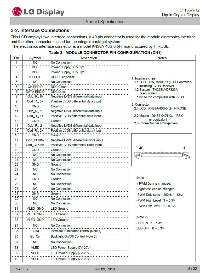

        Re: ASUS K50IJ with lp156wh2 no backlight in led
        Originally posted by nalle077
        Thanks for the reply. I have no electrical scheme for the led, so I do not know what the voltage should be. I have looked but can not find a scheme for that led. Help Please
        I have found a schematic for the led but it only shows the 40 pin connector.
        I have measured number 38-40 with output about 10,7V and number 36 with about 3,8V. seems ok I think. I think the problem is the little connector that I wrote about earlier. the one in the corner of the picture. I have no schematic about that connector. I measured just to see there were any power there, and got 10,7V on one of the "pins" it is hard to say if anything is "in the wire" because it has plastic over it. But that was my thought if it has bad connection after it got "burned" even if I have cleaned everything.
          Anyone who can help me ?
            on the LCD board you have GND, put black probe on that and red probe on that burned connector pin. (laptop must be turned on ofc ) post the result.
              Thanks for the reply. As you see in the first picture in the thread the whole connector was some kind of burned. I think it is about 7 pins in that connector. I have as I wrote earlier measured over the connector an found 1 pin giving about 10,7V. Should I use some kind of needle to stick it in the plastic to see if the power comes through the cable ? Best regards

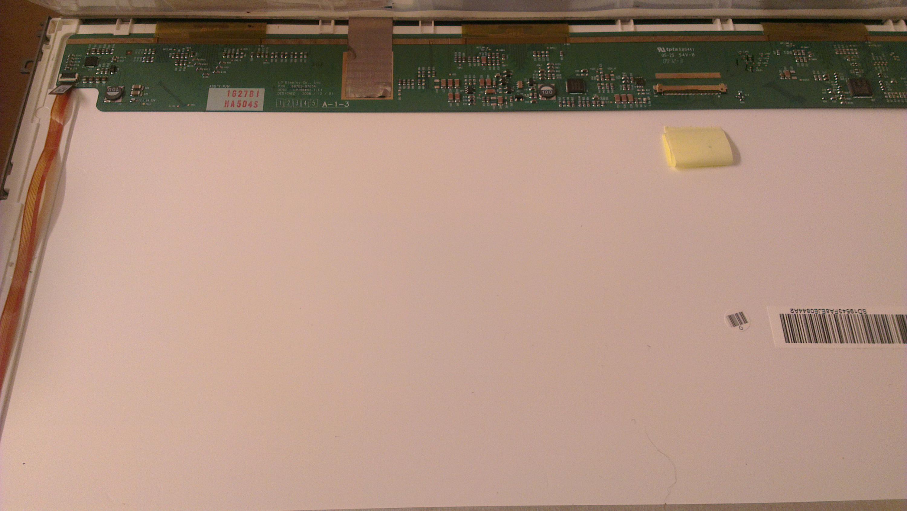

                          Ok how do I connect that? And is it a standard connector for the lcd/led on the motherboard?
                          Is there anybody who can help? Is the small cable on the side in the picture the one for the backlight? anyone with knowlegde of this?
                          Best regards
                          • rtstorm
                            • Feb 2012
                            • 971
                            • Croatia
                            yes this is the backlight cable, if you want to test with the normaly LCD (not LED) you must have the same connector on that display (that include flex cable with invertor) or you can but this from ebay

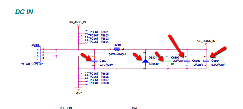

                                      Ok I have taken out mainboard but I guess I need the chematic for the board to find these components. The only thing I find on the board is J6801 that is written on the board. Can anyone help me with a scheme for the mainboard.
                                      K50IJ main board rev. 2.1
                                      EDIT: I found board, but I am not so experienced with how to see the same in schemetic of board on actual mainboard. Anyone with a photo who can point where these components are?
                                      • rtstorm
                                        • Feb 2012
                                        • 971
                                        • Croatia
                                        Here is the schematic, please take good photo of that part on motherboard (where is DC jack)
