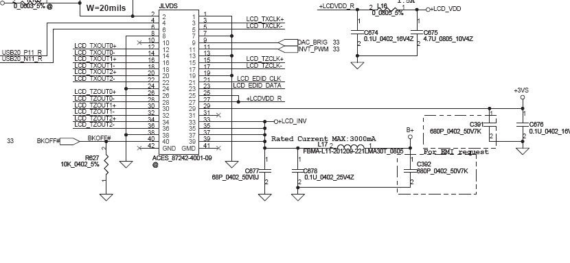

                  Re: Toshiba Satellite LED screen no backlight
                  acording to pdf file you posted :
                  31 GND LCM Ground (LED Backlight Ground)
                  32 GND LCM Ground (LED Backlight Ground)
                  33 GND LCM Ground (LED Backlight Ground)
                  34 NC No Connection.
                  35 PWM System PWM Signal input for dimming
                  36 LED_EN LED Backlight On/Off
                  37 NC No Connection
                  38 VLED LED Backlight Power (7V-21V)
                  39 VLED LED Backlight Power (7V-21V)
                  40 VLED LED Backlight Power (7V-21V)

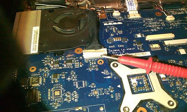

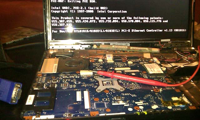

                          Hi, I just wanted to say: thank you. This thread set me off in the right way. And I just got an LCD panel backlight back to life in a mysterious way. I hope to share my experience here.
                          First, thanks for this thread. I have a faulty Toshiba L500-128 with la-4981p mother board that has no backlight after a water damage incident (glass of drinking water). Ordered a new inverter, still nothing.
                          I've measured +3.3v on pin 40 (BKOFF), +19 on 33-35-37-39, 0v on 9 (DAC_BRIG), but only 0.1v on pin 11 (INVT_PWM). Now I read somewhere (please correct me if wrong) that DAC_BRIG can be zero, but INVT_PWM should be between 3.0v-3.6v (analog reading of PWM signal).
                          OK, well the laptop is already a write-off. So I shortcut BKOFF and DAC_BRIG to get +3.3v on INVT_PWM, to have at least some sort of 50% brightness, which is better than no backlight at all. This worked to expectations.
                          Now comes the weird part. While probing I actually touched this INVT_PWM quite some times with the +3.3v from BKOFF, and at some point it just stayed on all by itself (!?). My plans to solder them was not necessary.
                          My theory here is that -maybe, just maybe- , the chip that sends the INVT_PWM needed a little help "starting up", or getting "unstuck" after the short circuit of the water damage.
                          Allright. Some pictures included. Thanks again.
                          Laptop is up for an hour so far and still works.
