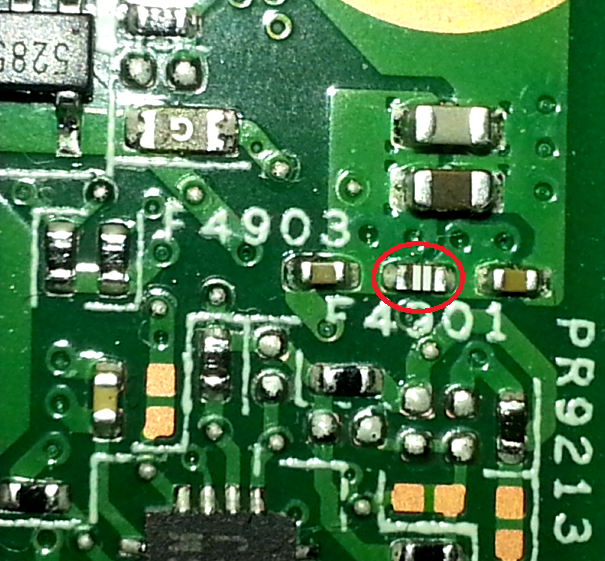

    I'm attempting to repair my Lenovo E520 laptop. It suffered a small fall, which shattered the LCD. I've managed to replace this, however the backlight isn't working. Annoyingly its not just a bad screen, seems like a mainboard issue.
    After a bit of digging, looks like there are two fuses on the board that may have failed. I'm looking to swap or short these out. Found some info on this polish forum.
    http://www.elvikom.pl/forum/viewtopi...839&view=print
    I found markings for the fuses in question (F4901 & F4903), however I'm not certain which SMD are the fuses. See this pic (sorry cant seem to embed it):
    https://www.dropbox.com/s/ijl7h52l60...2-15-14-41.png
    Could anyone offer any help identifying the fuses?

    fuse above "f4" of f4903
    and other fuse above "90" of f4901, in your picture

      Thanks. I've just tested F4903 (above "F4") and that seems intact with continuity. F4901 appears to be the problem, I will treat this to a blob of solder sometime tomorrow. Wish I could replace it, but I simply don't have the equipment and its just so tiny....
      I will give it a go and report back.
      Thanks again.

        Thanks again trebo, I removed the blown fuse and soldered in a small length of jumper wire. It was a bit of a battle, due to the size of the fuse and my relatively huge soldering iron tip (maybe time to spend some £££) but managed it in the end.
        Now I'm glad to report the laptop is working once again.

          it work for me too it was fuse above F4901 the middle one just jumper with wire don't have to remove just jumper it.

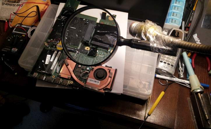

            wainy54, trebo & usman1972, you saved me! I was at my wit's end.

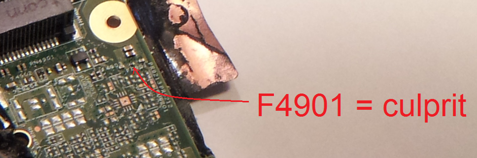

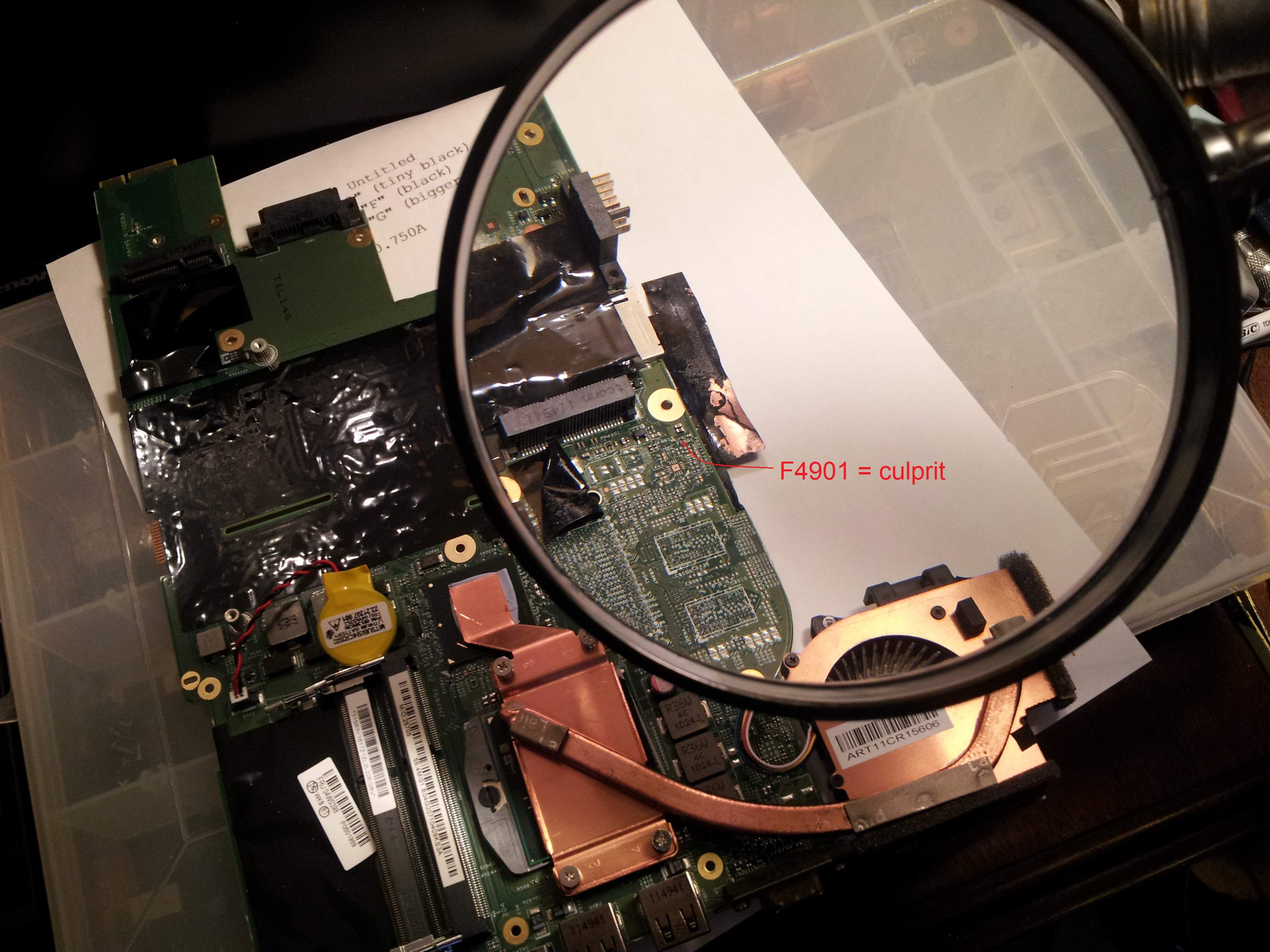

            The culprit on mine was F4901, too. Unlike yours, mine was marked with a tiny "3" which could be read with a jeweler's lupe. (The other two fuses, F4902 & F4903, were marked F and G, and were not as tiny.)
            I think that's the tiniest thing I've ever successfully soldered. Wow, that was hard.
            This is my magnifying glass kludge (my biggest magnifying glass lashed to a gooseneck lamp to hold it in place):

            Here's a closeup of the F4901 (culprit) fuse location:

            Here's the full-sized photo of the F4901 fuse location:
            http://www.geeksalive.com/Lenovo_E52...ad_culprit.jpg
