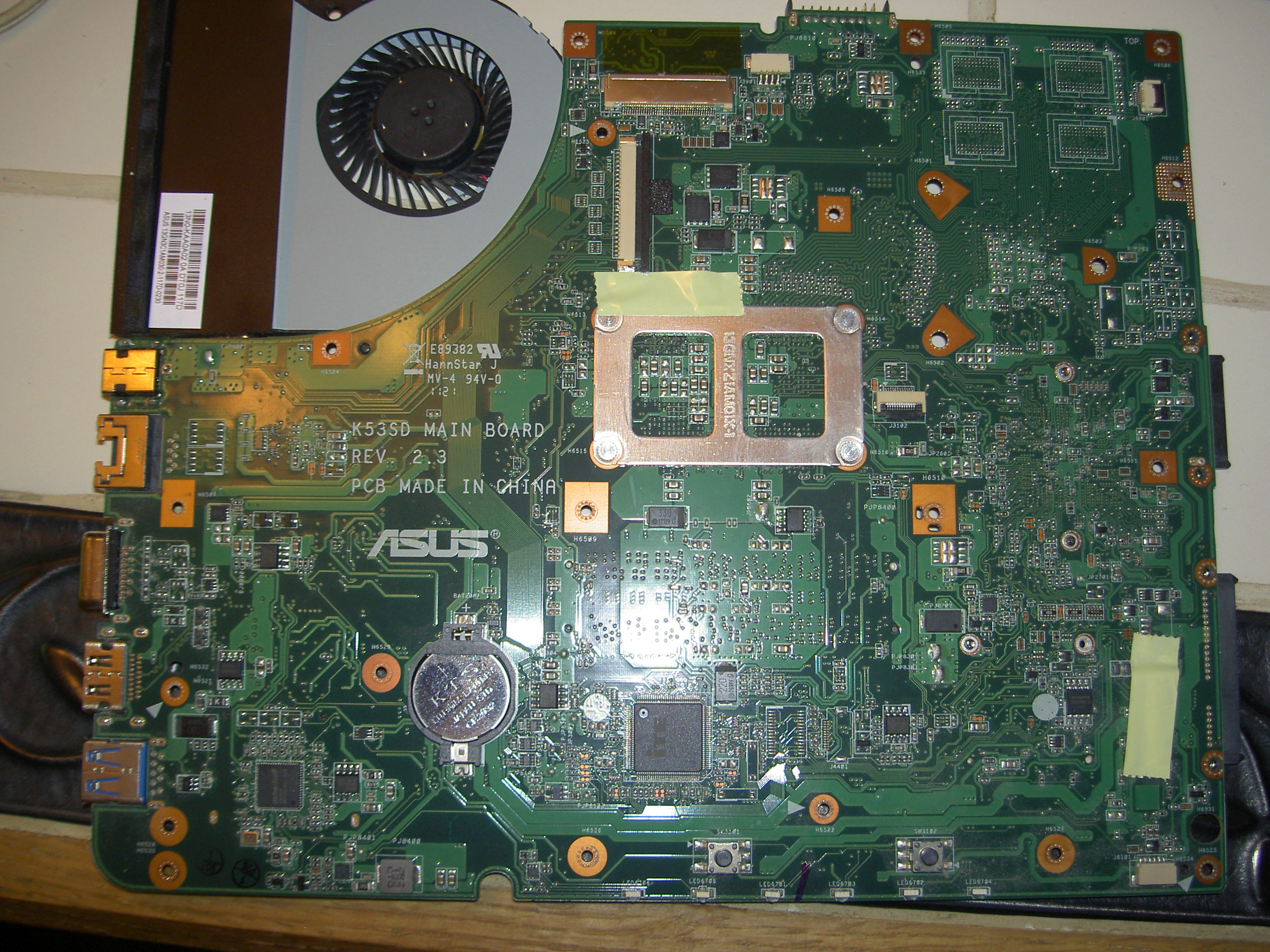

    Laptop was having issues with the DC Jack, so I desoldered it and installed a new one, then screen started to display everything in green film grain, then it stopped displaying anything at all in the screen, but everything was working fine through HDMI/VGA.
    Ordered another screen through Amazon and the same green thing appears, now I'm afraid it's killing the LED screens.
    The white light is the camera's flash.

        Re: Asus K53E is destroying my LED screens
        I just did a complete teardown of this same system for the same reason........bad dc jack. I did not remove the entire jack.....just resoldered the center leg, it had cracked right where it coms out of the jack and curves down into the motherboard.
        Found the fault by turning the lights off, and in a dimmely lit room I plugged the power brick in and saw a blue arch jump the gap....... a little flux, a little heat, a little solder, as good as new.
        As far as the green screen, check your solder connections on that new jack...one of the legs should be flowed onto another connection, for ground I believe.......If looking at the laptop......the dc jack is to the left....you have four legs on the dc jack, one on each corner..........the one on the upper left corner is the one that should flow onto that ground.
        Or when you plugged in the screen cable on the mobo you caught some of the tape that holds it down. Good luck.
        Regards.
        Edit: The one I did was in fact a K53SD.......Not sure if it is the same mobo.

          • raptor49
            • May 2013
            • 14
            Yes, the joint indeed attaches to the LAN ground.
            I did take pictures, but no close ups sorry.
            Here is a pic of the mobo.
            This board is very thin so it flex's badly, especially around the dc jack.
            Regards
                Also to make sure, which leg are we talking about?
                Red or yellow?
