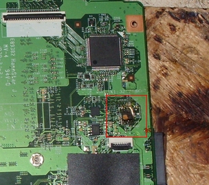

                EC flash on LA56 MB is U13, PMC Pm25LD010. Near the DVD drive connector and to the lower right of the Nuvoton EC. It may be marked with a dot of paint which obscures the model number, hence why you weren't able to spot it. Edit: See here: http://www.wimsbios.com/forum/topic13739.html
                  Unfortunately, I haven't this laptop now. (it's being with me for repair for too long, trying to locate the schematic with any luck)
                  But I really appreciate your help.
                  I saw the pictures, and the motherboard are a little different. (I'm not sure if my motherboard has U13 in that position)
                  In case it returns back, I will check, and reprogram it. Will post the results.
