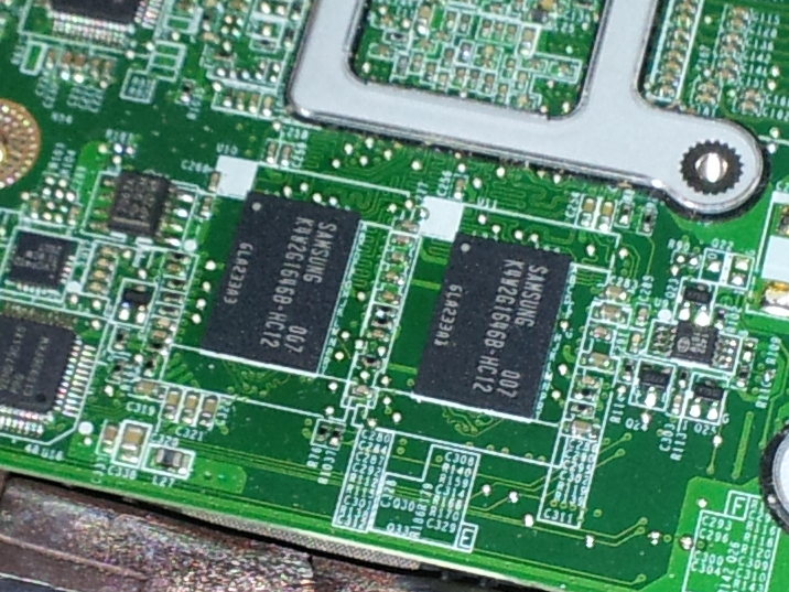

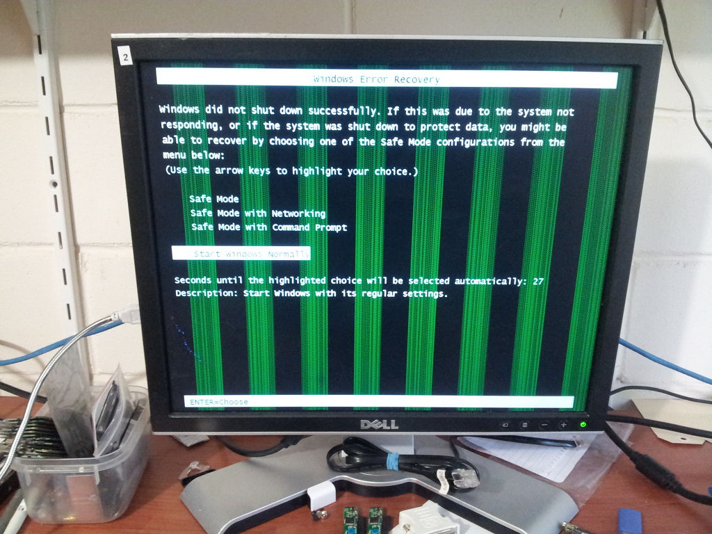

    I've got a client Dell Studio 1558 which has been dropped in the past and repaired, but now the screen is completely mangled up, won't even show on the LCD, but does on the external display.
    I suspect the graphics ram has a fault.
    Anyone dealt with this before?
    It won't boot properly either ( that's no problem, I'll get the data off via a Linux boot ).

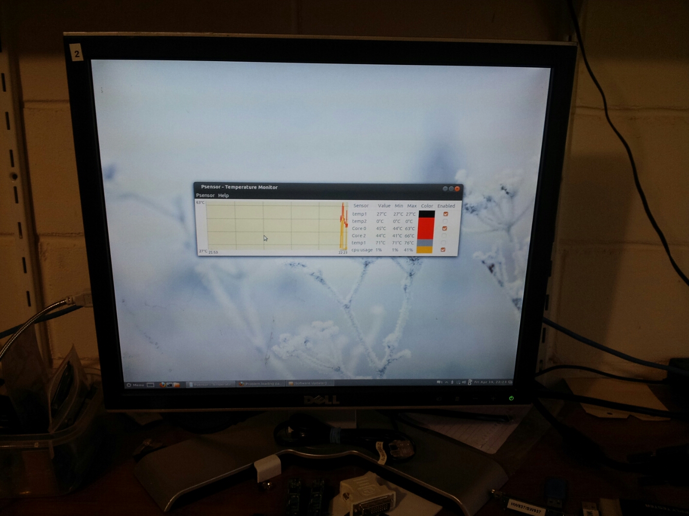

    Reflowed the two memory chips next to the GPU. Preheated with a normal heat gun, then used the hot-air machine at 380'C with lots of liquid flux for about 30 seconds on each of the two chips.
    All came up good. Now a question of how long it'll last.
