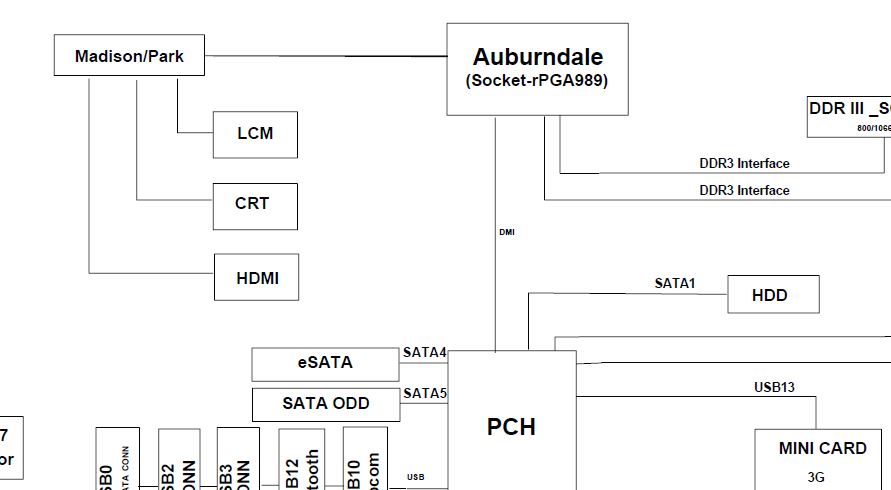

                  Re: Toshiba L655 No diplay
                  I am the first who disassembling the unit and there was a very little dust in cooling fan makes me guess its not overheat related. checking out the schematic, GPU runs HDMI, VGA and LCM. VGA and HDMI output is working well, and I guess this means GPU is good.
                    There is a good chance that it is not the GPU since you have external
                    Did you try safe mode with no external monitor hooked up ?

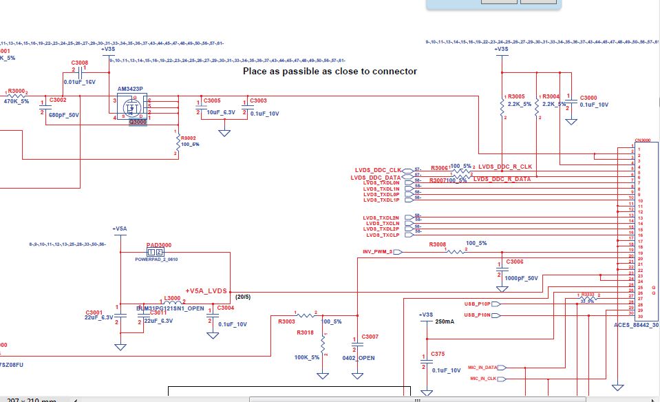

                        Do you see any glow on the screen (usually the bottom right corner shows the best)
                        could be a bad screen, bad wiring cable or even a popped fuse on the mobo.
                        You'll have to open the lcd and check to see if voltage is getting to the screen
                        that should be an led screen on that model so the power in pins are near the one end of the connector
                        I m pretty sure LVDS wiring and screen is good ( tried with good known one before) but I realized there is no voltage at LVDS connector, according to schematic at least there must be 3.3V for screen backlight isn't it ? Let alone the backlight, I can't see any glow on screen.
                        see here
                        I m not getting any of these voltages mentioned in schematic
                        [/IMG]
                          You should have power there when it is running
                          Probably at least the 5 volts that runs the lcd controllers and then the backlight voltage which might be full power from the bat or ac .
                          so if your cable/ribbon is definitely ok, then you'll have to check things right at the motherboard
                          I think there is a fuse or two right next to the connector on the motherboard
                                  my bad . problem turned out to be a bad LCD. I didn't pay attention enough while I was trying new screen. now the display is ok with new LCD. thanks all !
