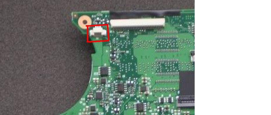

                Perhaps I'm not describing this right. Someone told me this was called a graphics inverter. It's a little white connection point on the motherboard. about 30mm by 3mm.
                A monitor wouldn't work in this, it's not the vga port or whatever it's the little point on the motherboard. It has about 20 little copper connections inside it.

                can you see that little white retangle port there at the top centre of the board. That's the offending article. can that be replaced?

                  Do you mean this one,
                  Wondered if it was a led connector but dont think it is led lit
                  Obviously most things can be replaced depending on availability and skill
                  if it has 20 solder connections in that small space I wouldnt be able to do it.

                    that is the fan connector which you marked. the one near it is the screen connector.
                      Re: Hp 6735s no display
                      And yes you can fix it by replacing.
                        Thanks Spidey just need OP to confirm. I didnt really think it was the one I marked but he said small??
                        EDIT Haha - missed the 30mm x 3mm so yes its just an ordinary
                        graphics connector. - Still not a real easy fix unless his soldering is up to speed.
