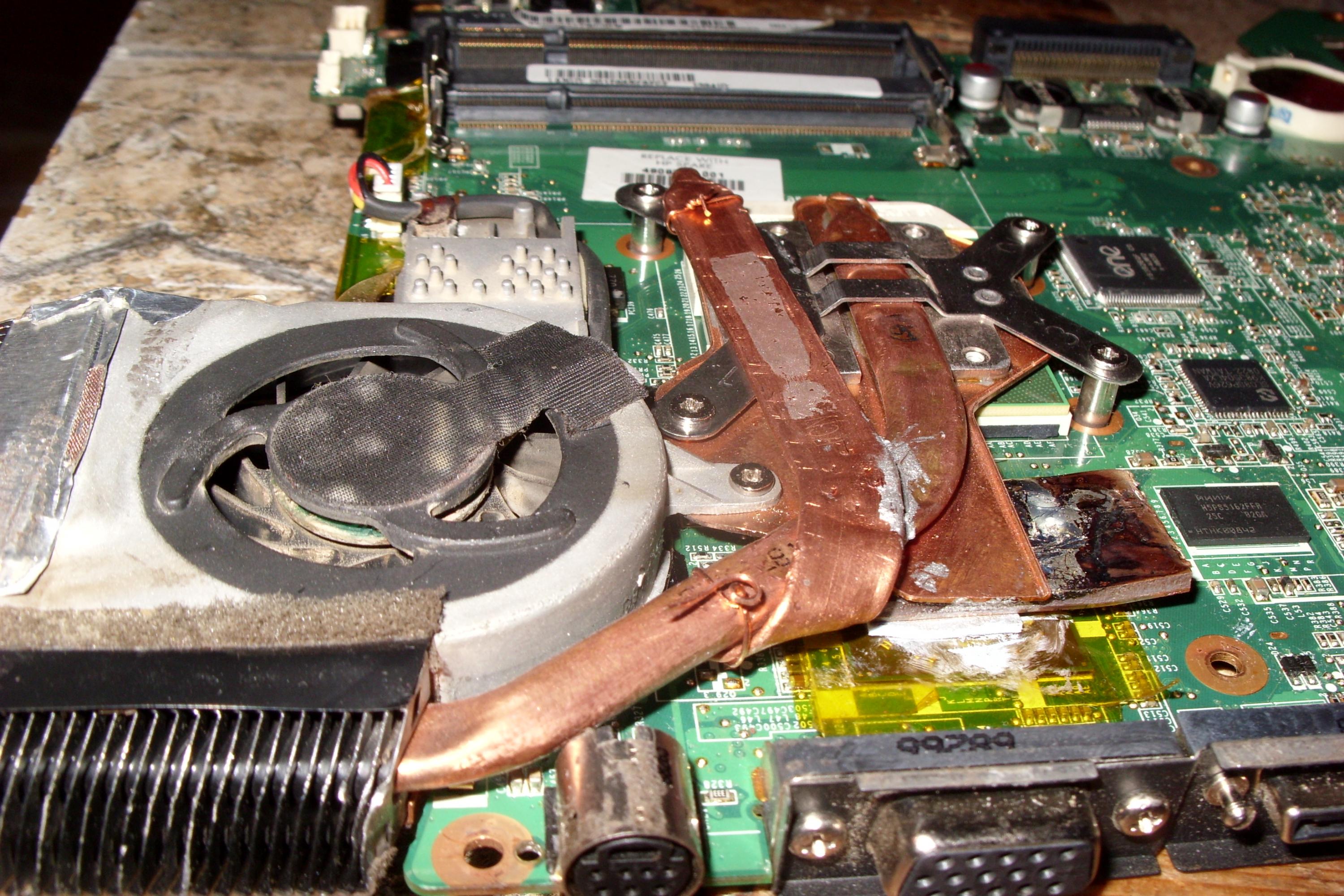

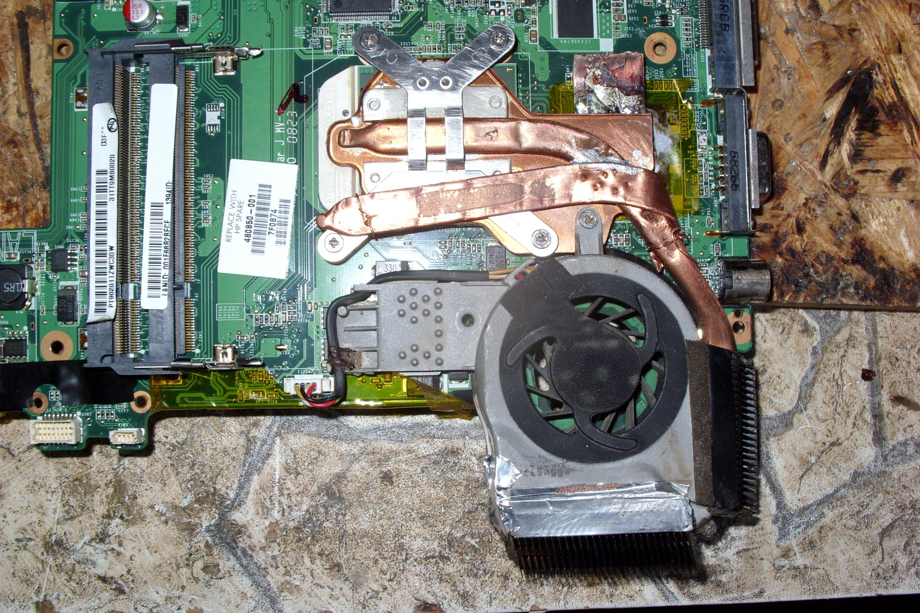

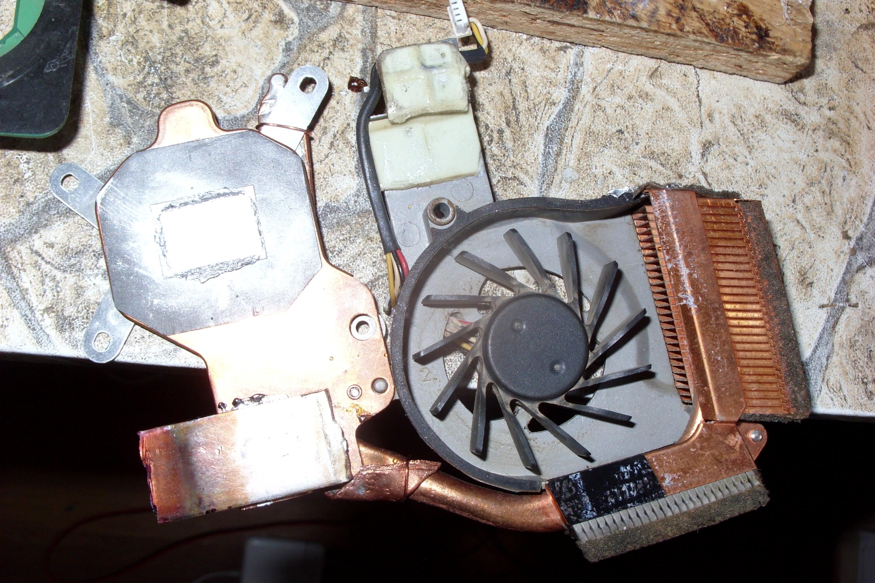

now that's ghetto there's nothing that a piece wire and some duck tape can't fix.... definitely needs to be replace. Here's a link for the glue.
