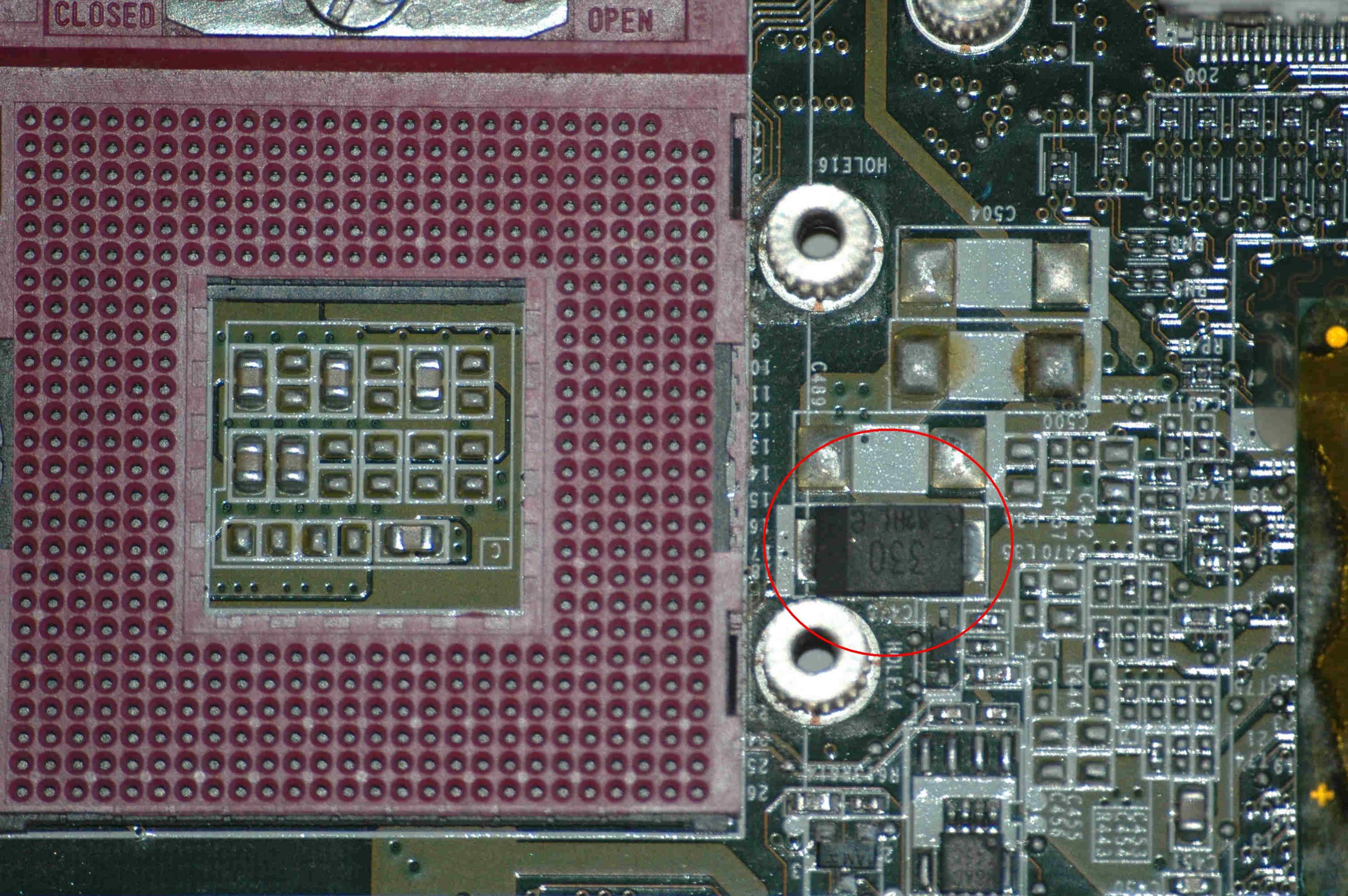

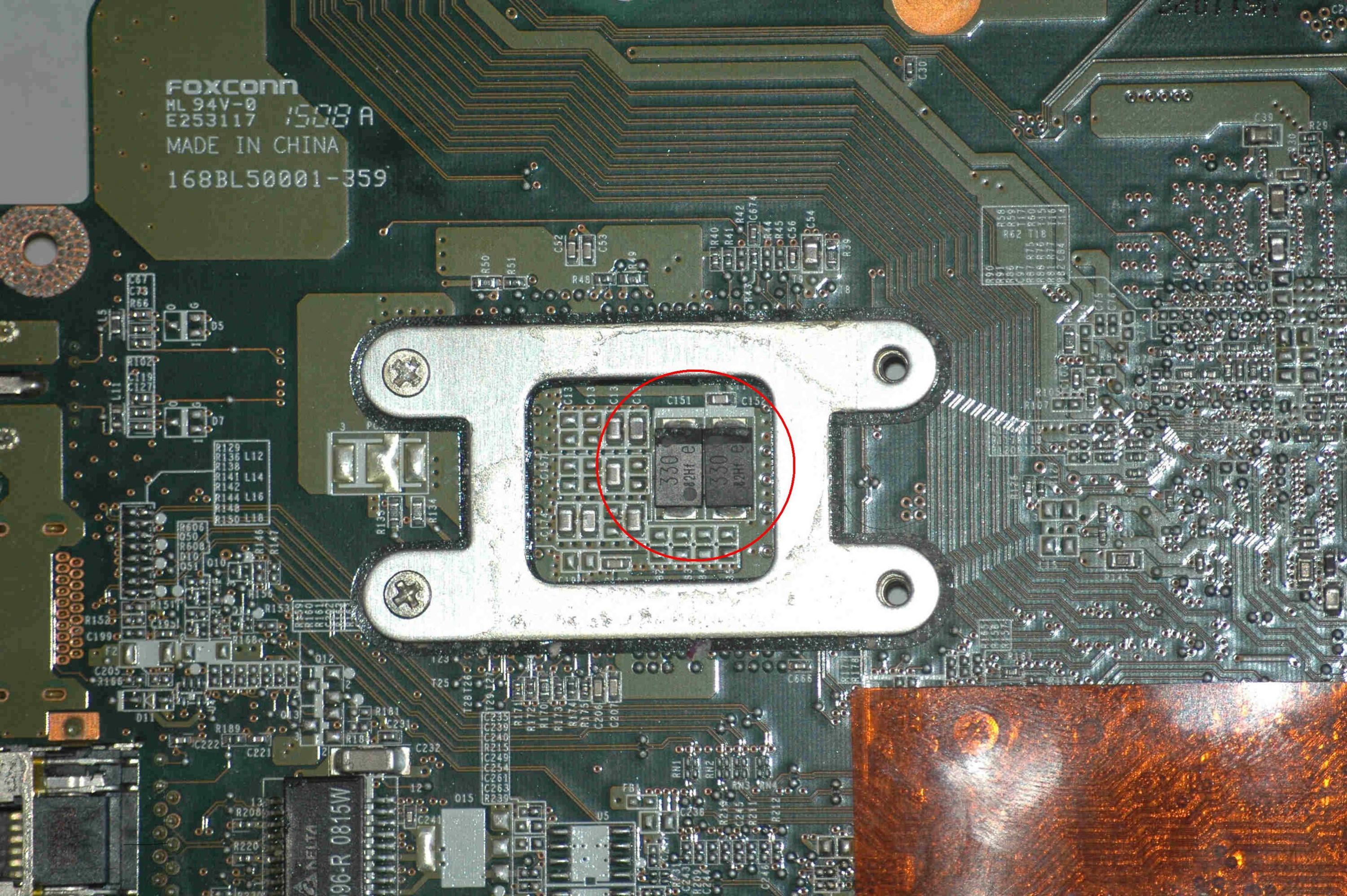

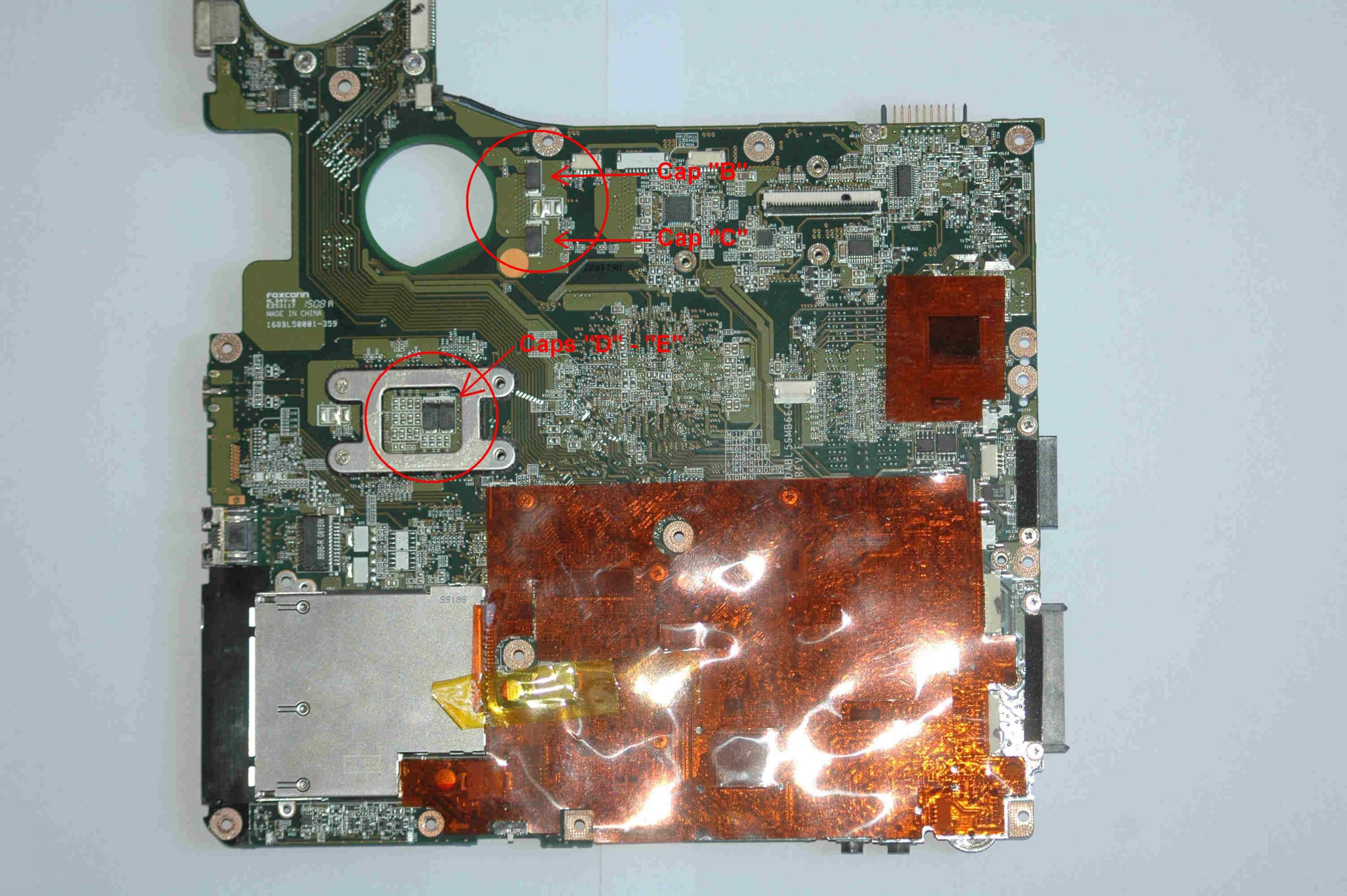

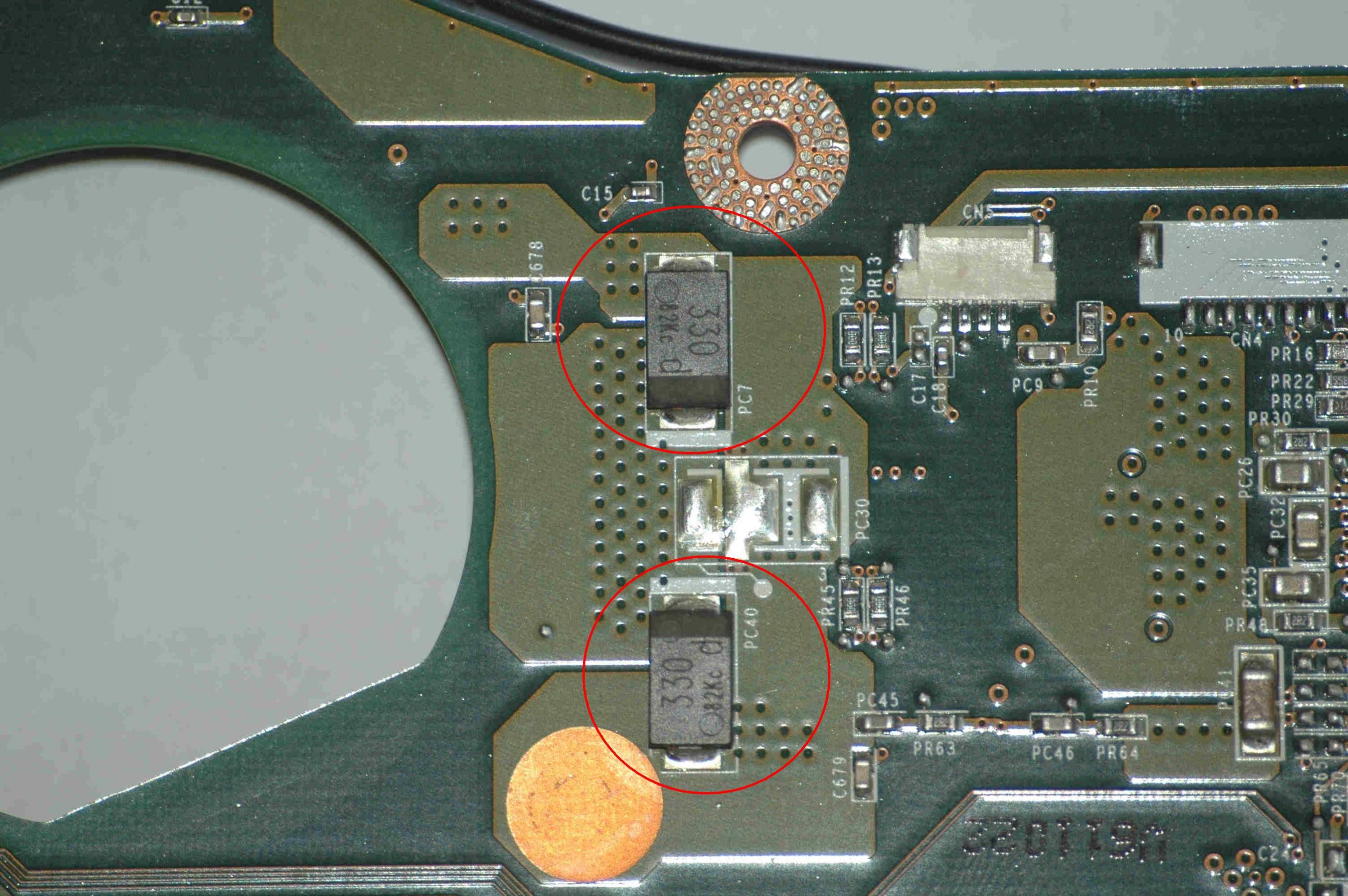

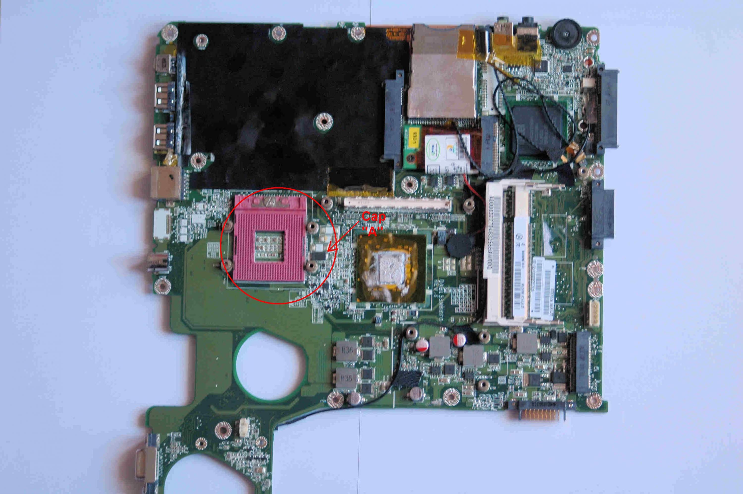

    Hi everybody, I am Max and live in Italy.
    I ask your help to fix a defective TOSHIBA A300-1BU which turns off as soon as I start it using AC/DC adapter. I don't know whether it works well with battery because a friends of mine gifted notebook without this one.
    I've read many topics on this forum about Toshiba power issue (related to Nec/Tokin capacitor) but, unfortunatelly, this motherboard doesn't use this capacitor. I found schematic of motherboard here: "http://www.forcomp.cz/soubory/Toshiba-Satellite-A300.pdf".
    As you can see in the pictures I've attached here, there are five capacitors 330uF/2.5V (identified with letter from "A" to "E") involved in CPU power circuit control. I think to replace them with new one.
    Do you think this will resolve my problem?
    Thanks everybody in advance.

    Re: Toshiba A300-1BU power issue (no Nec/TOKIN capacitor)
    Does it turns off so quickly, that don`t let you enter into bios?
    • massimiliano1970
      • Jan 2013
      • 8
      • ital
      Hi Francisco.s, thank you for your reply.
      Yes, I can enter the bios, I restored default settings too. The notebook shuts down suddenly within less 1 minute.
        Check temperature of processor / GPU. It may overheating and automatically temp sensor sending informations to shuts down the system. Caps may be bad but if so I don't think you can even turn it on.
          We know more aspects about the problem.
          Does the fan start spinning?
          • massimiliano1970
            • Jan 2013
            • 8
            • ital
            Yes, Francisco, the fan starts normally but the notebook stops after 30/40 seconds.
            As gabik111 suggested me, i will check temperature of CPU/GPU.
              Hi, I have the same problem with my Toshiba A300.
              I can charge the battery when pc is powered off.
              And I can start this pc normally with only the battery.
              If I try to connect power DC, the A300 goes off after 2 seconds.
              If I try to start the pc with power DC without battery, the pc seems to start but only loop without boot.
              My pc only starts with battery and I cannot use its with power DC.
              I try different DC power unit without nice results.
              I can run Bios menu when start with battery: I tried all different configuration but without good results.
              On motherboard I can't see any broken parts (fuses or caps).
              Can someone help me?
                Some A200 owners used to disable the CPU drivers as a temporary fix.
                Can be found in Device Manager under Processors, in Safe Mode.
                It might give us a useful clue.
                  max
                  try add the blank slot with 330 caps..feedback me what happen...'' low power on processor ''

                    • spleenharvester
                      • Mar 2010
                      • 921
                      I'd be very interested to find out if anyone has ever solved similar issues with these.
                      With the A200s/A300s/L300s/L350s and such which all have NEC Tokin issues, there are lots of people who have the same symptoms but no NEC Tokin.
                      Surely the problem must be in the same area?
