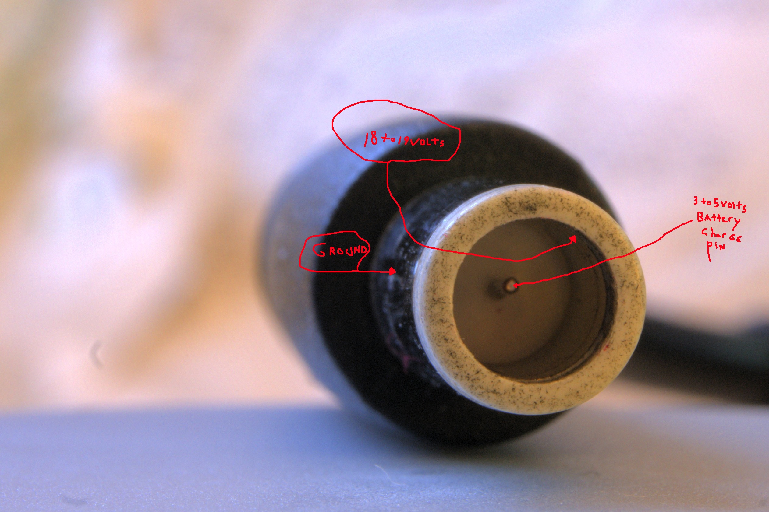

                                check the dc jack on mobo, make sure none of the pins are loose, if you have a digital multimeter put it on diode test and check continuity from the pins on dc jack to motherboard, and on the power cord there is a pin in the center that controls the battery charging if this pin in broke or not putting out 3 to 5 volts then the power cord either needs a new end or just replace the power cord and the metal inner circle is supposed to put out from 18 to 19 volts dc and use the outer of the plug as your ground...sounds like this laptop had a rough life messed up jack and overheated very common problem with people and laptop. now that you got it working again you will need to watch your temps and make sure its cool before you shut it off otherwise it will happen again....
                                and set the multimeter to dc volts 20 when test the ac adapter voltages if the center pin not have any volts then it will not charge battery another common problem with dells put black probe on outside of the plug and red probe to the center pin that looks like a needle should have 3 to 5 volts if none then the charger is bad....

                                  Re: Dell Inspiron N5110 help!!
                                  here is an illustration for you
                                    hi heavymachines i really thank you for helping me i really appreciate i will check it after my work thank you very much
                                        any updates?
                                        hi heavymachines sorry for late replay i check the ac adapter port in the middel pin i cannot get any voltage output i try to check other ac adapter but the same still no volts output what do you think i need to check the dc jack port to? thanks for your help !!!!
