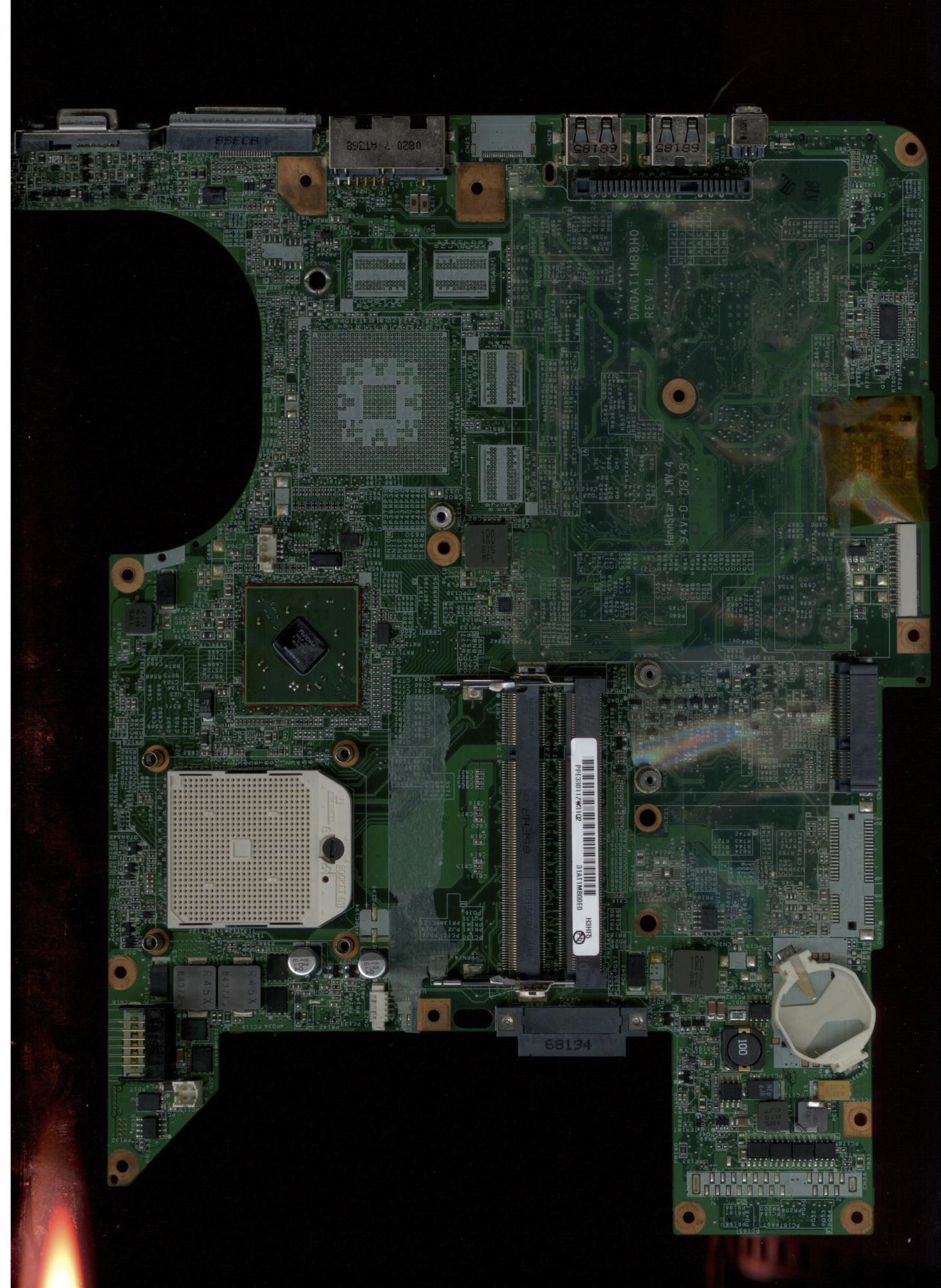

    Hi everyone,
    I have an HP Pavillion DV6810us, aka DV6700, aka DV6000. It has an AMD cpu and NVIDIA chipset. The problem is that it will not boot at all. No fan or hard drive spinning, no lights, no beeps, nothing.
    I know that these laptops typically have overheating problems and the graphics card will need to be reflowed, but I don't think that's the problem because the laptop is not even powering up or POSTing. I did remove everything and try to turn it on without, but it's the same exact thing.
    My main suspect is the PPM or VRM chips, as those are typical causes of this no power symptom. However, I suppose it could be a capacitor or driver on the mobo also. Also, the DC adapter works fine, and the charging ring and light turn on when plugged in.
    On my laptop, the power mosfets are different than the ones in the link above. the FDS6679 is a 4856a, and the AO4407 is a 6679gm. I know I can go ahead and unsolder these and test them outside the circuit, but if I did that I might as well just put new ones on, and also, I don't want to risk doing a bad solder job and ruining the rest of the board.
    So basically, is there a way to go about testing the board without unsoldering anything? I have a DMM with diode and capacitance functions and a block diagram/schematic available (see attached). I really don't want to replace the board because I want to be able to sell this computer for a new one and putting a new mobo in would be too expensive and not worth it.
    Any help would be greatly appreciated!
    Thanks,
    JGAN

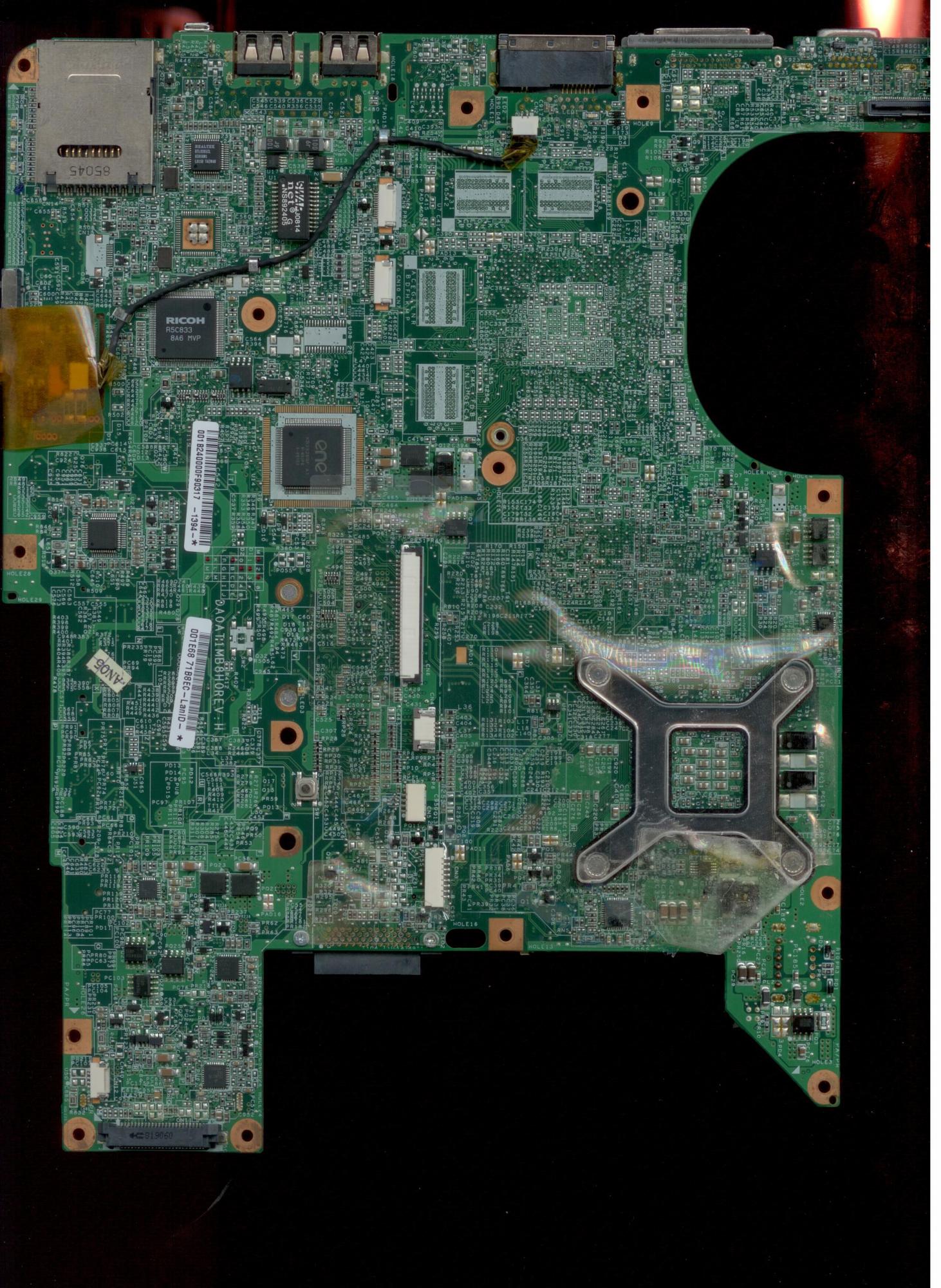

      I have attached a couple of high res images of the mobo for reference. One shot is the top, the other is the bottom.

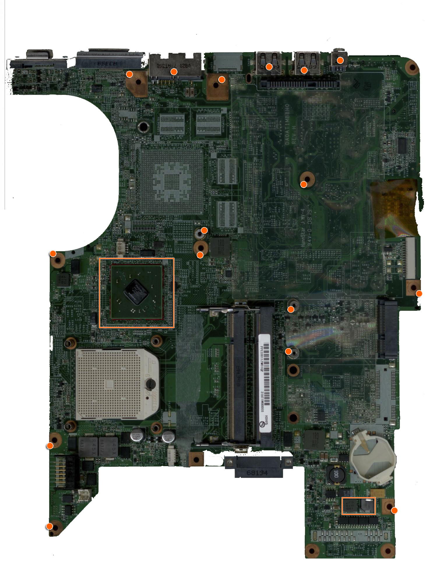

            Re: HP DV6810us - no boot, no power, bad power mosfets?
            Hi. If this board as your, and you got readings 5 and 3 volts and no shorted coils is like (my opinion) 70% chance to bad chip, bad contact or sodler under the cihip join together under the nvidia chip, is only one.
            Dot marked is places where you can put black - miltimeter probe
            square mark is where usual find the 3 and 5 volts
            big square mark is nvidia chip
                I mean If you got power, and no one of coils shorted, then is problem somewhere else, and on board with nvidia graphic is a a lot of times problem on chip.
                Yes is possible, I got same problem 2 times, after reballing nvidia chip is work again, because solder balls under chip is bridget. Im not say is in your case 100% this problem.
