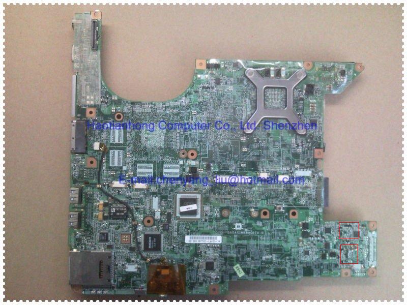

    dv6500
    Intel dv6500 does not turn on the light only lightblue ofchange what can be i am check some mosfet when be plug cable of change and dont see 28v there so who can give help
  • swanand
    • Dec 2011
    • 51
    Re: dv6500
    if your system has nvidia mcp67m-a2 chipset then below is your solution
    Compaq F700 laptop on hp dv6000 amd no power or no signal charging Solution
    Dear friesnds in Most of hp dv6000 & Compaq V6000 laptop amd, amd laptop F700 no charging signal & no power on problem solution is located at one mosfet Q27 (6leg) i & one faulty daiod mofet is connected to the short ... than replace it .... and your problem will be solved for

      Re: dv6500
      Regards
      Swanand
      Hi is possible to show location of this mosfet ? On dv6000 board ?
      Thankyou.
      • swanand
        • Dec 2011
        • 51
        Re: dv6500
        plz find the attached picture
