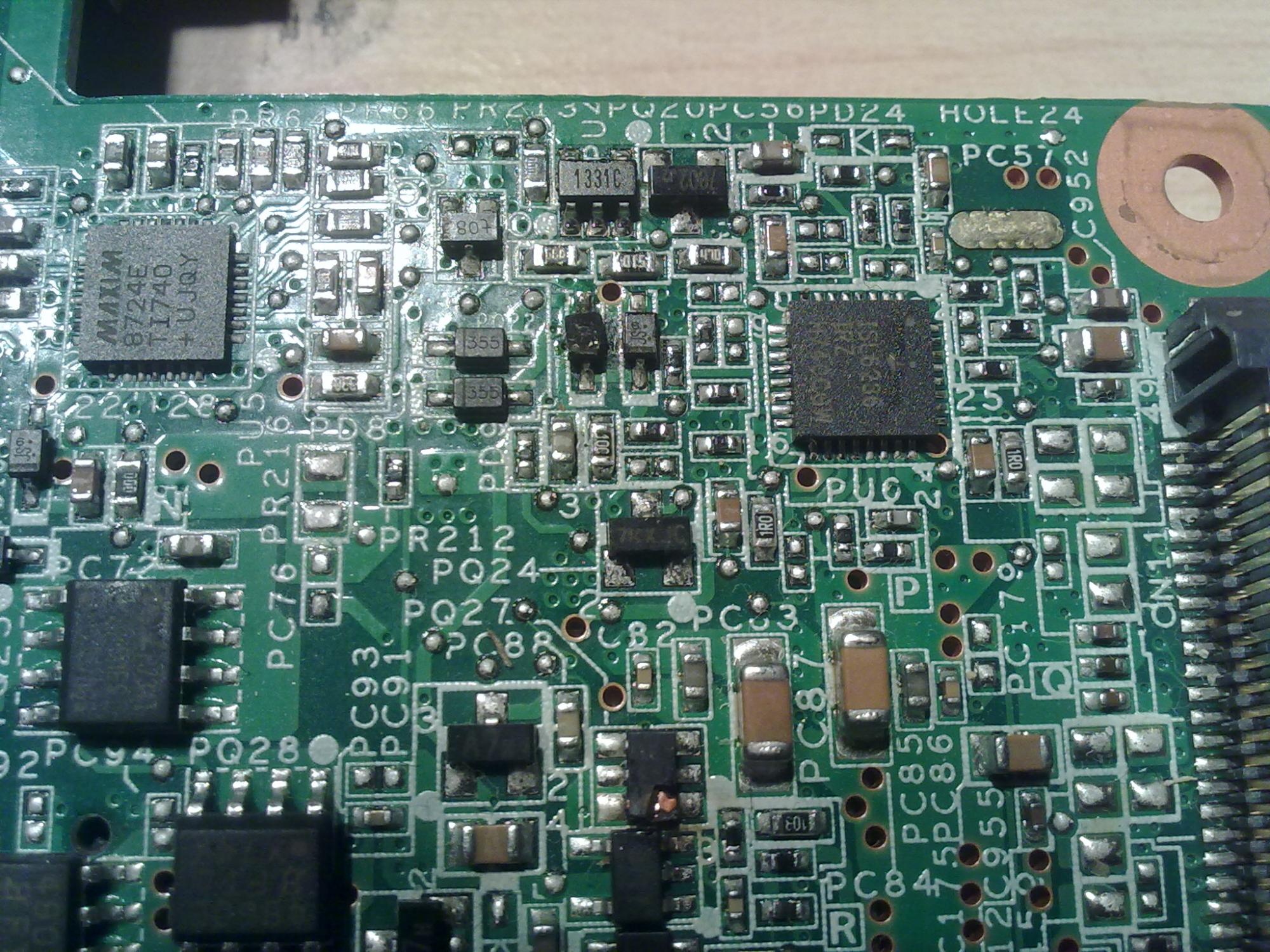

              Thanks for the Help, upon closer inspection I found a couple of components blown down near the Sata connector. I was able to identify the Pq27 as a 1Mz2 I think , but I cant seem to id the diode in the pic.
              PQ30 has 19v on pins 5-8 rest of pins have 0v
              PWR_SRC is 0v.
              VH28 0v
              Acok-2 0v
                Q27 could be a MOSFET, but I'm not entirely sure.
                As for the overheated diode, it looks like it's the same as the one next to it. But that's not too much of a problem, since you can replace it with an axial though-hole one temporarily just to see if it works (when you replace the other bad parts, that is).

                  Problem solved tahnks for the help.
                  Problem statement
                  Laptop dead not powering up.
                  Used battery with small amount of charge and laptop boots fine.
                  Will not charge or power up from mains.
                  Solution
                  Found Pq27 IMZ2 (Bipolar Small Signal NPN/PNP) damaged and short.
                  Found Diode (PD12 I think unable to see marking on CB) short.
                  Pq30 pins 1-3 )0V
                  VH28 =0v
                  Replaced both pq27 and diode and laptop powers up from adapter again.
                  Again thanks to all.
