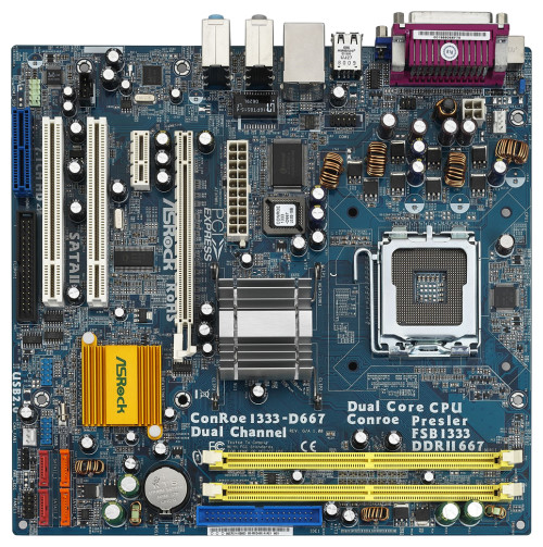

    Dear all,
    can anyone guide me, How to check and where to start checking dead PC motherboard. It is just powering on but no display. (Asrock - Conroe 1333-D667)
    Please help me on this.

    Re: PC Motherboard Repairing
    New video is common indicator of a blown chipset.
    Does it boot and display with an add-in video card?
        Looks like this motherboard has all OST caps including around the VRM. You will have to change like 20-30 capacitors.
          Okay,
          At first you say it's powering on, now you say it isn't booting.
          There are lots of things that could be wrong and you aren't giving enough info to know where to start.
          What exactly is it doing?
          - What lights?
          - Drives spin?
          - Fans spin?
          - Does CPU get warm
          - Does chipset get warm?
          Or is it just cold and dead?
          What is the power supply.
          Have you checked the power supply voltages with a meter?
              Processor heating. No other parts heated. Power supply is OK. RAM is OK. Fan is running. Power LED is on. No beeps.
              • PCBONEZ
                Grumpy Old Fart
                • Aug 2005
                • 10661
                Is this board one you had working and then it quit or is it something new to you that never worked?
                Try resetting the CMOS. [aka BIOS]
                - There is a jumper somewhere to do that but it's usually easier to just as easy remove the battery for 15-20 seconds.
                ** Have power to PSU [from AC] off while you do this either by unplugging from wall or turning off at the switch on the back of PSU.
                ** If you don't the CMOS will be powered from +5vsb while battery is out and CMOS won't reset.
                If that doesn't work then tell me what caps you have on the board in a list as so.
                [Number of that cap], [uF], [volts], [diameter], [Manufacturer], [Series]
                ~ example ~
                4x, 1800uF, 16v, 10mm, Chemicon, KZG
                ----- [Only need the ones larger than 5mm diameter.]
                Pic added in case needed later.
                Might need to know -where- some caps are.
