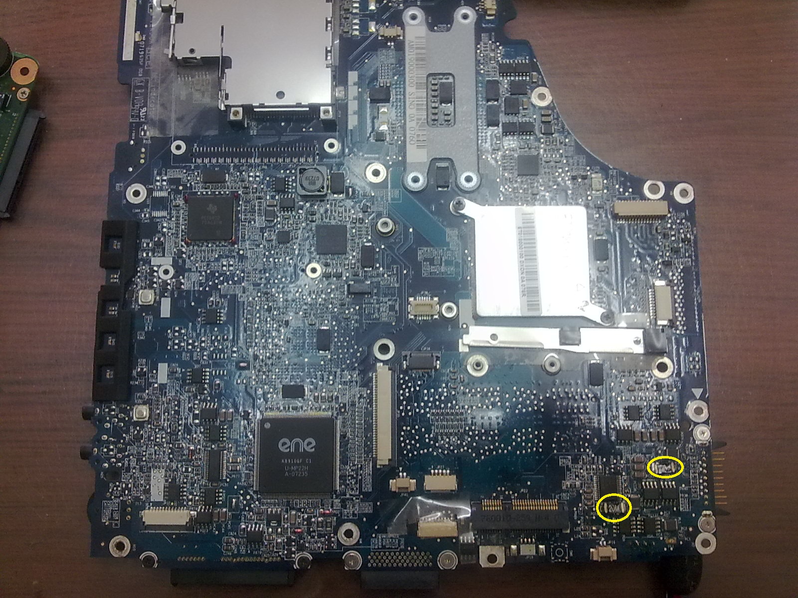

    I got toshiba Satellite L300, its working on battery but when i connect charger it turns off. but when i connect it to laptop without doing it on it charges battery. but without battery it doesn't work with charger.

    Re: Toshiba Satellite L300 Power Problem
    Probably a Maxim or TI battery management IC acting up. If it charges, the charging circuit is fine and running off battery means the rest of the laptop is not shorted. The battery management IC controls the logic of switching between battery and AC. Look around the battery connector and see if you can find a small (~ .5") square IC labeled Maxim or TI.

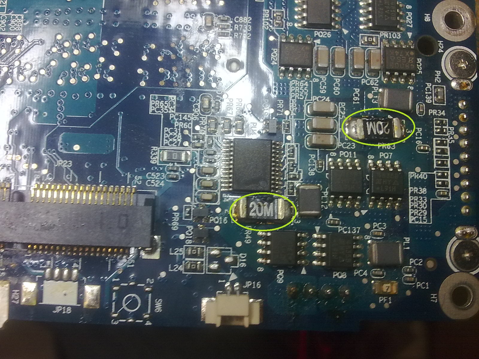

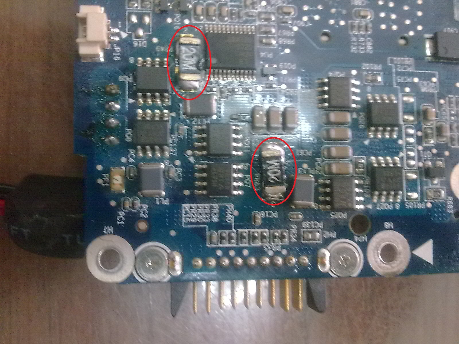

      Thanks for replying i will check that ic later now i got another laptop toshiba satellite A200 these 20M resistor showing Zero Ohm Resistance. laptop is dead not showing power indication, charging light nothing at all.
        Did you remove those to see if they were in fact bad? They look like they've been removed. I've never seen those bad - usually its one of the neighboring mosfets or a shorted cap. If one (or more) of those are bad, they will usually give false reading on other components. The only way to tell for sure is to lift one side of the component and test it that way.
            20M on the resistors is in fact 20milliohm... that is likely short
                When resistor go bad, they raise the resistance, not the opposite.
