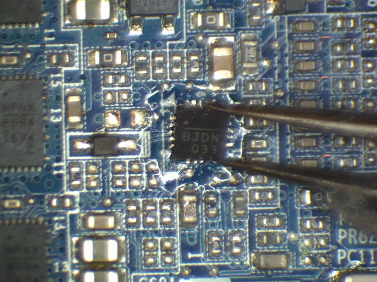

    Hi everyone,
    i have mainboard from GIGABYTE G5 GD gaming laptop. Power on, loading windows, everything looks OK then puf, FAN goes full, system turn off after 40 sec. (no normal shutdown). The same is in BIOS setup. No overheating detected. Finaly I found, that video card have no power. I found this faulty IC, very low impedance. So question is? What is that part, anybody knows maybe? Thank's
    BJDN 033
    it seems to me like MPS multi phase controller.
    Near is VRAM power supply circuit 1.2V and have similar chip BJDN 076 who works vell. I try to switch them, but no results. They are probably not interchangeable.

    https://www.badcaps.net/forum/troubl...and-datasheets
    There seems to be an opinion here that the ones starting with bjd are the same, I'm not exactly sure, the same motherboard has 0.3v in the video card coils and turns off after about 180 seconds. The processor temperature seems a little high with another cooler without a fan. Were you able to solve the problem? I have the same problem.

      Unfortunately, I didn't make it. I didn't have any similar cases then. The chip is still a mystery​
