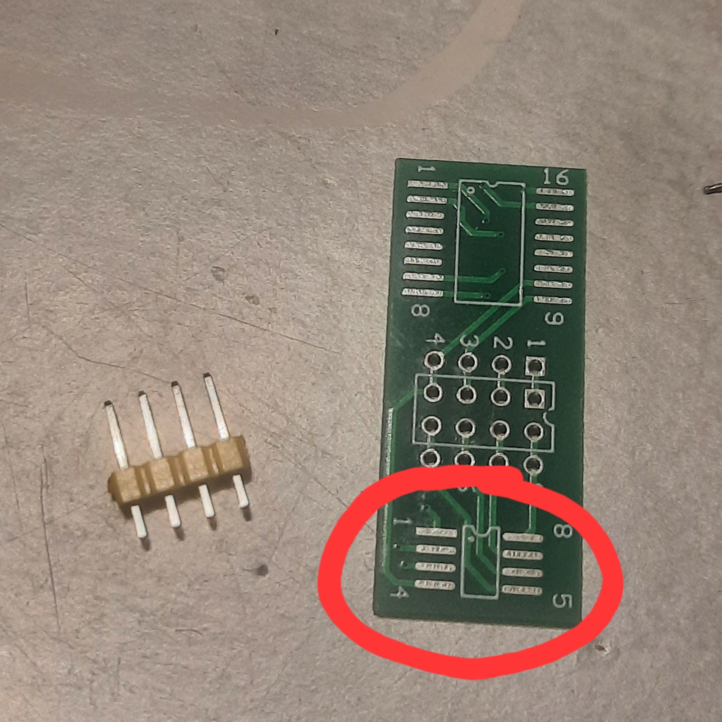

    I couldn't find a solution to this and I searched everywhere, the only thing I couldn't try was to reset the cmos battery since the laptop didn't have one, so I saw that the laptops that didn't have a cmos battery have some jumpers that make it a bridge. The bios would reset but I couldn't find the jumper and I tried to find a schematic for that exact model (which is X456UA) that wasn't under a paywall but I couldn't find it.
    So my last resort was to go to a technical service store and ask since there they would have more knowledge than what I have and what they came to was that the bios chip was damaged and that it had to be replaced, I can't do that. since I don't have the necessary tools and that's why I'm making this thread to see if there is anything else I can do on my own and try before taking it to technical service.

    What tools do you have , d you have a solderiron that can give enough heat you can wire a wire zround the chip fill it with solder and remove the bios chip so or ude lo melt solder as suick chip to remove the chip i done it severzl time by place where you can not come with through plastic connectors. It is not a good idea to use the clip to read bios chip you have to remove it

      So do I unsolder the bios chip and then solder it here (image attached) and connect it to the ch341a programmer?
