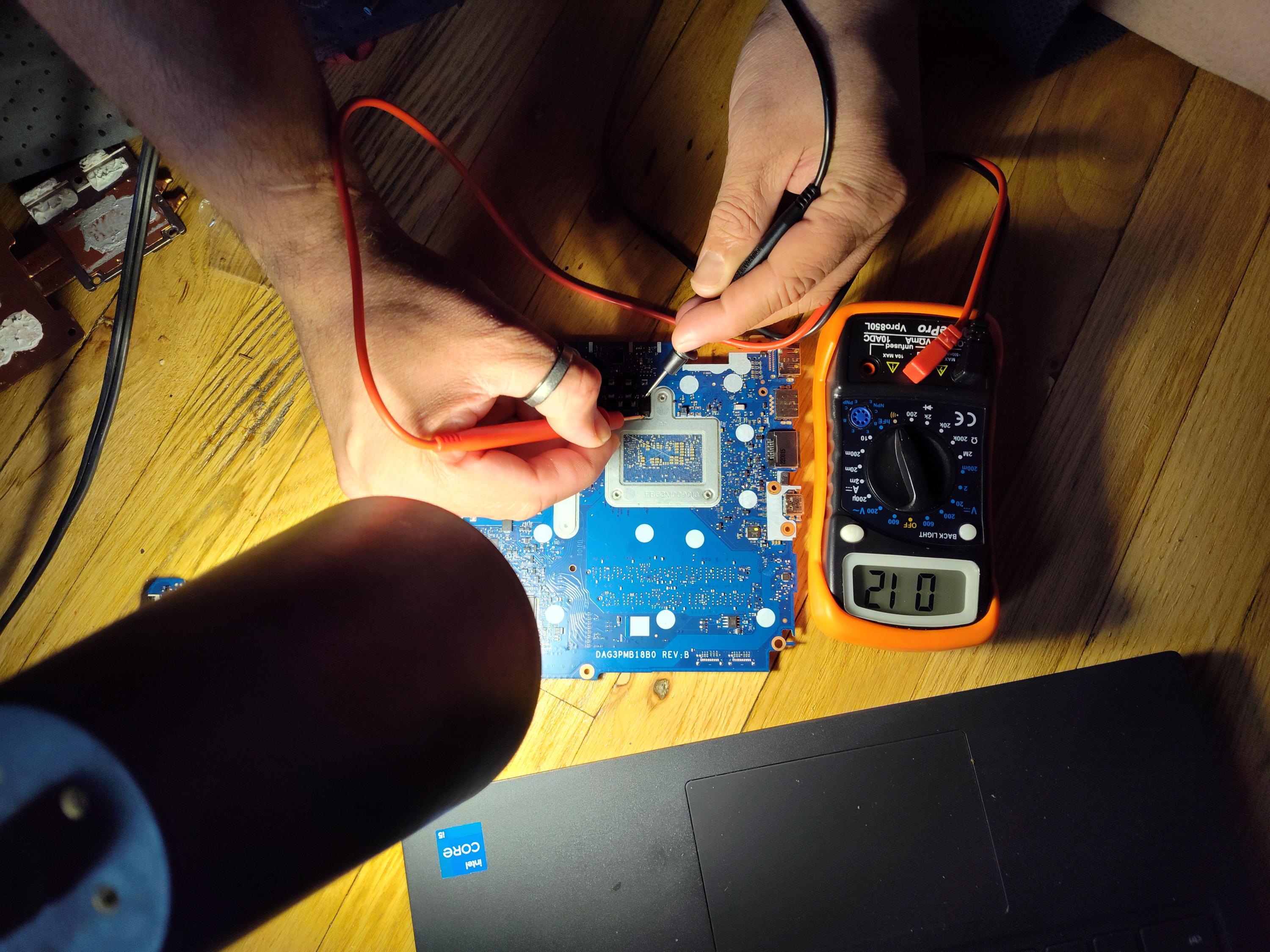

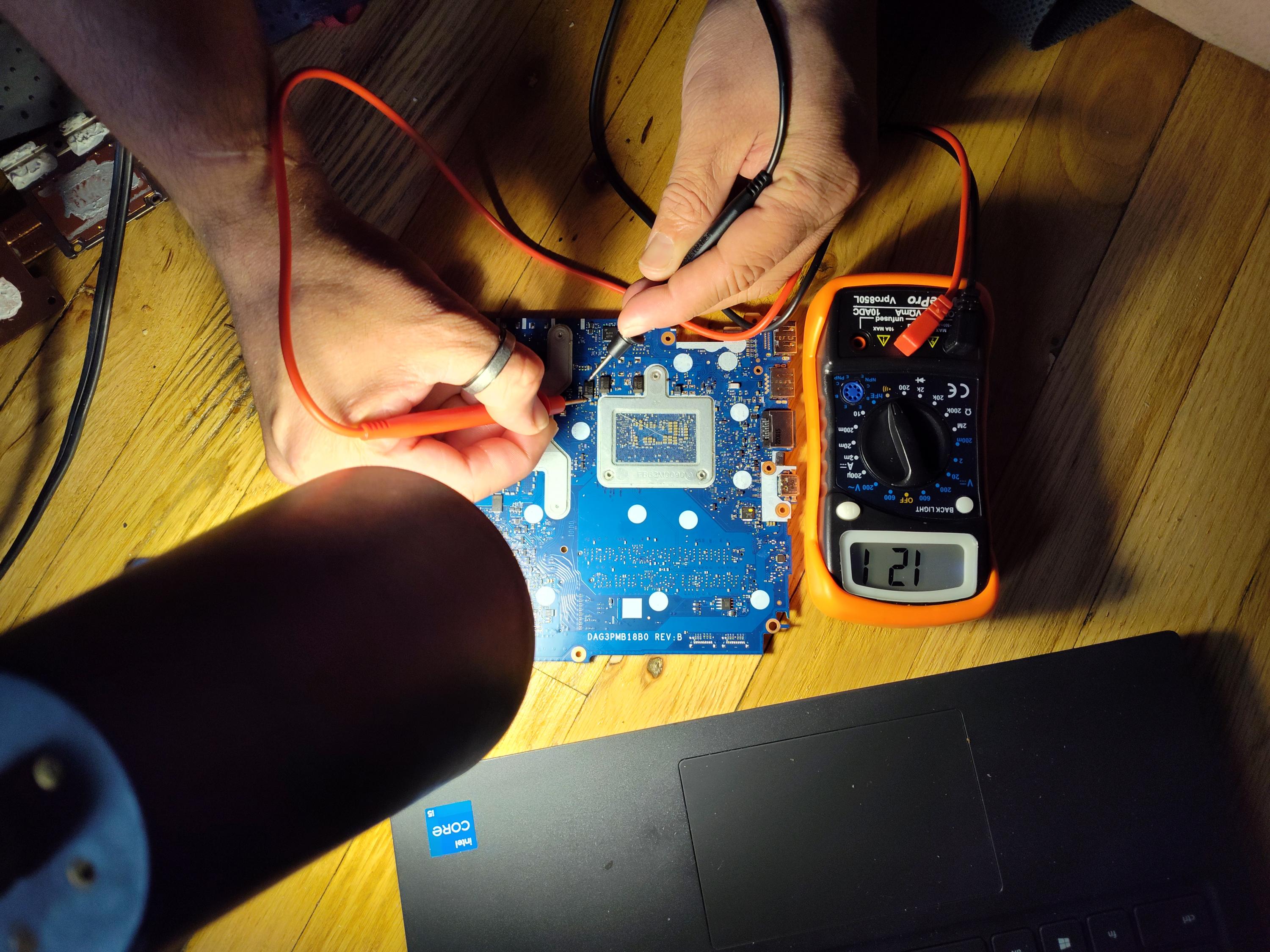

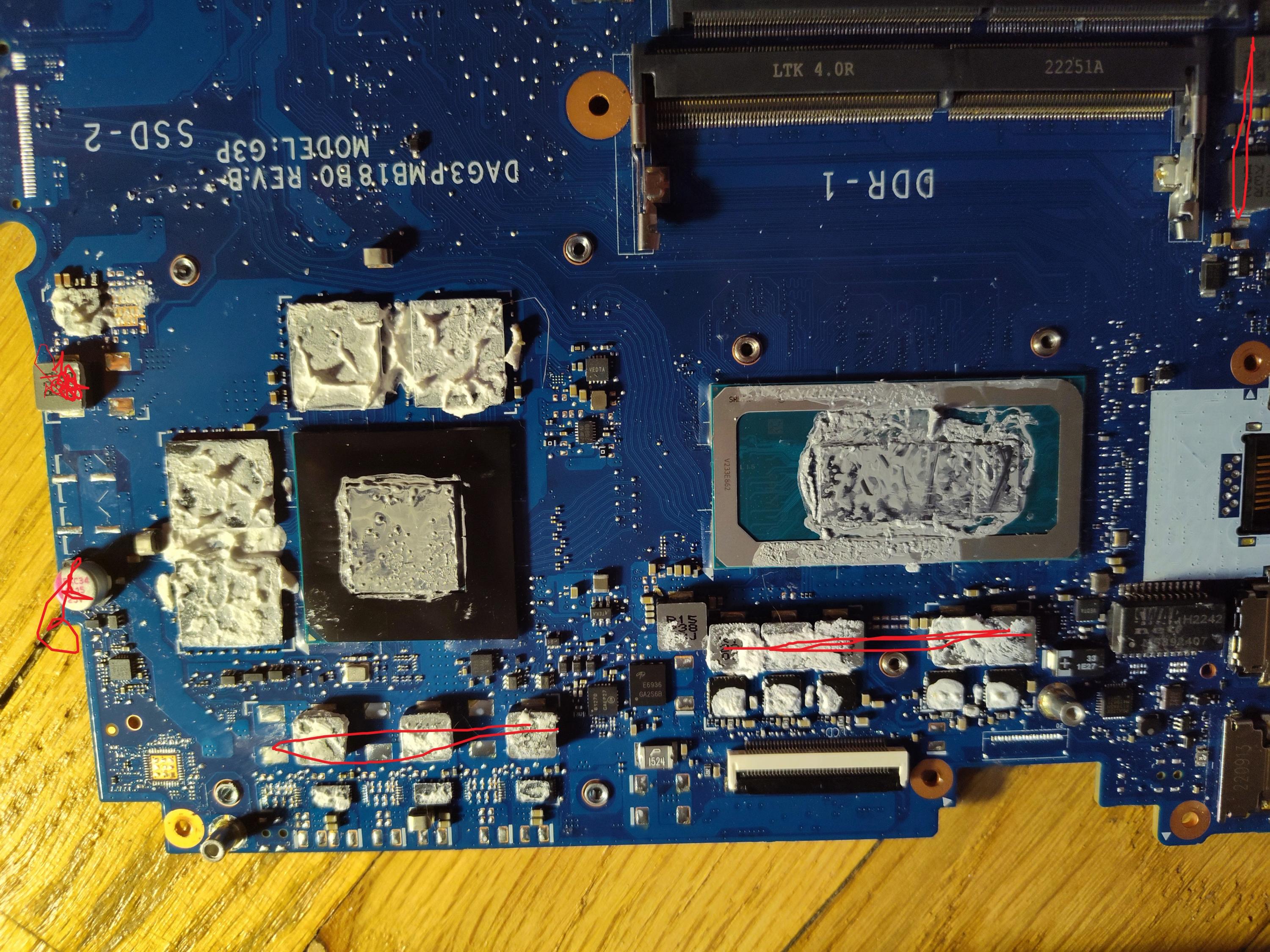

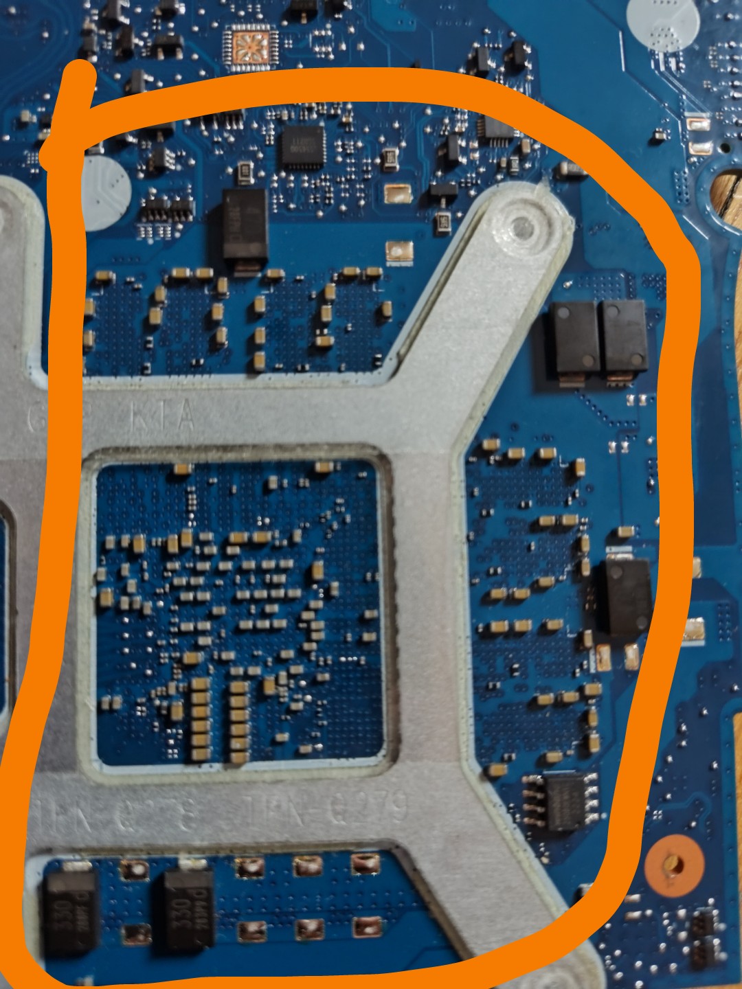

                        Hello, I have been busy with work.. Today been testing the board for continuity, and what area of the board getting power this what I have so far attached pictures.
                        2 of the picture Im doing continuity test one has higher reading no beep
                        other one has lower reading it beeps indicating is close path(good?)
                        than other picture circle in orange is other area i test ididn't get any beeps and high readings.
                        on 4th picture with red brushes and white terminal I test around here i got audible and is getting power when I plug ac according to the video i watch usually this the area check first for shorts and bad cap etc...
