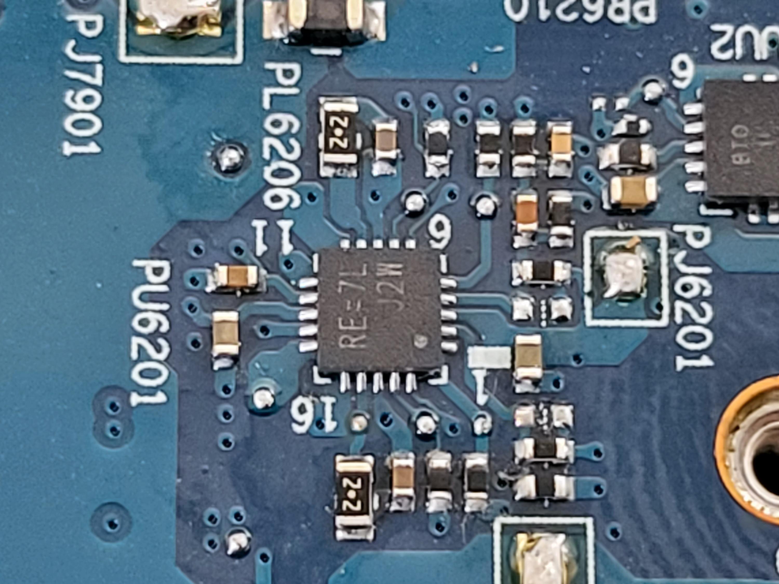

    Hi guys got a Lenovo Legion 5 15ACH6AH with no power or charging issues I have found a chip under infrared that goes pretty hot and has shorts on a few caps near it but am unable to find out what this chip is exactly and where to buy a replacement from.
    Chip is RE=7L J2W

    Parts with an = in the marking are made by richtek https://www.badcaps.net/forum/showthread.php?t=90619

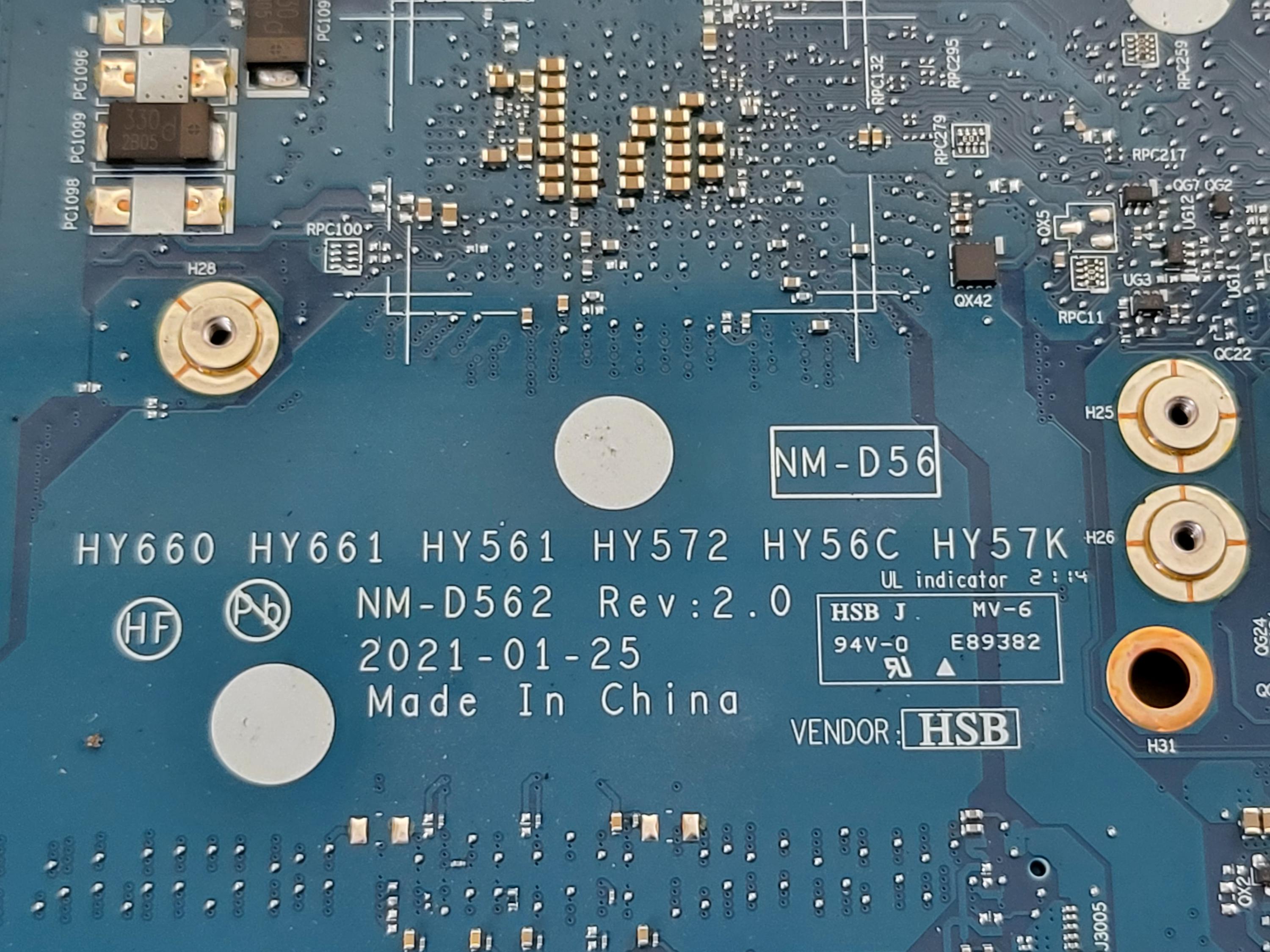

      The marking RE= has been mentioned before on the forum in this thread https://www.badcaps.net/forum/showthread.php?p=1055089
      The NM-D562 Schematic is available - https://www.badcaps.net/forum/showth...hlight=NM-D562 Page 91 - PU6201 RT6585CGQW_WQFN20_3X3

          Don`t know what you mean by comparison. Ive edited the 2 posts above to make it a bit clearer. Anyway, the part number is RT6585CGQW
