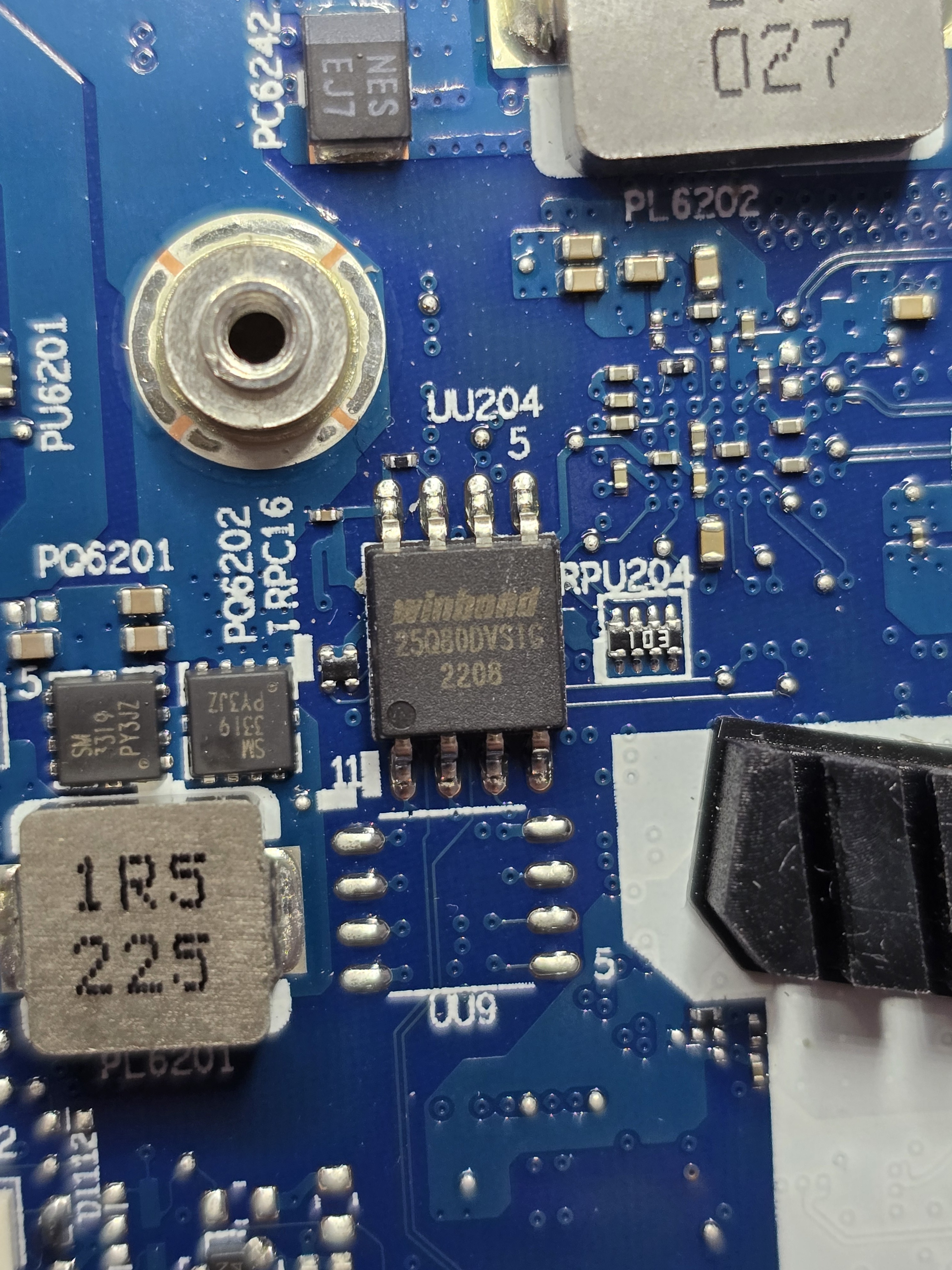

    I've got a Lenovo Legion 5 15IAH7 with no post/no boot issue.
    The mainboard is a NM-E241 Rev 1.0
    Now I am searching for the BIOS chip so I can reflash it.
    But I have some difficulties to identify the correct chip. The schemantics somehow are not really helpful for me (I am a beginner with Laptop schemantics)

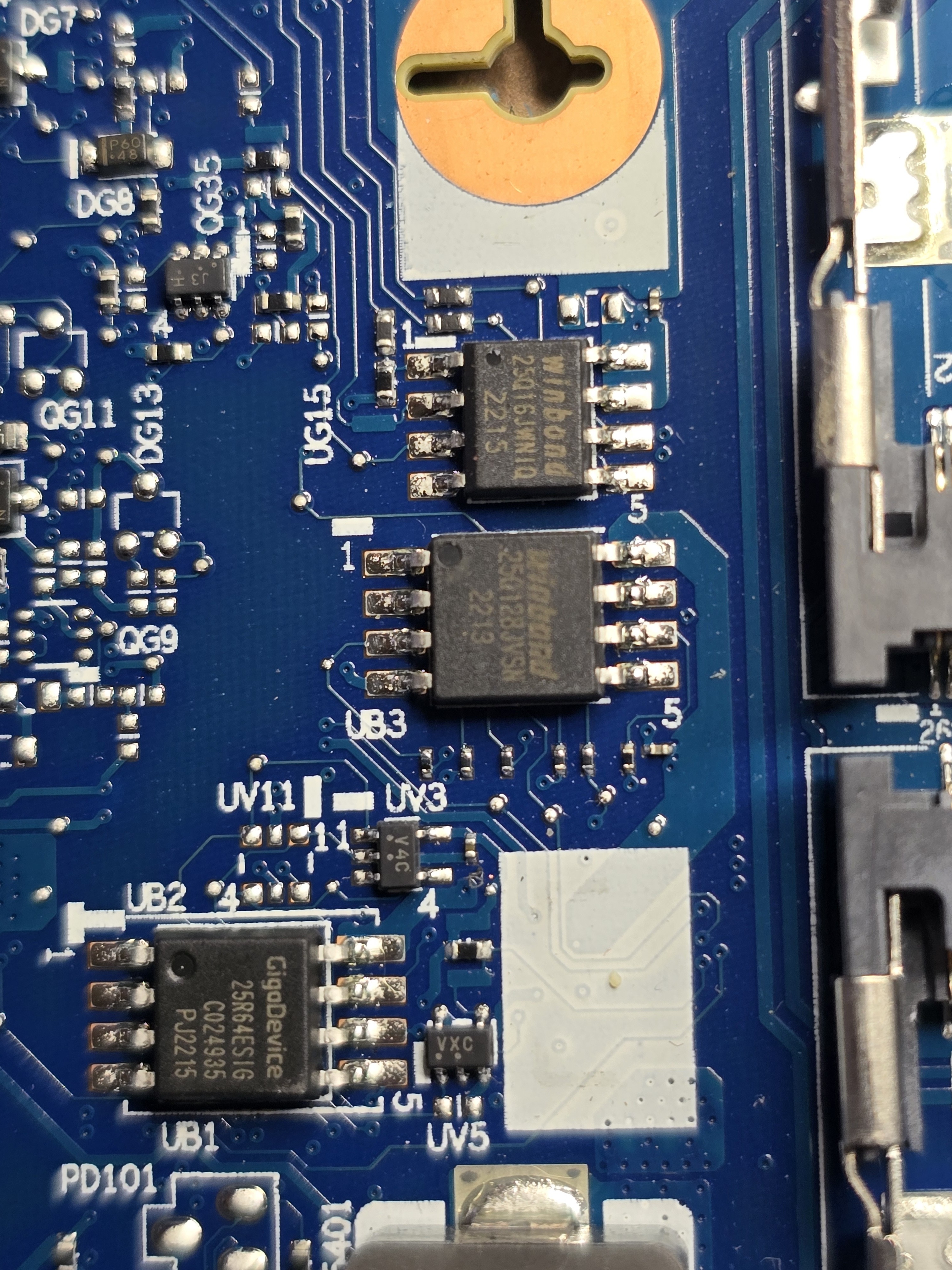

    I found 3 Winson chips and one GigaDevice chip as you can see on the screenshots.
    My guess its the W25Q128JVSIN (UB3) because it is the biggest from all.

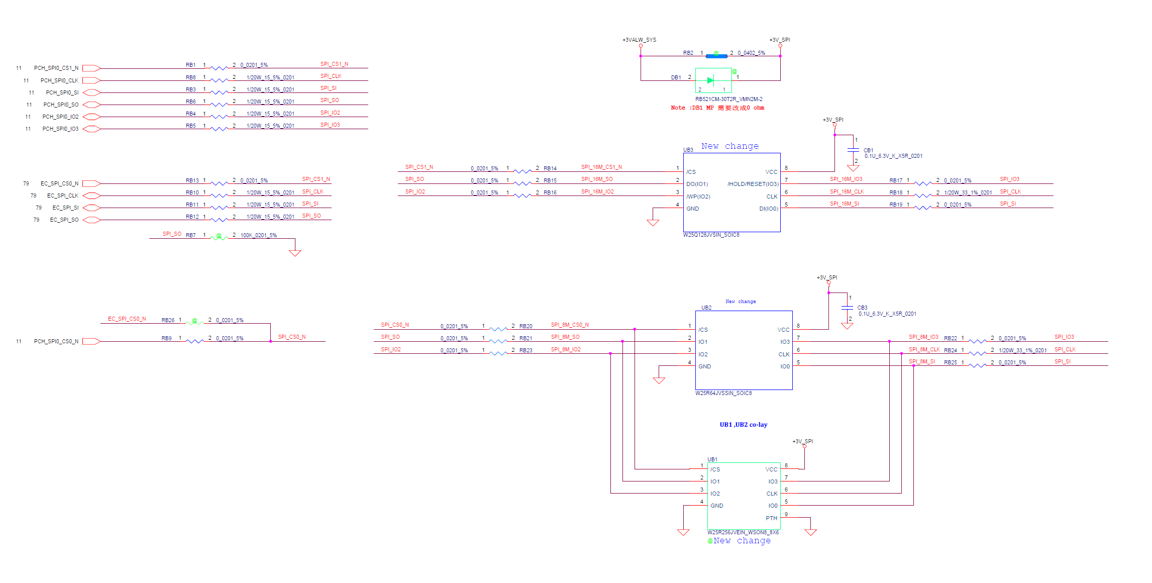

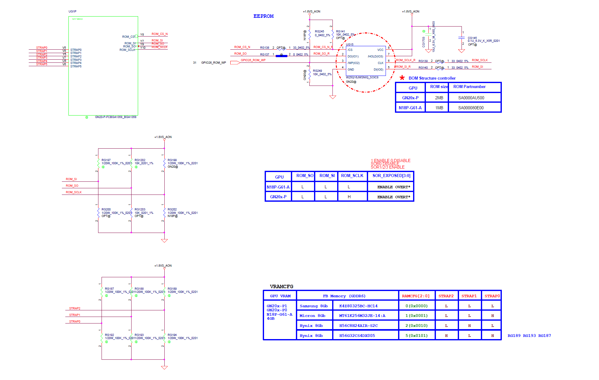

    I attached the pages of the schemantics from the chips, too.
    (And if you found out, which one is the real BIOS chip, could you maybe explain to me how you know?)

    After another research, it seems to be 2 BIOS chips for this Laptop model.
    One contains a 16MB BIOS and the other one a 8MB file.
    I think the chip for 16MB is Winson W25Q128JVSIN (UB3) and the chip for 8MB is the GigaDevice 25R64ESIG neraby.
    Did I get it right?
    • mcplslg123
      • Jun 2015
      • 7262
      • india
      16MB chip is the main bios.8MB is for ME region.
      Try flashing only the 16MB chip.
