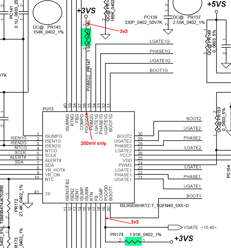

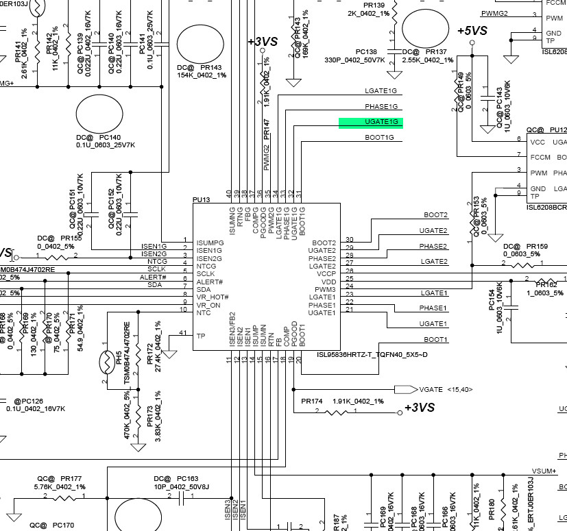

    Hi, I have 2 same bords for repair
    -On first one I founded shorted first fet and a shorted CAP to mail rail. I tought will be ok but there is missing +VGFX_CORE voltage. Same controler for +VGFX_CORE and +CPU_CORE
    +CPU_CORE is present on both phases. I found 15 Ohms on UGATE1G on controler that drive highside fet (on other board this pin is in kohms)
    Can be only this part of controler shorted internally?
    -second power led ok when press button VR_ON present but no +CPU_CORE
    First board take 28mA,what I think its much second board only 8mA,before pwrbtn pressed
    Any tips?
    See images, one for first other for second board

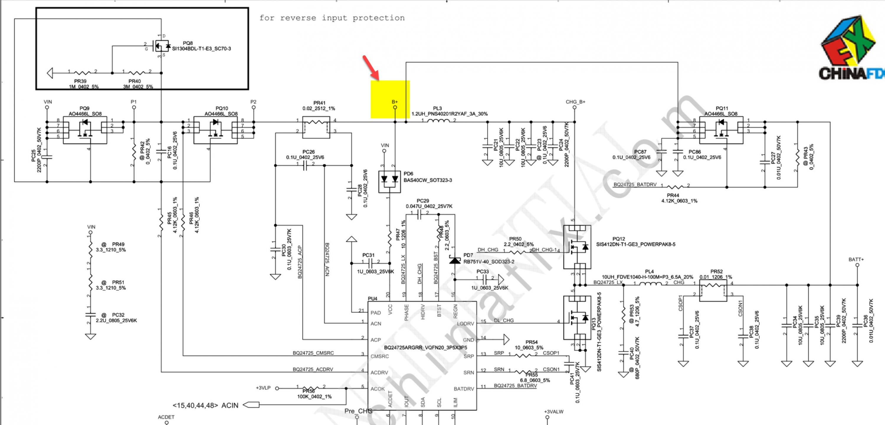

    Re: La-7912p
    Start with the voltage to ground of B+ main rail with the official and recommended power adapter.
    What is the measurement?
    • ziko07
      • Jun 2021
      • 99
      • Somewhere
      Re: La-7912p
      its, 19.2v (not have ori adapter) I use labaratory bench power
      Speak for second board, but firs also has 19v powe rail OK

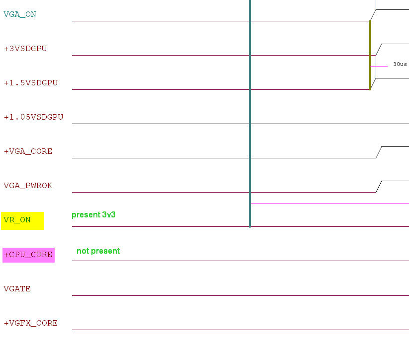

        Re: La-7912p
        is the Run Power sector work fine VS ? Link the schematic in the Schematic section

            Re: La-7912p
            There is PGOOD and PGOODG
            First is enable for CPU_CORE, second is for +VGFX_CORE
            As you can see from image on working cpu_core on both sides or resistor there is 3v3
            On not working PGOODG is 3v3 form one side of resistor only
            Resistance +VGFX_CORE to GND is 16 Ohms
            When board are powered take 650mA and I can see PCH getting hot and not have heat sink on it
            Also I put usb keyboard and no any light on keyboard, with both boards.
            5v is present on usb port

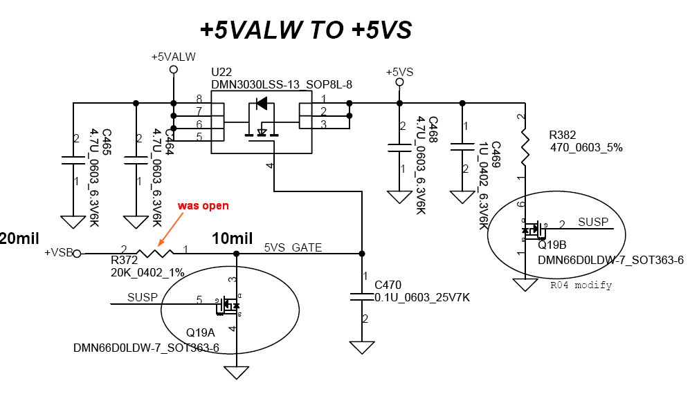

              I apologise for too many posts but I do car electronics, this is new for me.
              So,one board has shorted main rail, I fixed
              Second led comes ON but missed CPU_CORE voltage, I found open resistor because +5VS was missing, I fixed that too.
              Now....both boards fixed (were different problems) and both have no vgfx_core, so my final question is: is it possible because no screen connected? Because I doubt both boards now to have same problem after fixing other problems on them
              P.S. please see also above post, about no 3v3 on pgoodg line

                  If you have oscilloscope, Measure Upper gate and lower gate of Fets on VGFX rail. you can expect 20-24V on UG and 5V on LG(Just a rough idea and may differ from board to board).

                        Re: La-7912p
                        Tried with screen,hdd,hdmi and not work, no image
                        Also when insert usb keyboard caps lock is not light
                        On DIMM_DRAMRST# has 1.5v, shouldn't be half voltage 0.75v ?
