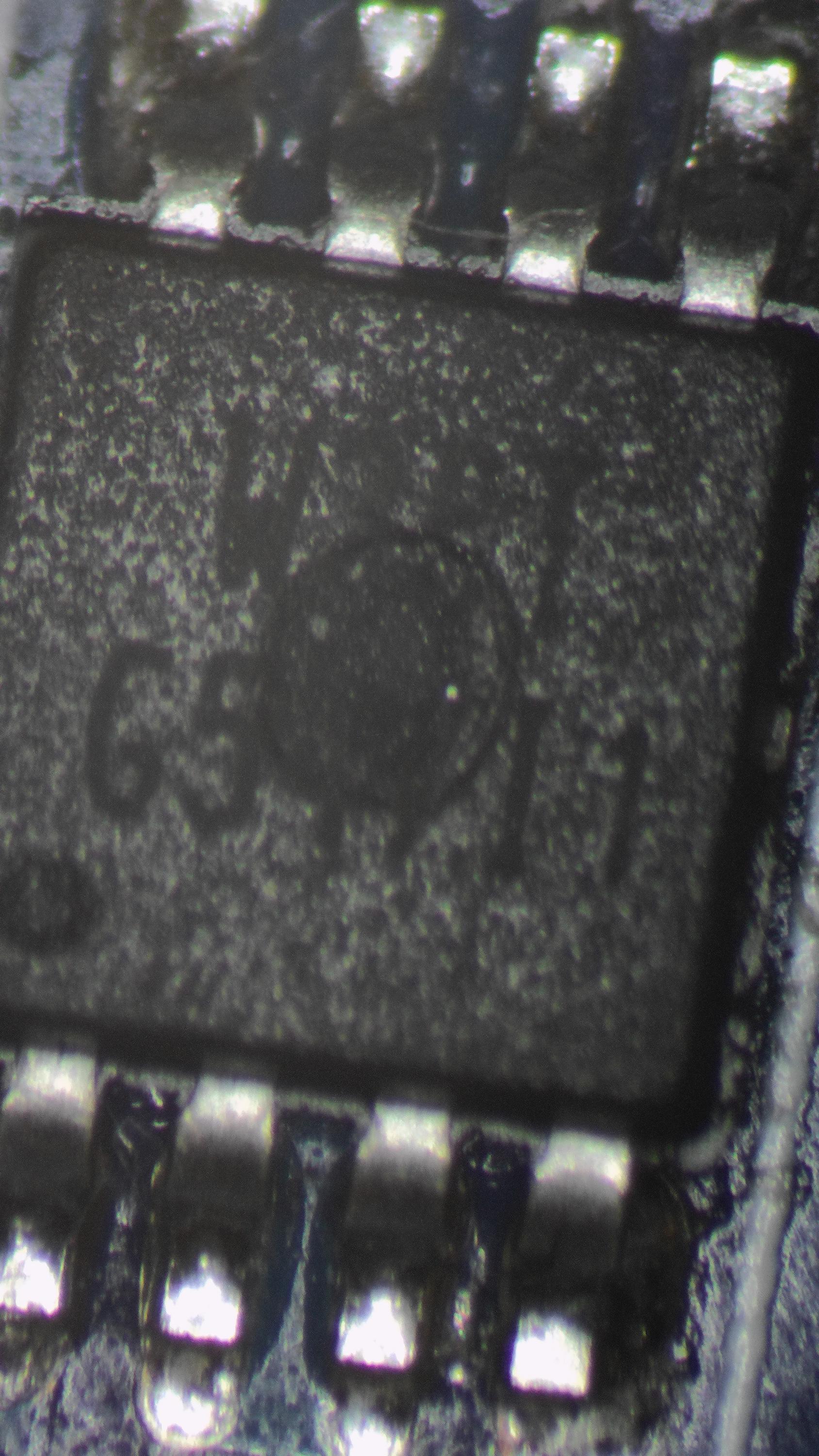

    Anyone know it is this the bios chip or someone other? It's burned. No available boardview or schematic for MSI MS-17F51.
    I checked the MSI MS-17F31 boardview and there is added the info "TSSOP8" for chips of this size.

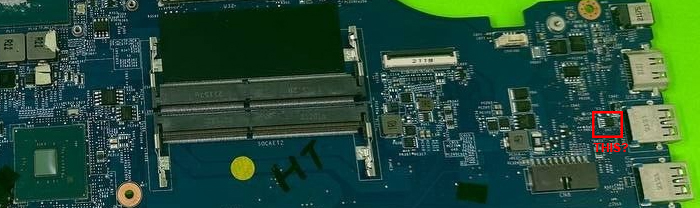

    Your BIOS chip is U37. It's located above and to the right of the PCH/Chipset (the big chip on the left side of your photo).
    If the chip in the first photo is the same chip as the chip in the 2nd photo, it looks to be a USB load switch.
    What problem are you running into exactly? Is the system not powering on? Not posting? USB ports not working?
    If that chip is burned I would take it off to start with.

      I removed that burned chip. I can replace to this any the tssop-8 USB load switch chip? Example. https://www.digikey.com/en/products/...4-1YMM/1028557

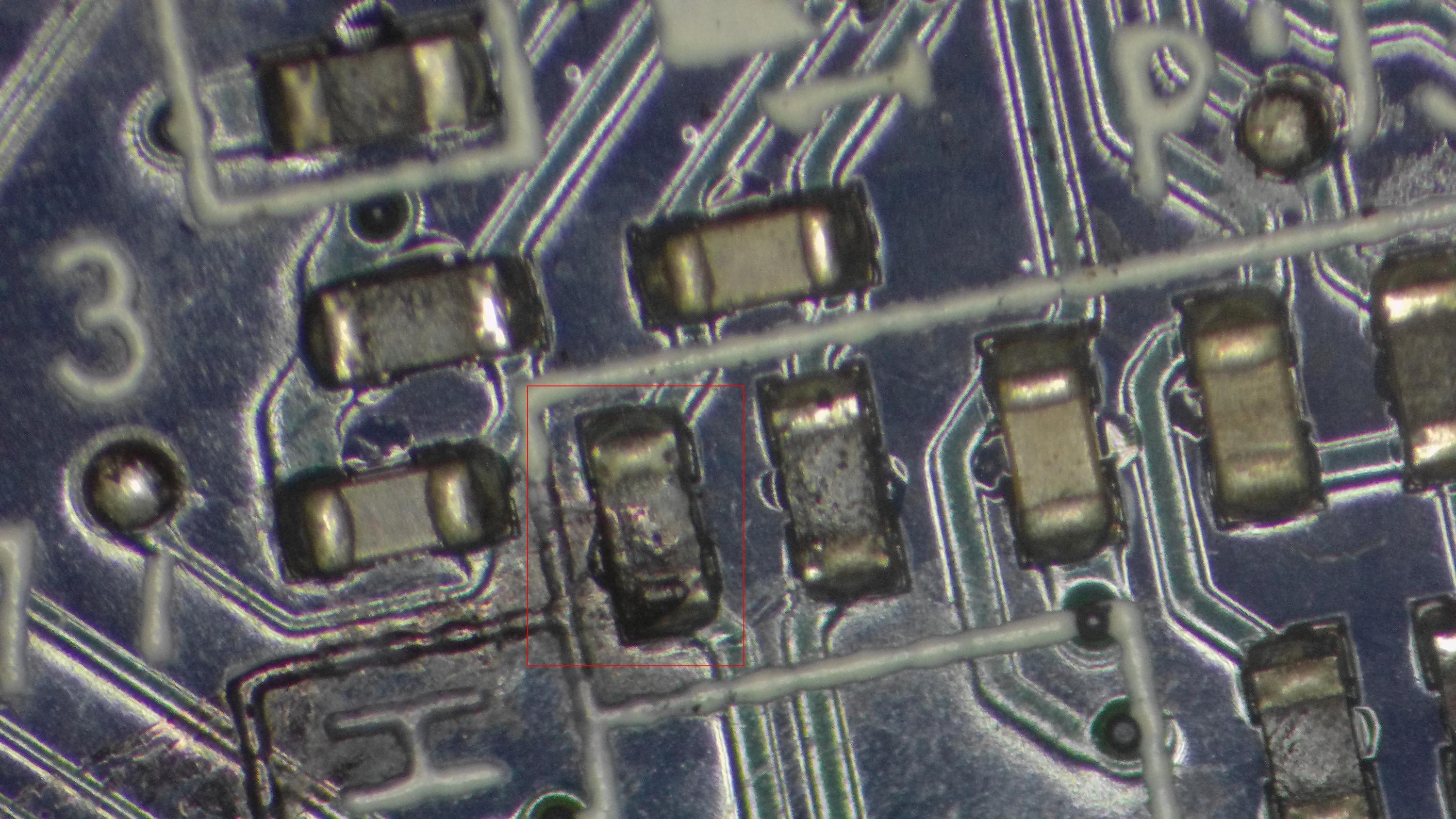

            I removed also the burned resistor (PR93). I can replace any resistor that looks like the same original resistor?

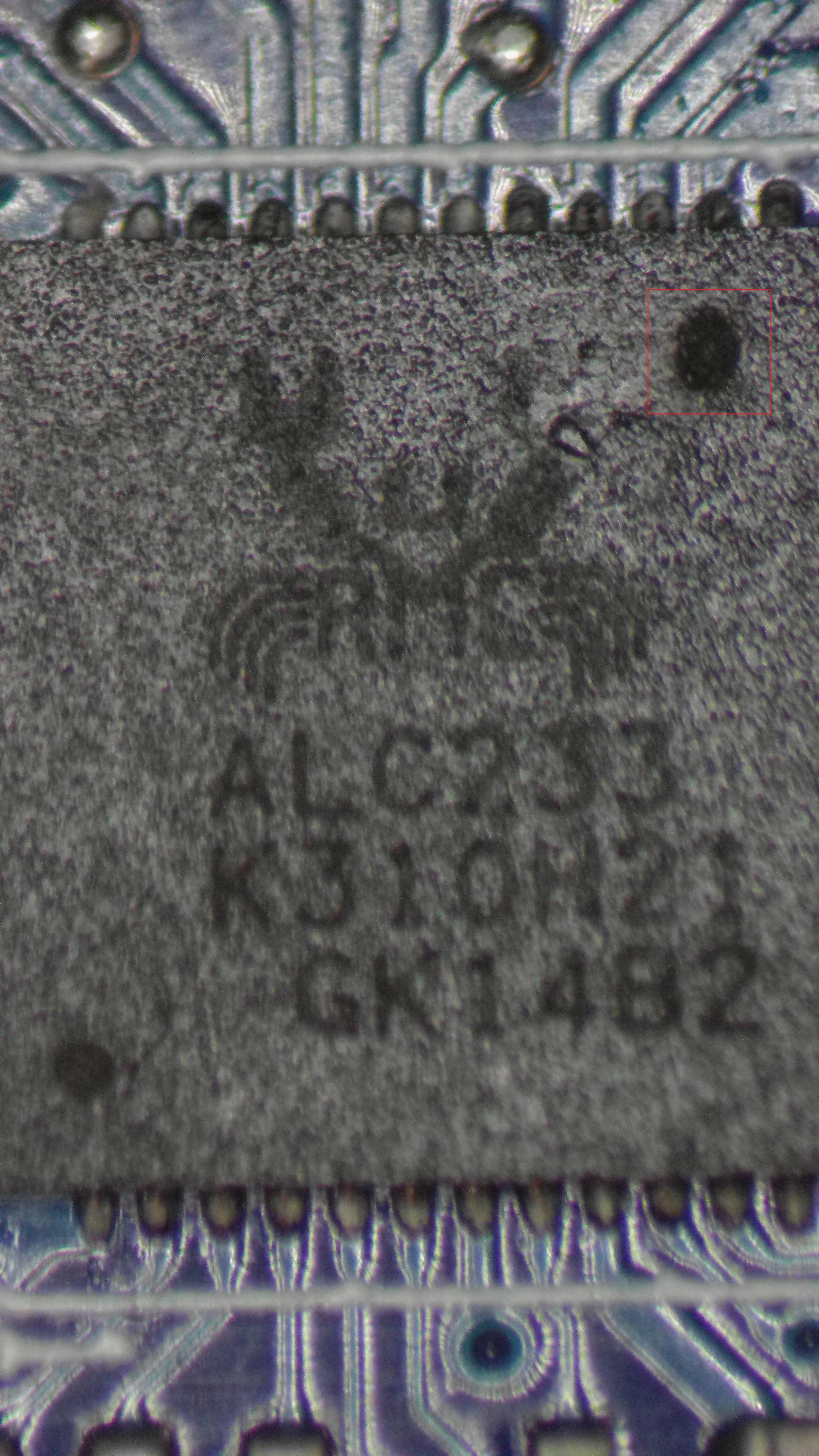

            It seems that the (U52) chip is also burned because there is a big black mark on it. Shorted capacitors around it C1226, C1240.

              I found what a chip this really is MSOP-8 G547I1. This not added to boardview MSI MS-17F31 because motherboard is little different than MSI MS-17F51. Anyone know, need to be programmed like this chips?
              • mon2
                • Dec 2019
                • 13950
                Re: MSI MS-17F51 Chip
                This USB load switch does not need programming. It is a fixed max current electronic fuse that will cut off the vbus power rail if the preset current threshold is exceeded. Will reset after the event is removed but often these devices get nuked in the event. More crapware.
