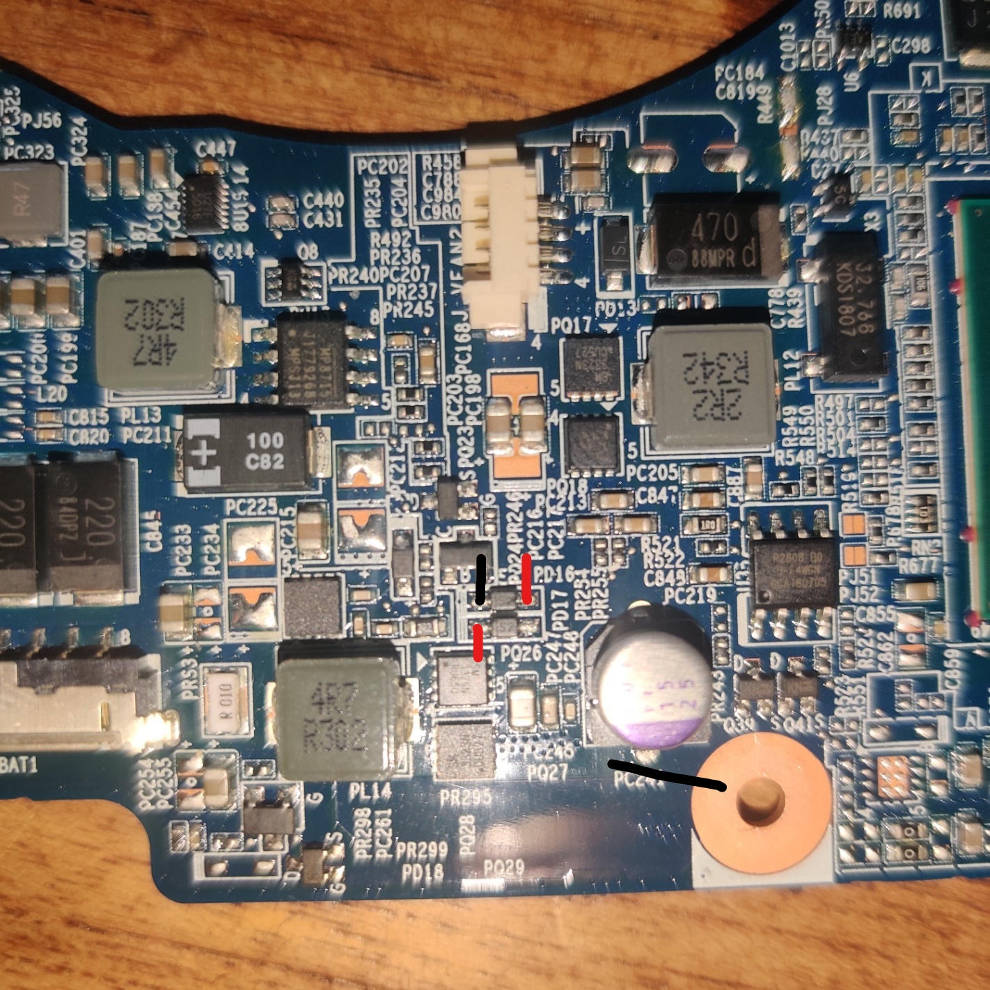

          thanks for your help/response. Attached is a picture of how i measured on PD16 and 17. in both directions and on both diodes there meter gives OL. When switching meter to resistance and measuring to ground the reading starts around 1.3Mohm and is increasing

            i made a stupid mistake PD16 = 0.605V and OL and PD17 = 0.610V and OL
            • mon2
              • Dec 2019
              • 14662
              Re: BTO/CLEVO P950ER repair help needed
              Connect the power adapter and then carefully measure the voltage to ground of each pin on pd16. Post the measurements.

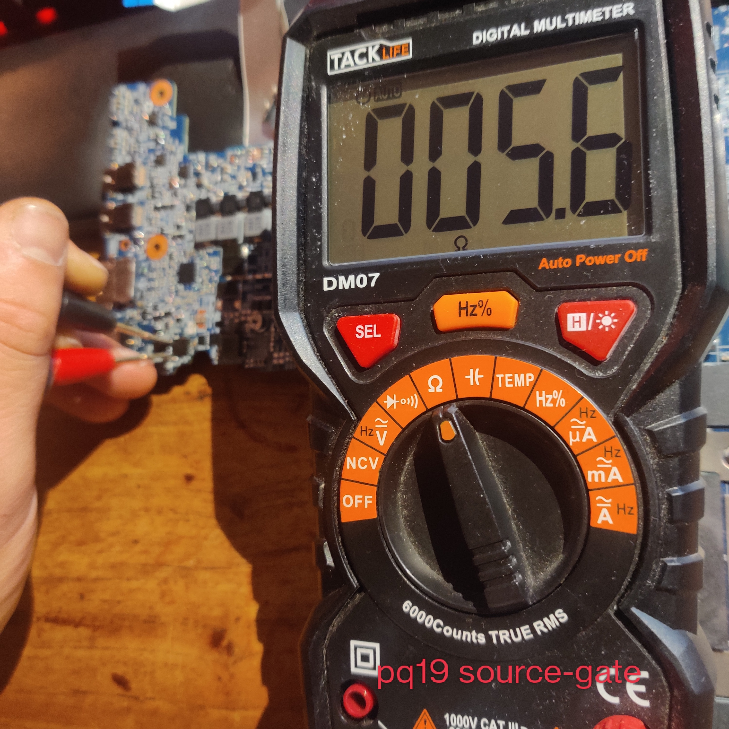

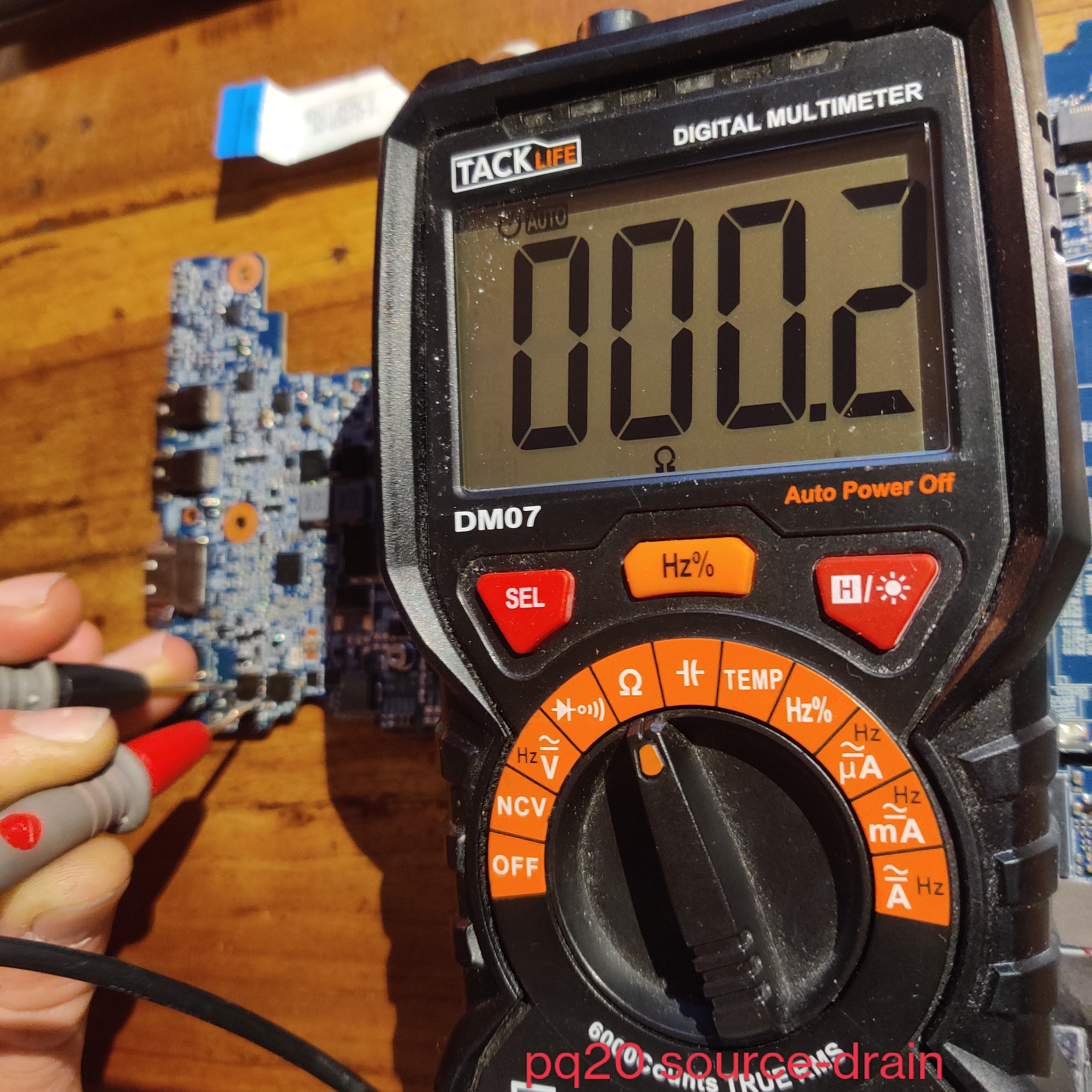

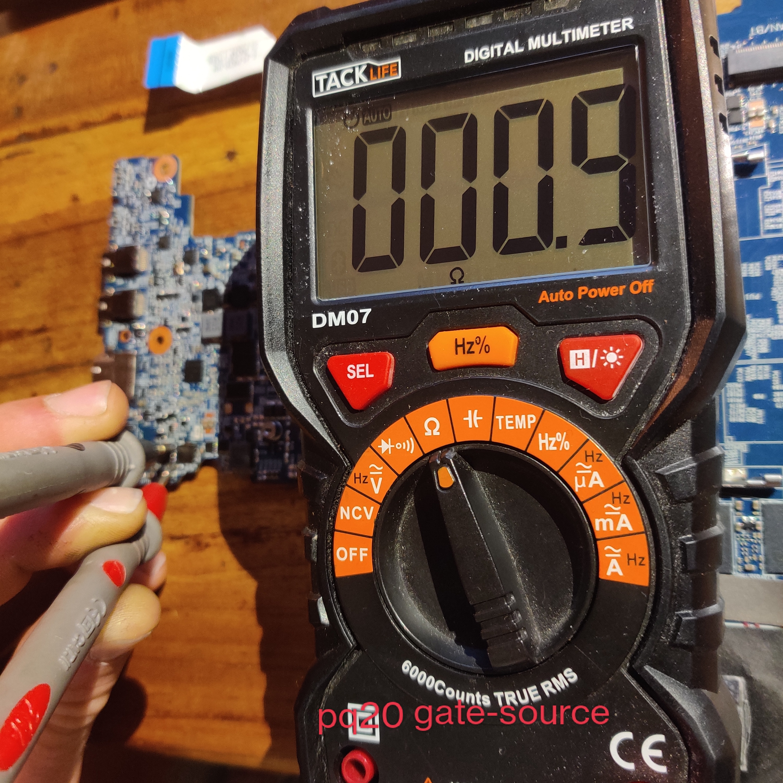

                              I replaced PQ20 still the same problems in regards to Voltage. PQ19 was still getting hot so just to be sure i also replaced that one. here are the new measurements in diode mode tested
                              PQ19:
                              source (1-2-3) & drain (5-6-7-8) = OL
                              source (1-2-3) & gate (4) = 5.7 OHM
                              gate (4) & drain (5-6-7-8) = OL
                              drain to ground = 3.5 ohm
                              PQ20:
                              source (1-2-3) & drain (5-6-7-8) = 0.3ohm
                              source (1-2-3) & gate (4) = 1 ohm
                              gate (4) & drain (5-6-7-8) = 1.2 ohm
                              drain to ground = OL
                              • mon2
                                • Dec 2019
                                • 14662

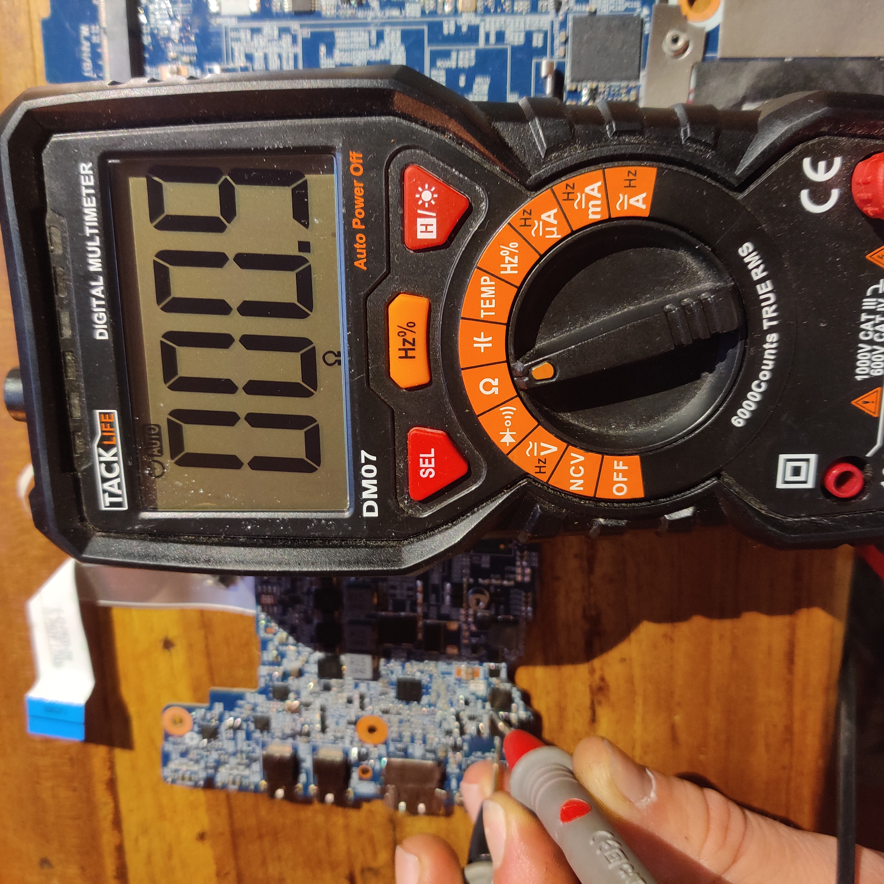

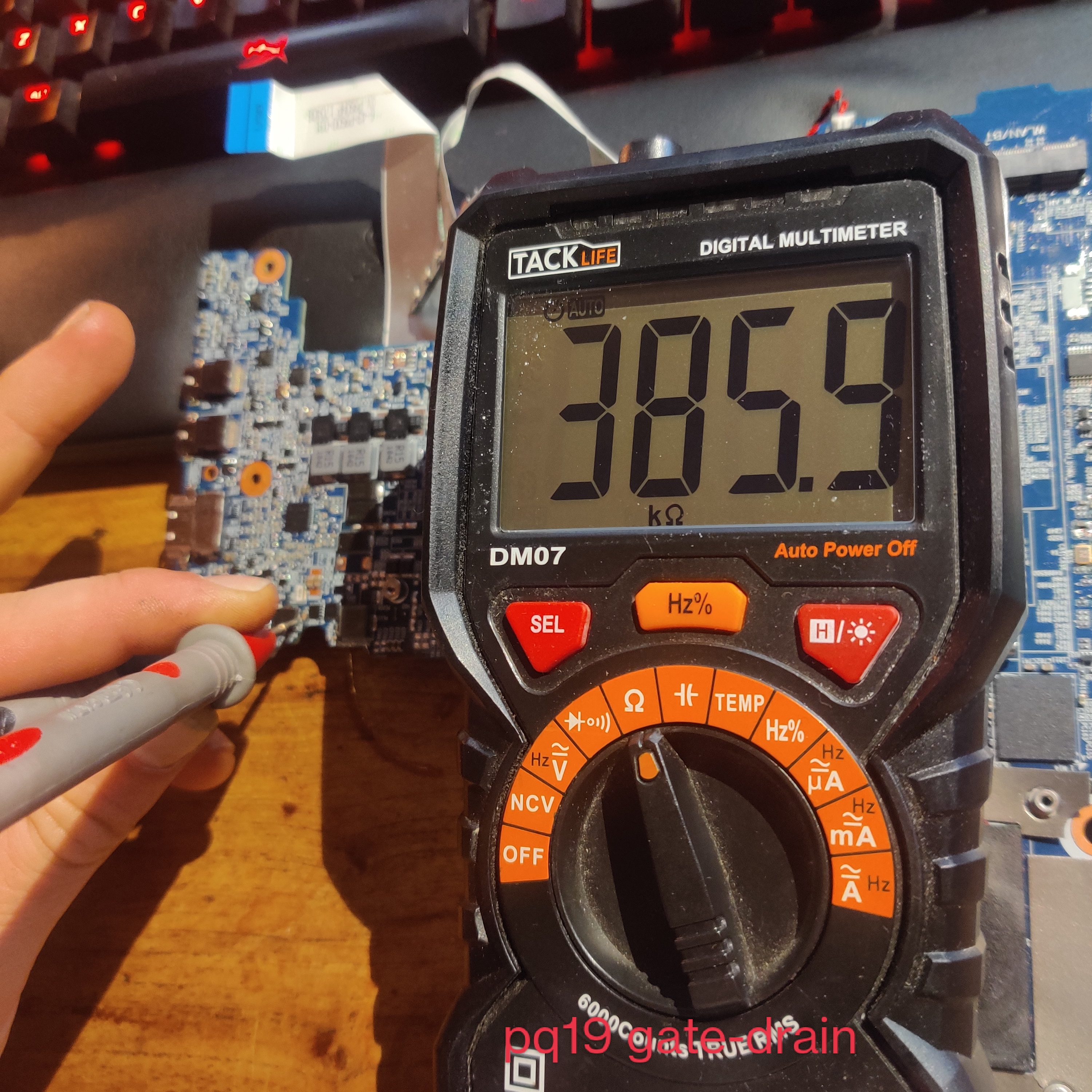

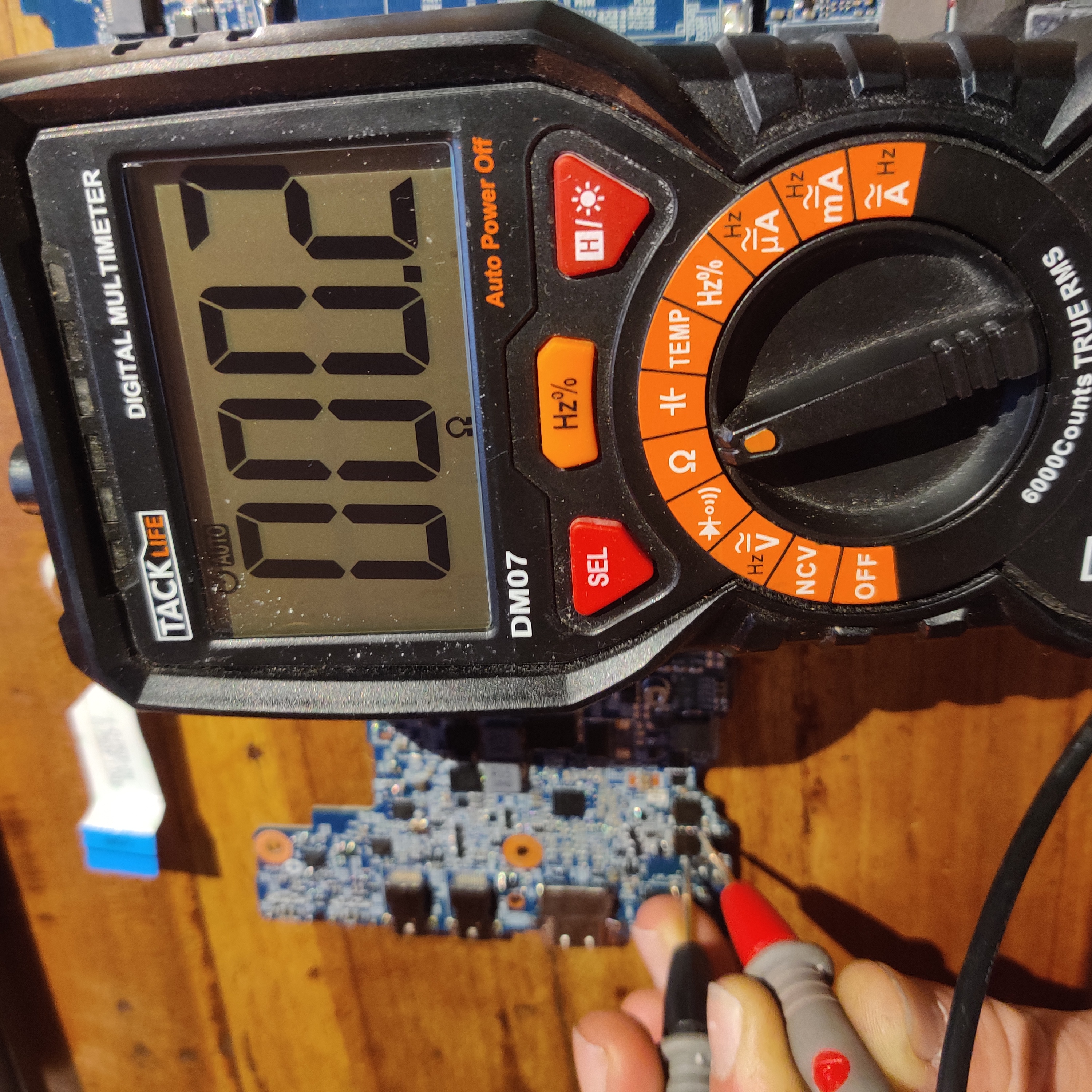

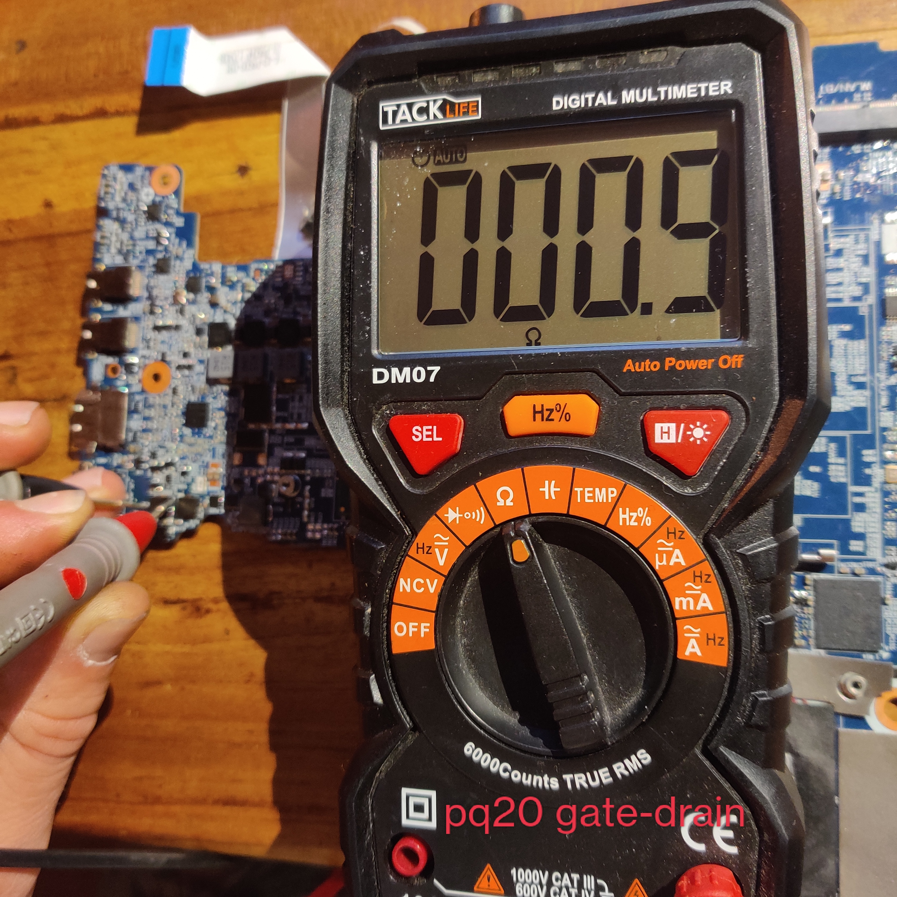

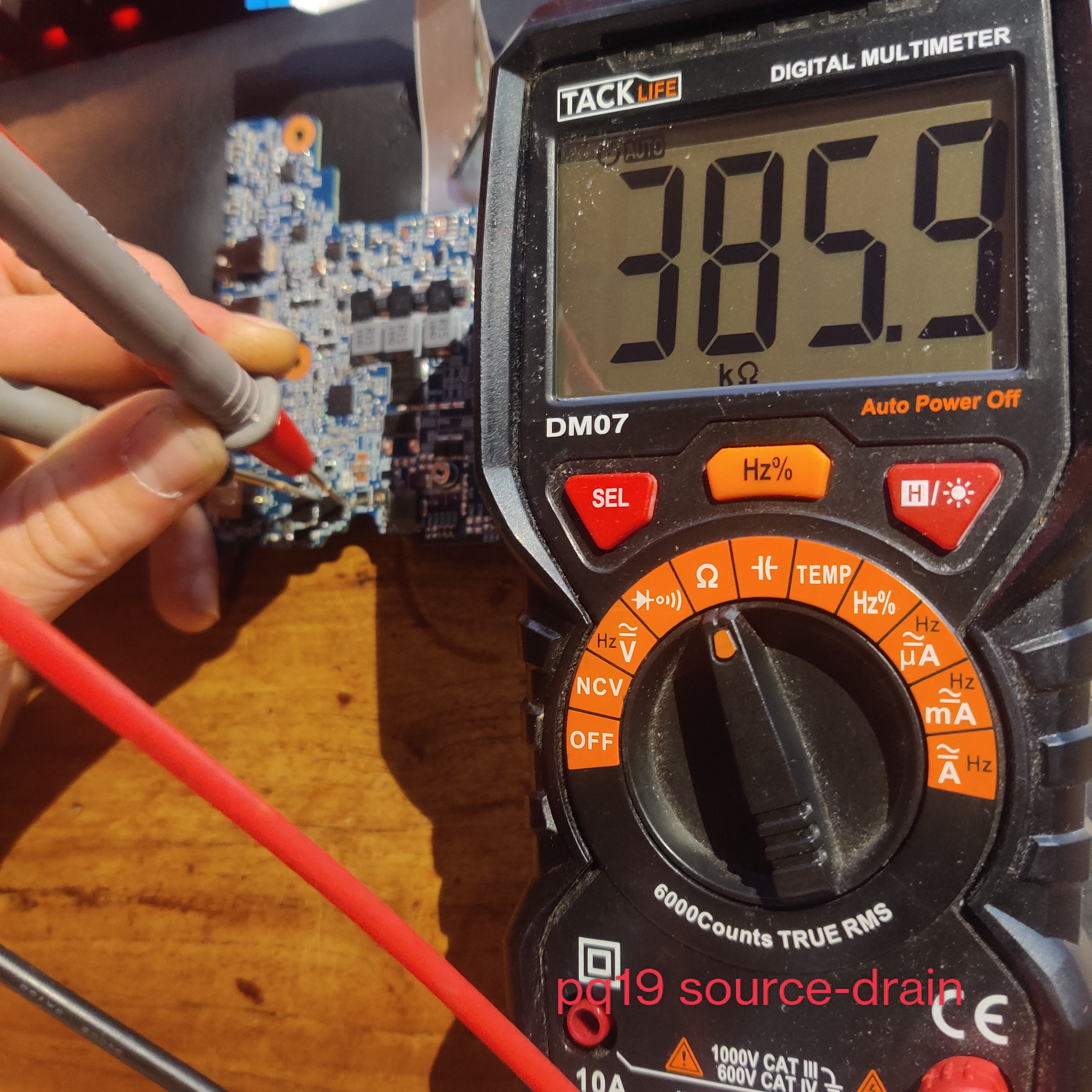

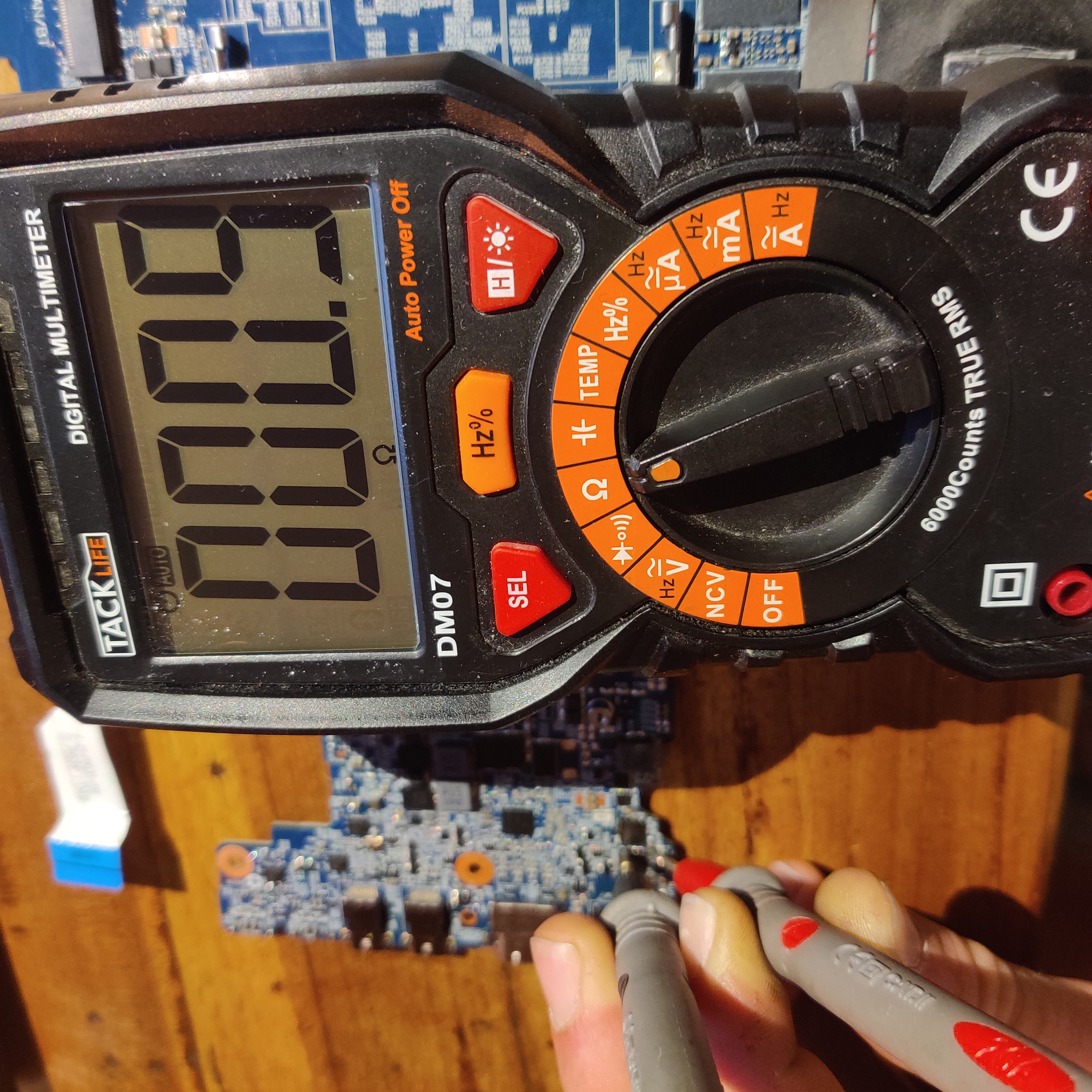

                                These are very low resistance readings or the meter is in a different scale. Can you confirm the resistance scale on your meter used for these tests? Better if you post a pic of the meter face.
                                • revex666
                                  • Dec 2021
                                  • 18
                                  • netherlands
                                  Hearby the pictures
                                  • mon2
                                    • Dec 2019
                                    • 14662
                                    These are low readings. Suggest to flux well and remove the mosfet. Wait till the mosfet is cool and then test the mosfet while it is off the logic board. If you see similar measurements then the mosfet is defective. Then measure the other mosfet without this one installed on the board. If you see low resistance on the other mosfet, then it too should be fluxed and removed to isolate the root cause of these low readings.
