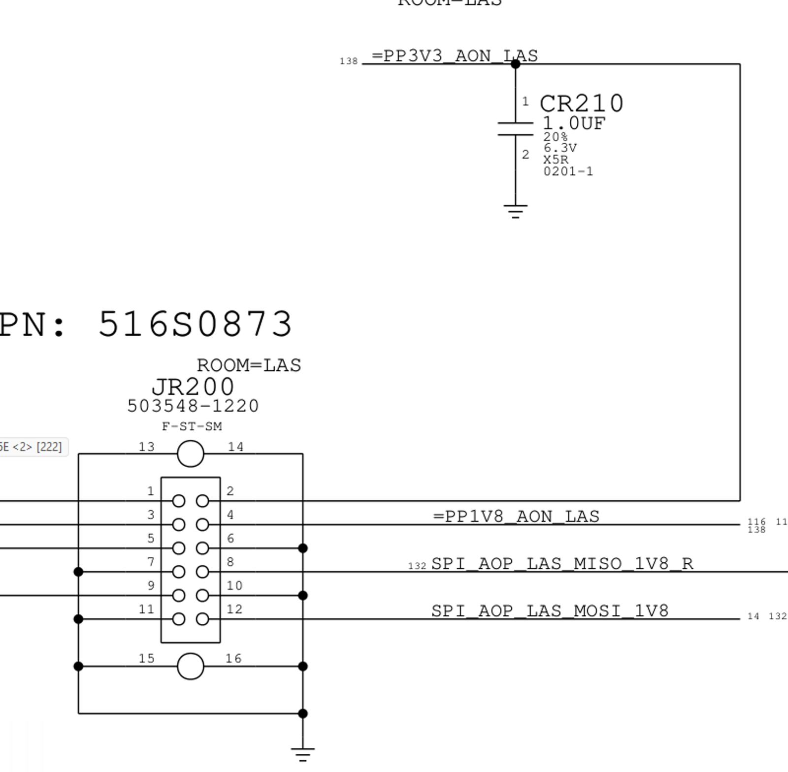

    just an FYI - just recently had an 820-02382-a in the shop - liquid damage - the area seems to be where this may be a common issue - wanted to note that the current boardview doesn't show the component that was corroded. and since i could not identify it with the boardview, i couldn't located the values on the schematic. but i went around it a different way.
    it was a capacitor located near U5660 - i pulled it then connected a wire to the line side. flipped the board and tested the connector JR200 on the flip side - turns out pin2 rang out. i was then able to head over to the schematic and looked up JR200 and it showed connected to CR210 0201 1.0uf 6.3v.
    found a replacement off of 820-00165 C5620 but i'm sure there are options elsewhere on the same board or other boards.
    hope this helps someone save some time.
