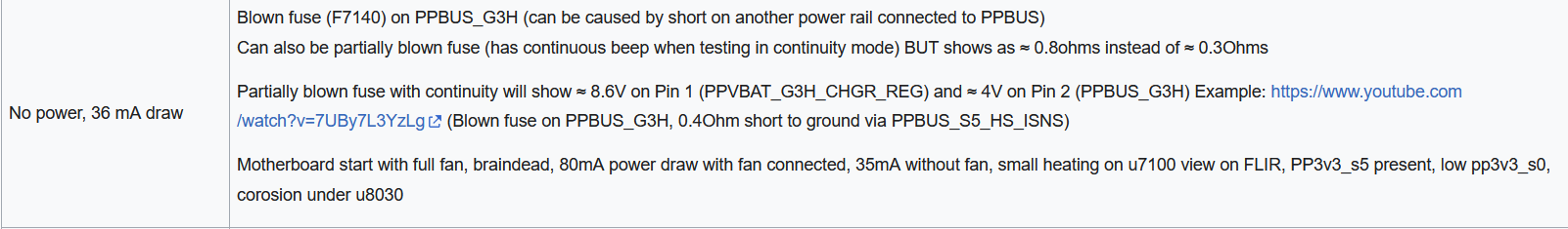

            • mon2
              • Dec 2019
              • 14086
              Re: 820-00165 Magsafe Blinking
              Remove the battery and test again.
              What is the voltage of PPBUS_G3H? Is it stable or turns OFF / ON in a cycle?
              Is PP3V42_G3H stable?
              Voltage of each pin on D7005 ?
              Tested with another known good power adapter?
              Update:
              From:
              https://repair.wiki/w/A1466_2015-201...9D_MacBook_Air

                  i went through this. PPBUS_G3H is a has reading .101 (Meter in 2k Mode).
                  • Instafixx
                    • Jul 2022
                    • 374
                    • India
                    [UPDATE]
                    PM_BATLOW_L is always 3.3V Checked at R1410 without the Battery.
                    Replaced R1410 but still the same. Is the Q3000 Mosfet that is causing this issue?
                    • mon2
                      • Dec 2019
                      • 14086
                      101 ohms to ground resistance? That is too low.
                      Remove the fuse on this rail and check this resistance to ground again on BOTH sides of the removed fuse PCB pads.
                      Post the measurements.

                        • mon2
                          • Dec 2019
                          • 14086
                          These are still low readings for both measurements.
                          Suggest to verify the measurements with another meter and be sure the meter is in resistance mode, use black on ground.
                          If the values remain about the same, then check for any liquid damage in this area. Clean and remove with alcohol on a cotton swab. Confirm again the fuse is removed as this will isolate this rail.
                          Do you have a thermal camera? If yes, power up and check on who heats up in this area. Is it a cap before the fuse?
                          The downstream after the fuse (consumer side) is also a low resistance but study the up stream, producer side of this power rail for the root cause.
