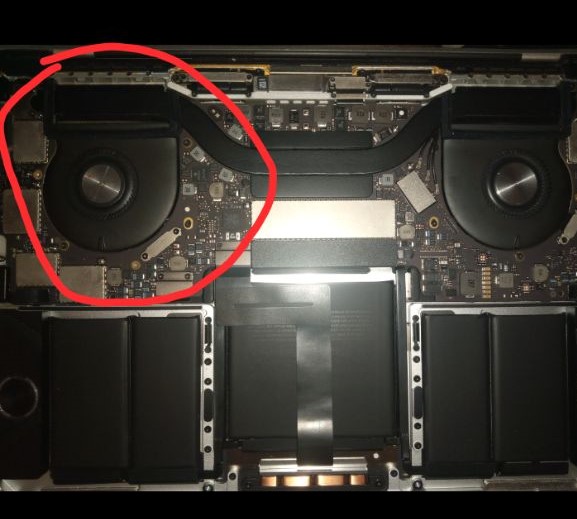

    Hi, I have this Macbook Pro A1706 [820-00239] with an abnormal fan spin [or quarter fan spin according to LOUIS ROSSMANN]. The laptop boots up normally and performs normally besides the fan's sound which only starts to happen when the laptop starts getting warm as a result of it being used.
    I have replaced fan, reset SMC and PRAM, reinstalled different MacOS versions but same problem. It is the LEFT FAN.
    Any idea what could be the cause and solution for it

    In case anyone is having a similar problem as this, I later got it fixed by replacing the keyboard

      replace U5860/U5850 or Q6000/Q6050 I fixed that before

        Okay, I will check and replace it. Thanks for the swift reply. I will report back my findings. Thanks again
