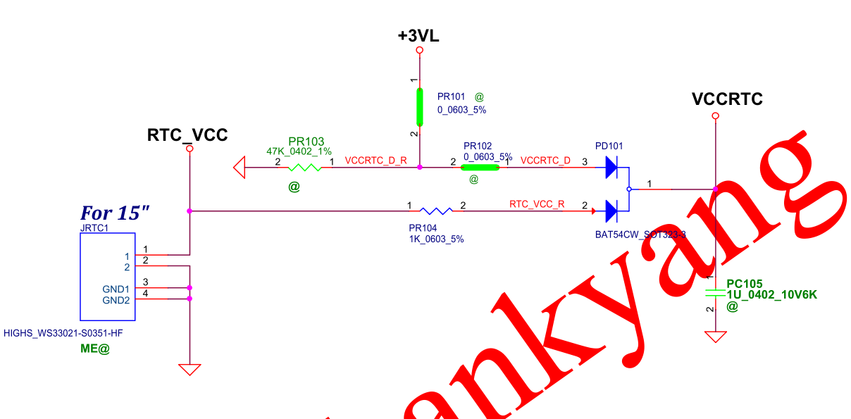

    Have motherboard nm-c371 gives display without RTC and no power on with RTC battery attached .no shorting in RTC section vccrtc 3 v
    Pchrtcrst 3v
    Pchsrtcrst is 3v
    Plz help solving this problem

    Review the attached section of the logic board.
    Review the voltage to ground on the dual diodes - pins 1, 2 and 3.
    Attach with RTC battery; and also measure without RTC battery.

      With RTC attached pin no 1 -3v. Pin no2 -3v and pin no 3 -0v
      When RTC is removed and powered on pin 1 and 3 - 3v and pin no 2 -0v

        Nothing wrong here. If boardview is available, then search "RTC" as keyword in schematic and measure each and every point of RTC circuit. Without boardview its herculian task though.

          Please confirm, +3VL is missing with CMOS attached present, with CMOS removed? Do you have checked the diode in diode mode for sanity?

            Thanks everyone after changing pd101 the voltage is same on all pins but the problem has been solved.
