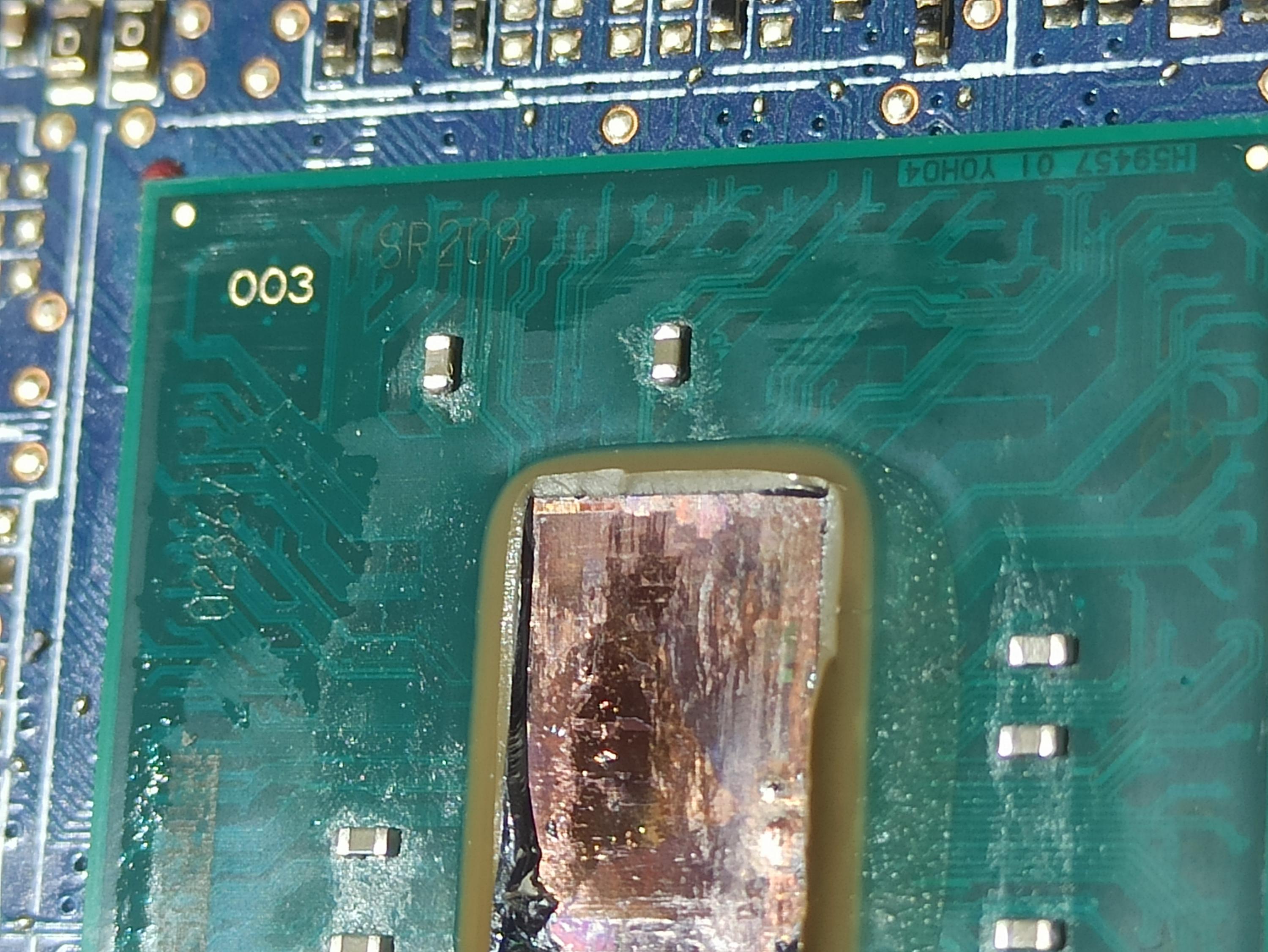

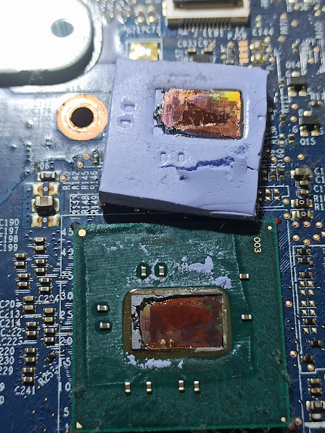

    Helo.
    Have this CLEVO P751DM and i found blown chipset. cannot determine what chip it is, to replace it. Marking is only 02867. it have socket with desktop cpu i7-6700K

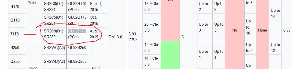

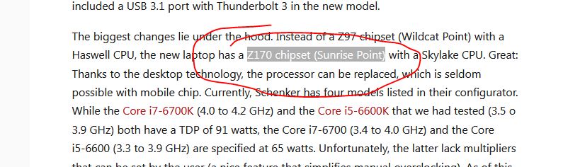

    GL82Z170 possibly ?
    https://www.notebookcheck.net/Schenk....151283.0.html
    https://en.wikipedia.org/wiki/List_of_Intel_chipsets

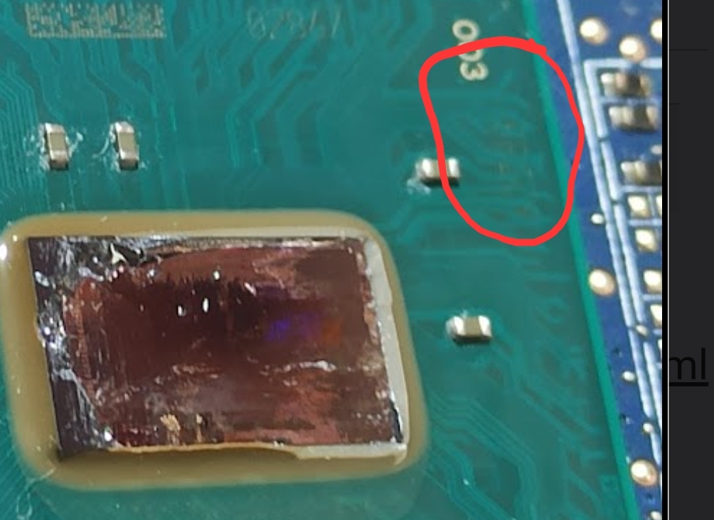

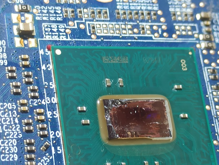

        Re: CLEVO P751DM - BLOWN unknown chipset
        These PCHs are all printed the same way. You just have to look here. I can already notice some letters.

          thanks mate. it is bearly wisible but it have marking SR209. but i find only SR2C4. do u think it is interchangable?
          • dellxps15
            • Feb 2014
            • 1588
            • italy
            it's available on aliexpress
            edit: it's the same as sr2c9 as one seller has both code in the list on aliexpress
