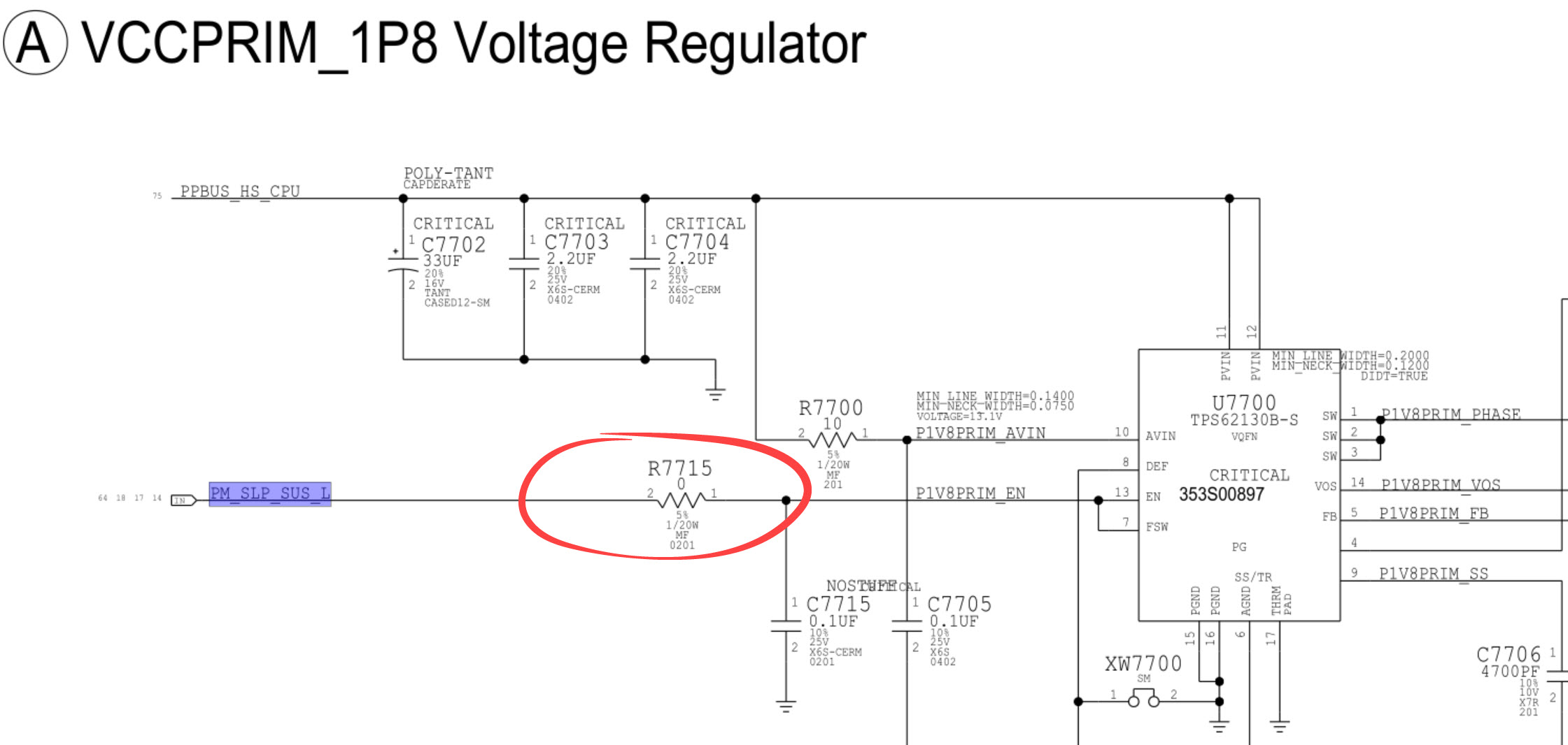

        Re: Macbook Air 13 2020 A2179 820-01958 partial power
        I've noticed that PM_SLP_SUS_L is fluctuating less than 2V, and RES to GND is not 100K like on the working board but only 60K. I have replaced U7700, RES to GND is OK, now fluctuating up to 3.3V but always not steady (maybe bad soldered, 3 years I have not practiced )
        • mon2
          • Dec 2019
          • 14259
          Carefully remove R7715 and see if the PM_SLP_SUS_L signal returns to a stable 3v3 level.
          • toinounet21
            • Jun 2023
            • 12
            • France
            I tried with U7700 removed, I think it's even better, right? same oscillating value
