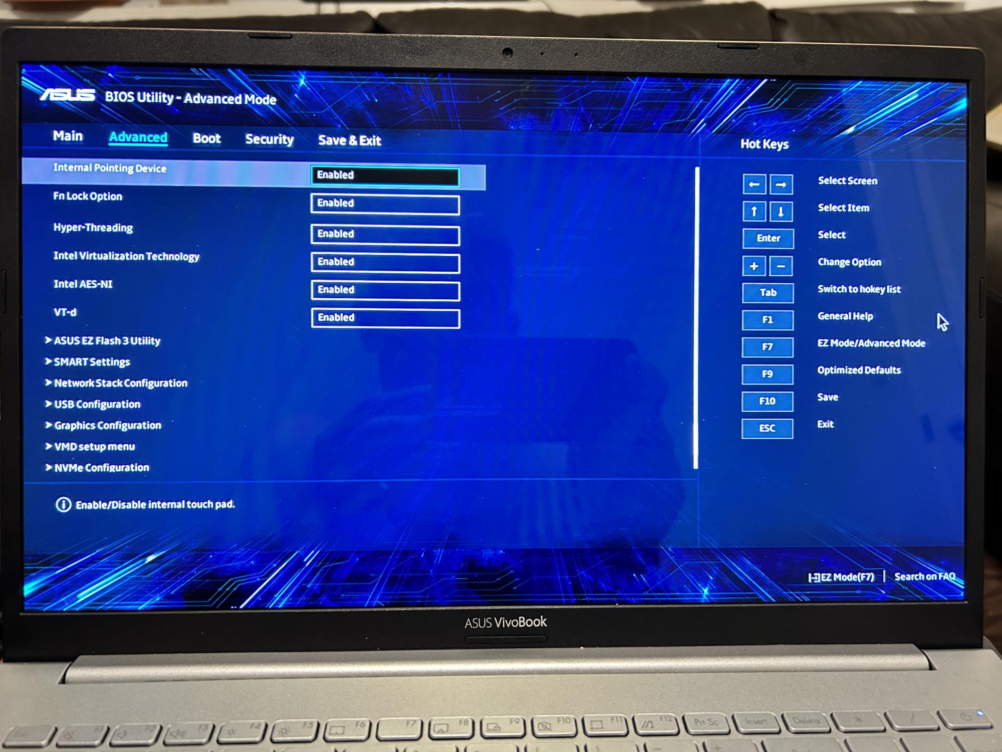

    Re: Asus Vivobook K513E Intel I5 11th gen 16Gb ram
    try to disable cpu cores in bios if u can, i got recently one laptop working with one core disabled and symptoms were random bsods when entering windows or windows installation
    • tehmatix
      • Nov 2012
      • 177
      I don't see any options to disable CPU cores
      • swammyw
        • Apr 2021
        • 66
        • finland
        you have to find key combination or flash unlocked bios to unlock all bios options

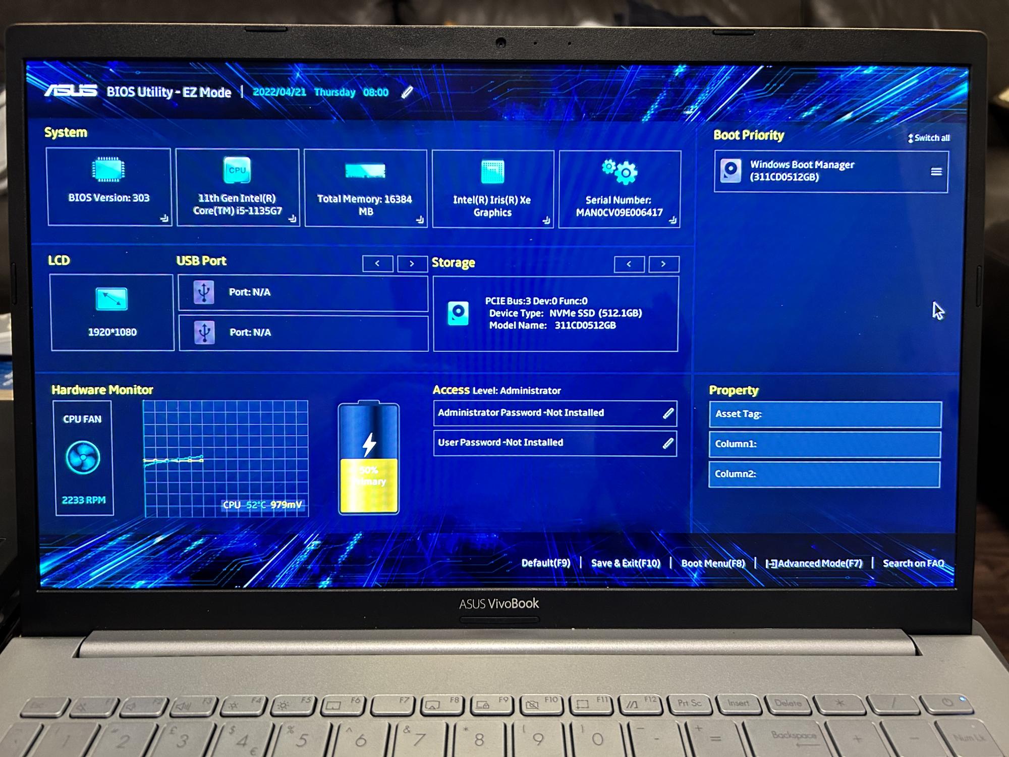

          Asus vivobook k513e bios request
          by TOMÁŠ
          Device:laptop
          Brand: asus
          Model: vivobook k513e
          Motherboard: x513ea
          SN: M5N0CV20H570216
          Hi, I have problem with asus vivobook k513e. Came to with no pictures I found dump and flashed in to it, was working but did not see in bios ssd, so found another bios file now I can see ssd but laptop lagging evenin bios, also i opened hex editor and change serial number, maybe i did something?
          sometimes not usable so i think its need beter bios, maybe fixing original or brand new but i don't know how to make it. Please can someone help me with this. Thanks for your help...
