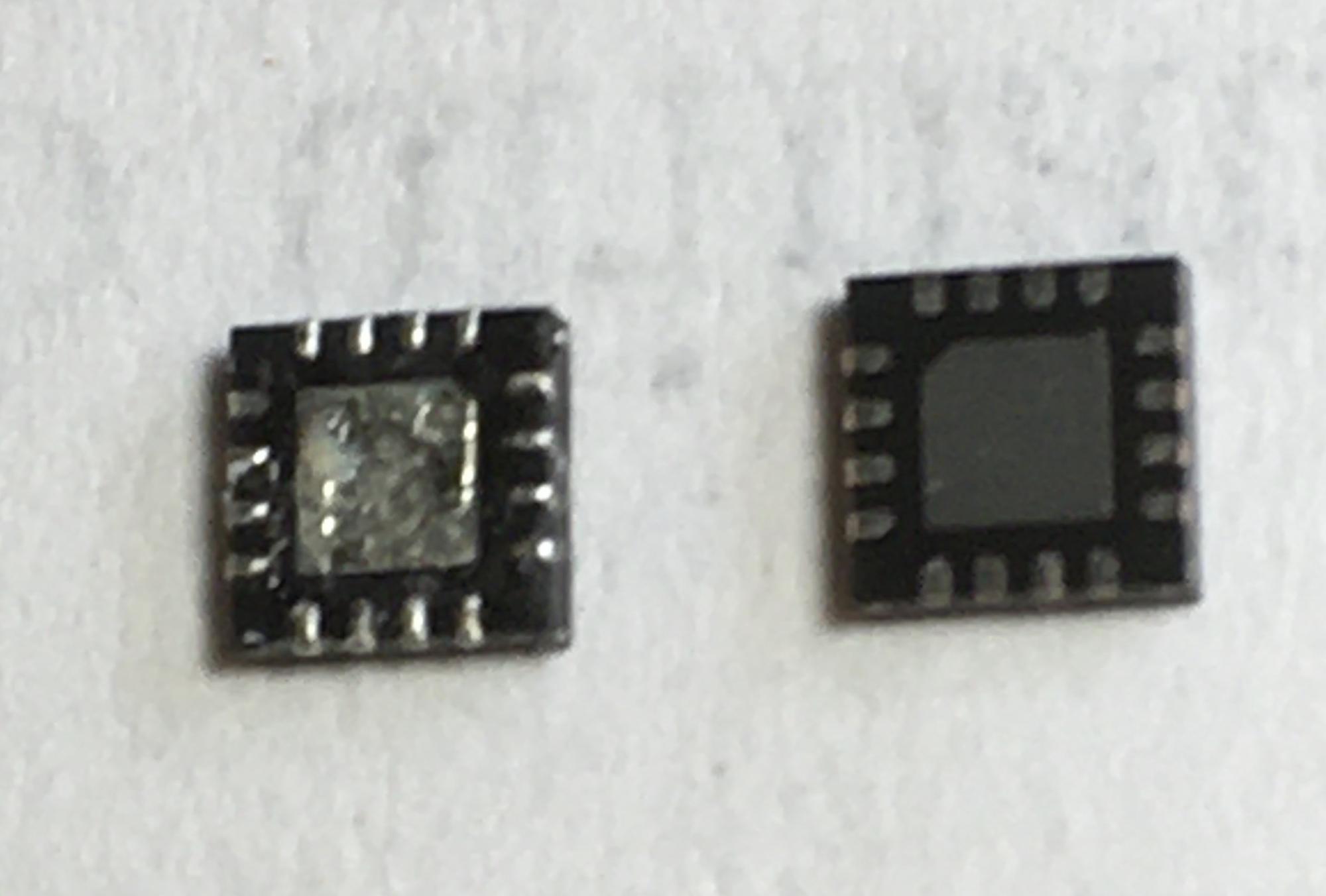

            Re: Lenovo Yoga 7i blown USB port issue

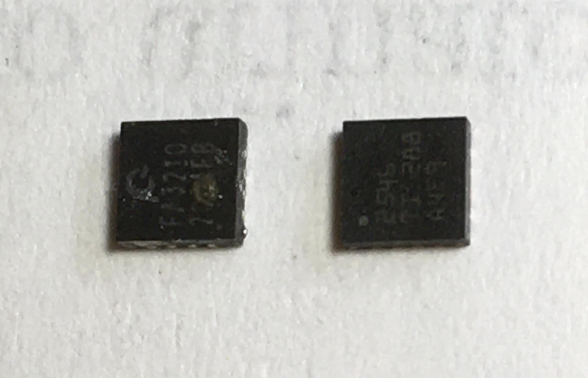

            The c2546 by TI is cited in the search engine under the alias of the other part number. Appears to be a jelly bean USB current limited and BC1.2 charger IC.
            New Original SN1702001RTER printing C2546 2546 WQFN-16
            https://a.aliexpress.com/_mrW1Eek
            Can you post pics of the PCB pads without the IC where this chip was soldered?
            Then again with the ic placed on the PCB pads. Do not solder it back but place onto the pads. Just wanting to confirm that pin #1 on the ic was aligned with pin #1 on the PCB pads.
            Would you still have the original SN1702001RTER part that was on this board? If yes, post a pic of this original part with the bottom side pads of the ic pins showing to allow for a review.

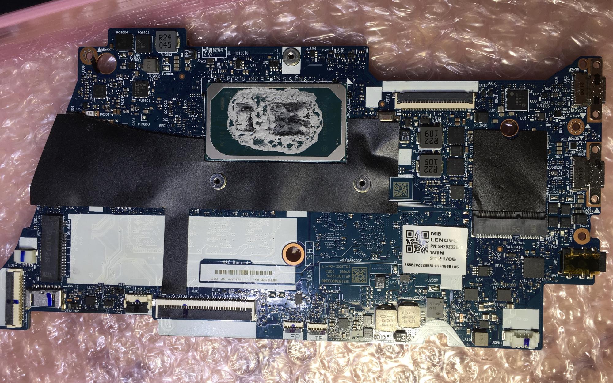

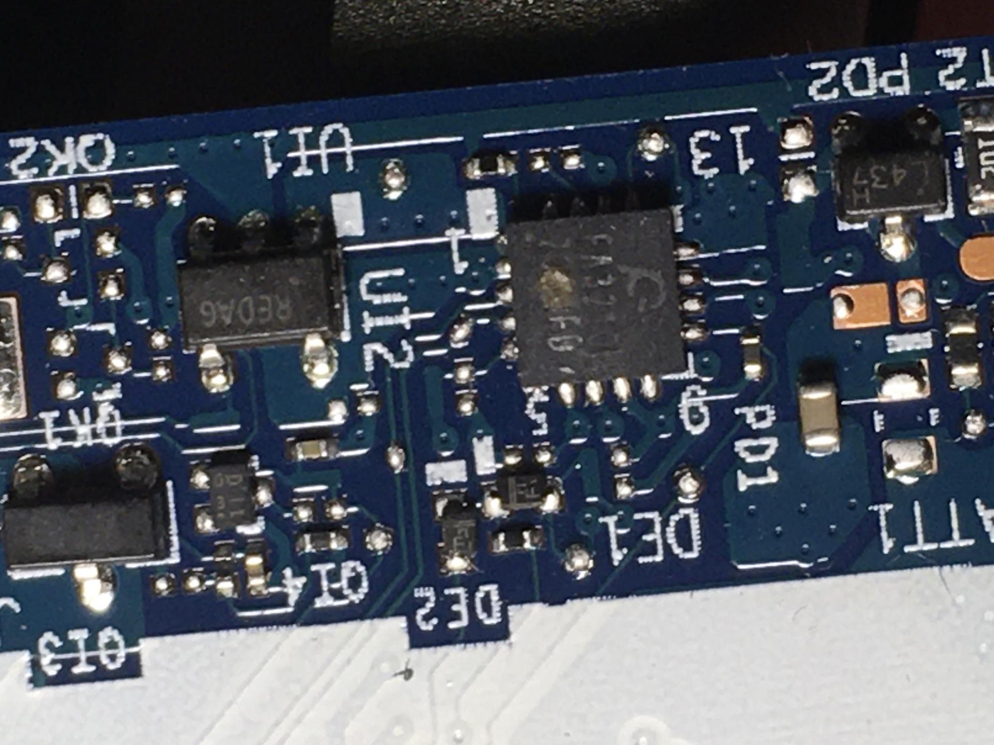

              Thanks Mon2 and Sephir0th for your suggestions. I'll upload the pictures in my next post,
              As I mentioned, I'm not experienced at component level repair like this. But Mon2, you brought up a good thing to check - where is PIN1 on both the new and original chip? I soldered the new chip with the label on the chip pointing in the same direction as the original one - that appears to be a rookie mistake. Comparing both the new, I find the ground plate on the bottom has a corner missing indicating PIN1. But the missing corner on both the original and new chip do not match! So I now understand I installed the new chip with the wrong orientation.
              Here's what's confusing: I have the same identical problem with the old chip (correct orientation) and the new chip (wrong orientation) - 1 of the USB ports not working and constant errors in Windows related to surges on the USB port. But when the chip is removed, the errors are gone.
              Should I install the 2546 chip with the correct PIN1 alignment and see what happens? Or am I correct there is still some kind of problem elsewhere?

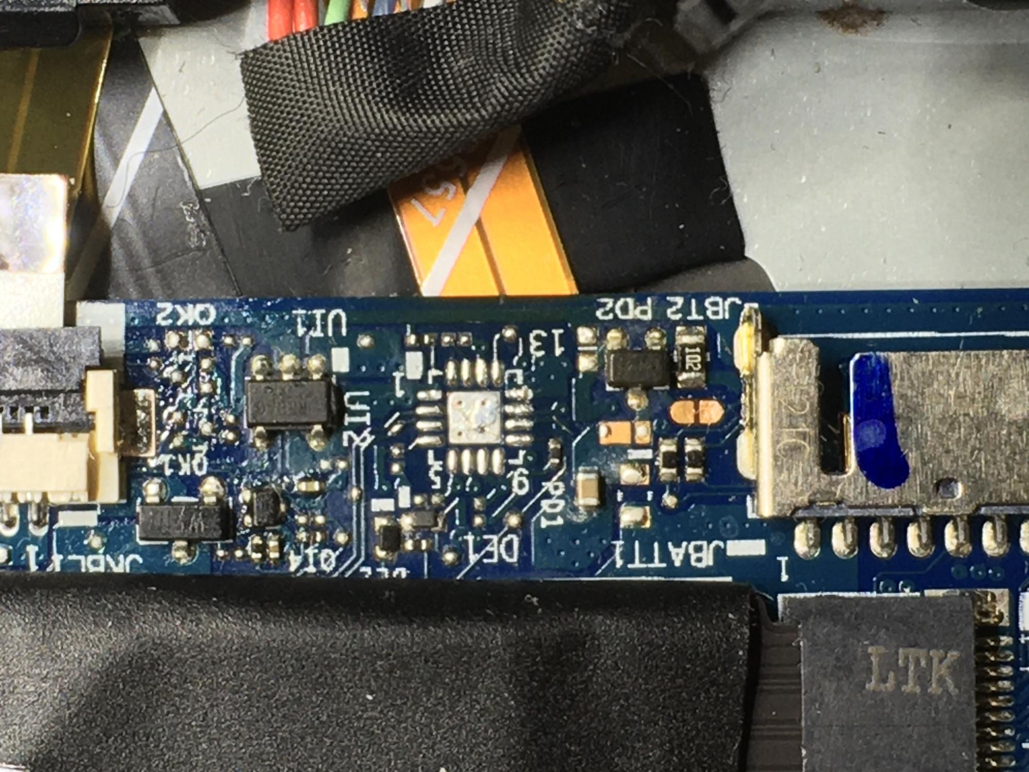

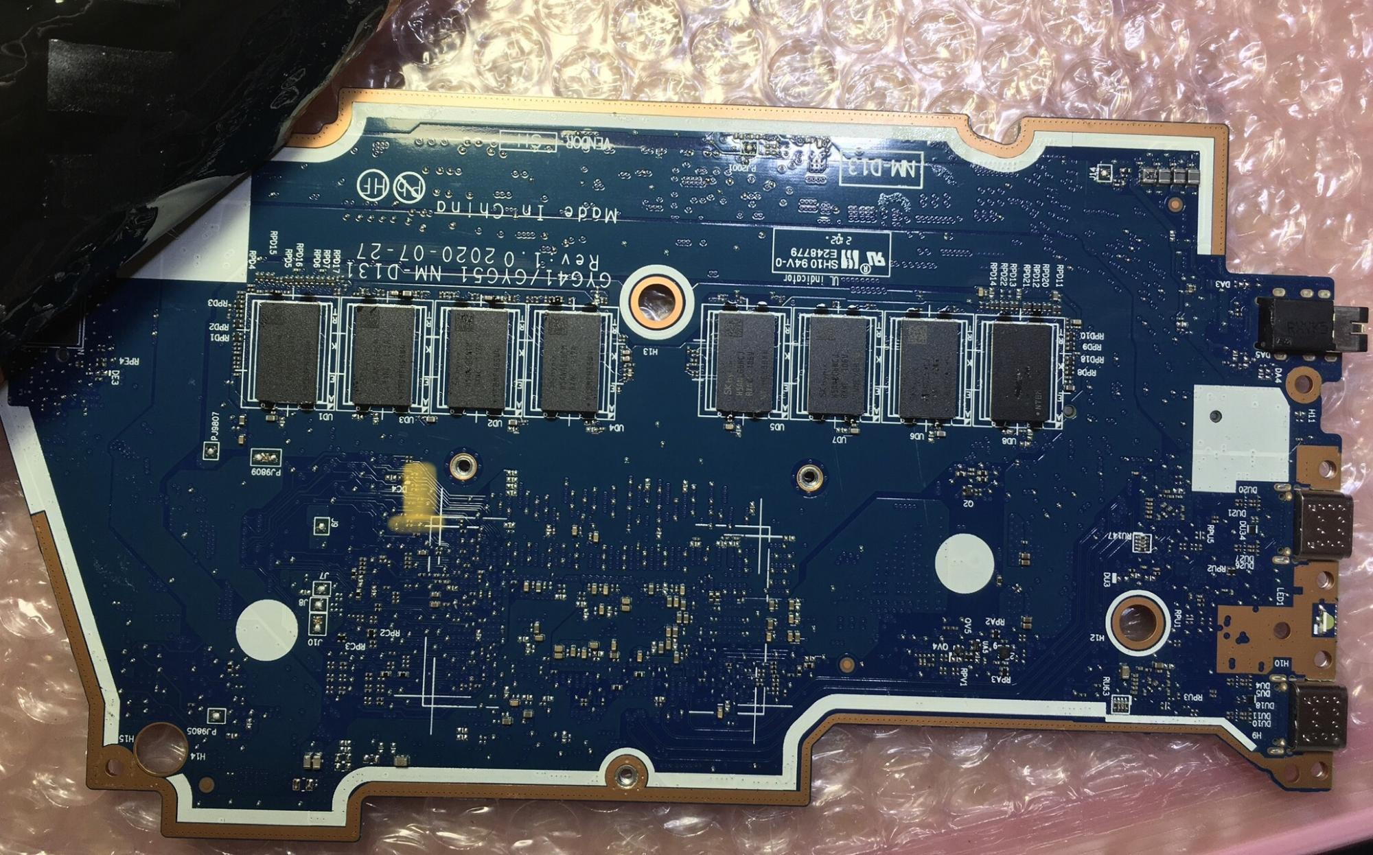

                Here are the requested pictures:
                1) Original and new chip side by side - top and bottom. (see my previous post - Chip label orientation and ground plate corner indicating Pin1 are different between both chips)
                2) Original chip installed on the motherboard
                3) both sides of the motherboard.
                4) Picture of area with the chip removed
                • Sephir0th
                  • Oct 2020
                  • 1289
                  See what magic can happen just from a few pictures shared.
                  Install the IC with the correct orientation. If still not working you need to order a replacement to rule out you have burned the IC by this mistake. And from there we can proceed then.
                    Sephir0th, When I ordered the chip from Digikey, I ordered 2 - so I have a spare. I'll solder a new (untouched) chip properly aligned to Pin1. I'll let you know how it goes!
                    • Rolin
                      • Apr 2007
                      • 174
                      #30
                      Mon2 and Sephir0th, I truly appreciate your help and patience with me on this. In the end, it was my own mistake that caused this thread to continue needlessly.
                      I soldered the new TPS2546 correctly aligned to PIN1 this time (now that I know to check the ground plate on bottom of chip indicating PIN1). Everything works now - no more USB errors and all 4 ports work again - including the bad port from the original problem.
                      Again, I can't thank you both enough!

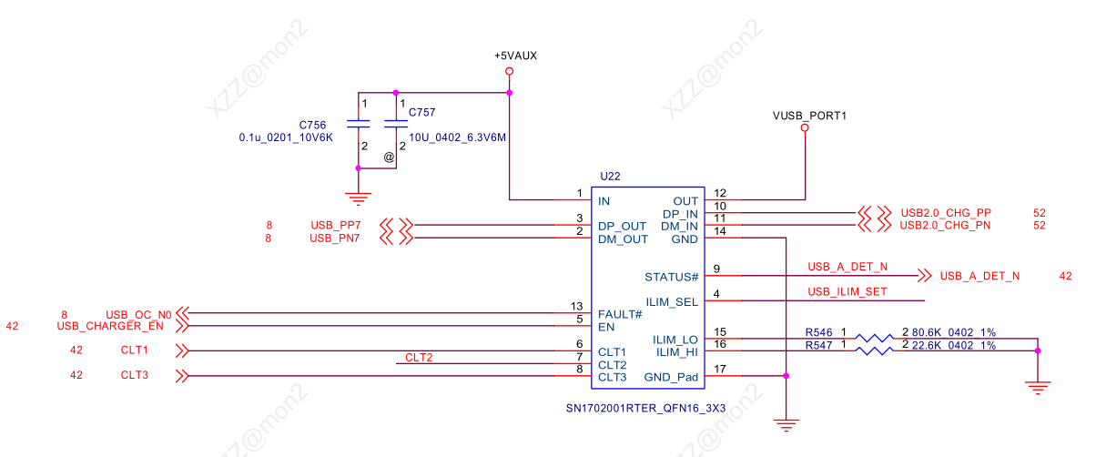

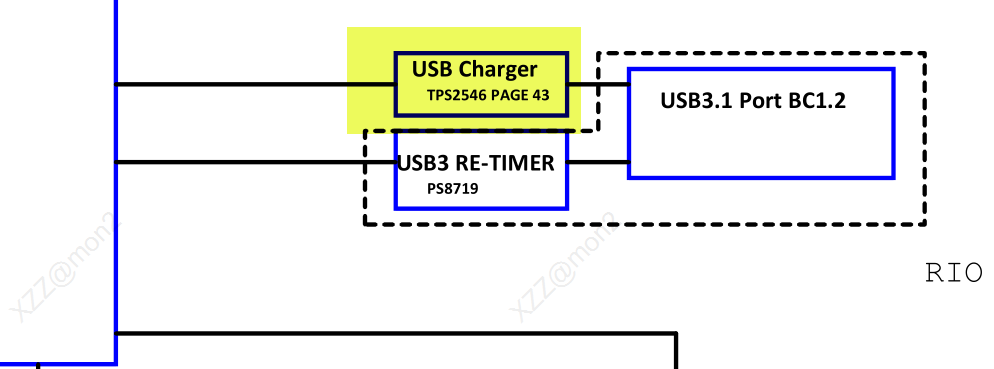

                                  Unable to locate the schematics in my database so searched for 'FA3210' and found this webpage:
                                  FA3210, USB Charging Controller and Power Switch with Load Detection, MQFN3x3mm2-16L, USB 3.0 port source controller of Lenovo YOGA 7 14ITL5 - Total Electronics
                                  This webpage notes the part is used on 'Lenovo YOGA 7 14ITL5' -> have a schematic for this one and schematic references indeed, the 'TPS2546'.
                                  Summary: Should be ok to use the TPS2546 here. Update this thread with your progress.
