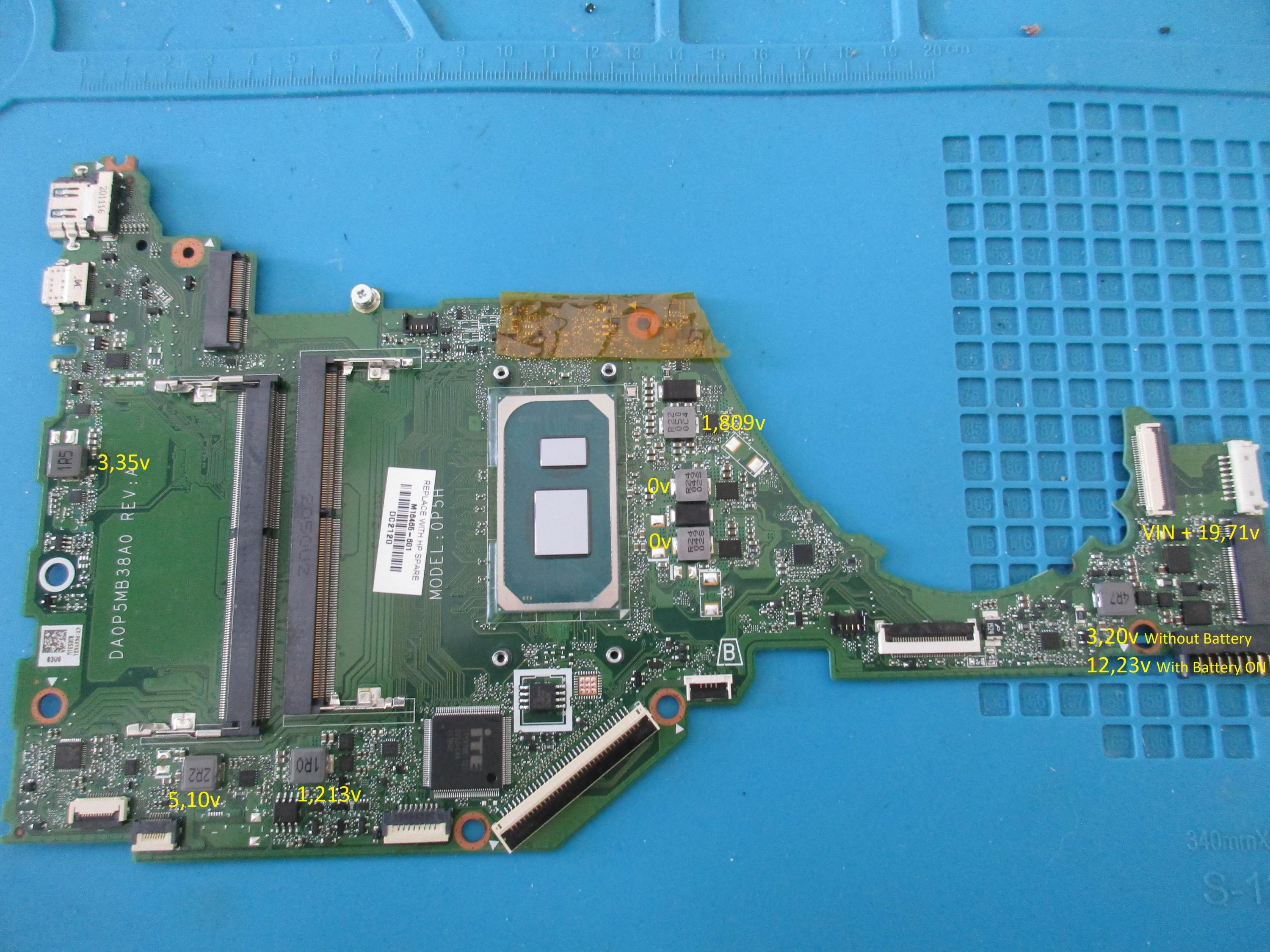

    Hi there, I have an hp 15S-fq2006np that had some liquid damage. After cleaning and replaced some resistors and capacitors, the laptop returned to life.
    Worked fine. Fresh Thermal paste, ran some stress tests. Prime95 ran for 6 hours straight. Everything seemed ok.
    After a couple of hours costumer was playing a game and suddendly the screen went off. Now pressing power button, the power light comes on, all voltages are present but no fan spin, and nothing on screen
    CPU doesn't get warm. Changed ram sticks also, but still the same.
    Could it be a messed bios? He said nothing was updated.
    Motherboard DA0P5MB38A0 REV:A
    Best Regards

    If the CPU doesn't get warm then you're usually missing voltages, so please double check your measurements and even better share them here in relation to the various power rails.

      It will be liquid damage you have missed most likely. With the laptop in use, any deterioration from corrosion is accelerated. Did you inspect the board under a microscope? You may also have some crap under a BGA etc. Ultrasonic?

        Here are the voltages. Check attached picture
        No BGA was affected

          Your CPU isn't powered at all, as already assumed. The 1.8V there are for the PCH FIVR. Measure resistance to GND there and check the Enable for the VRM Controller

            Resistance to ground in the Coil with 1,80v is 208,7 ohms, the other two have 55,7ohms
            PWM controller is an Intersil 95860HRTZ, cant find Datasheet anywhere

                This Motherboard is OP5H, pwm controller is not the same

                    To my knowledge there is no schematic or boardview for this motherboard yet
