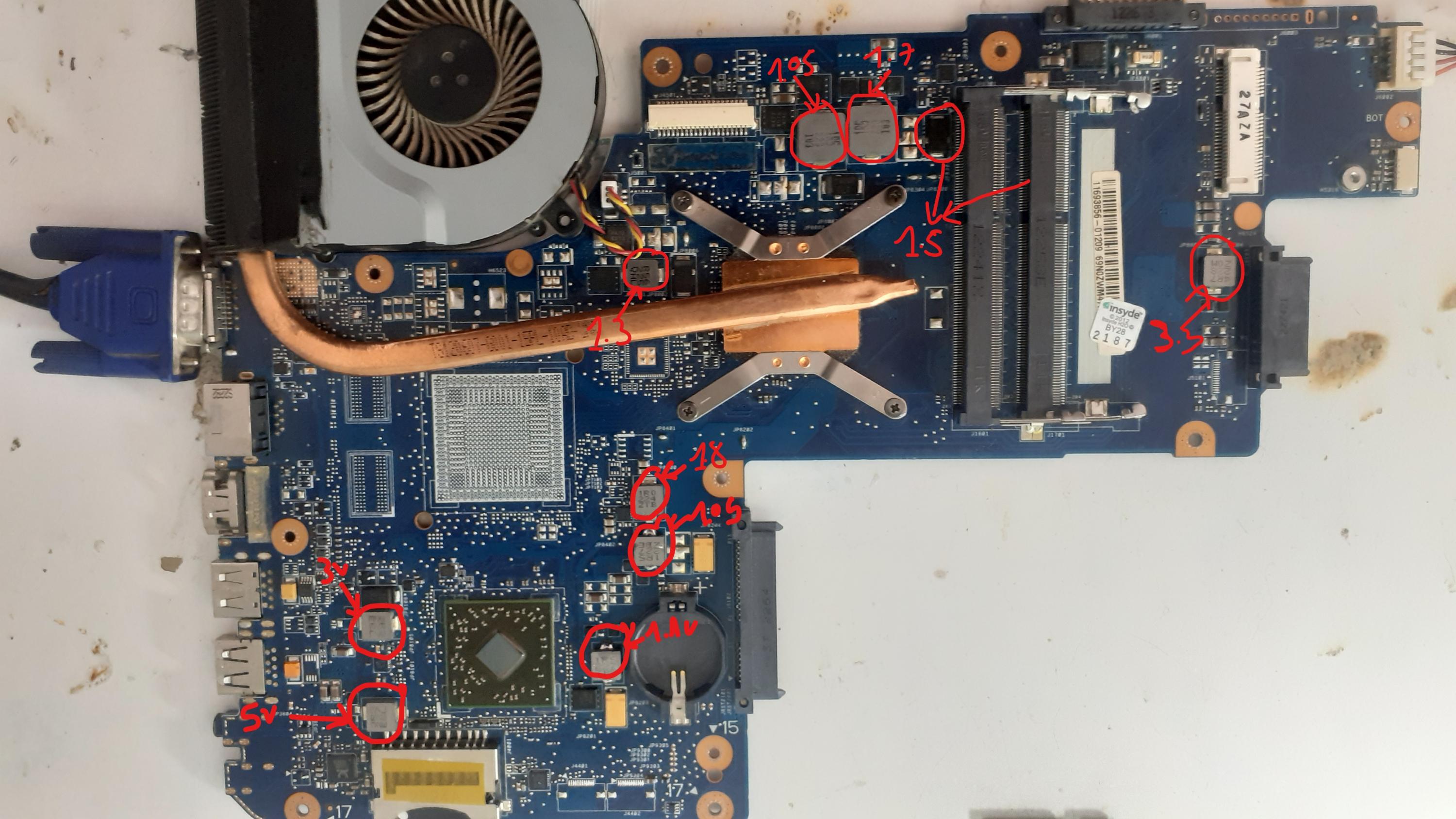

    hi
    Toshiba C850D PLABX CSABX UMA DSC rev 2.1
    builtin amd cpu
    chipset amd

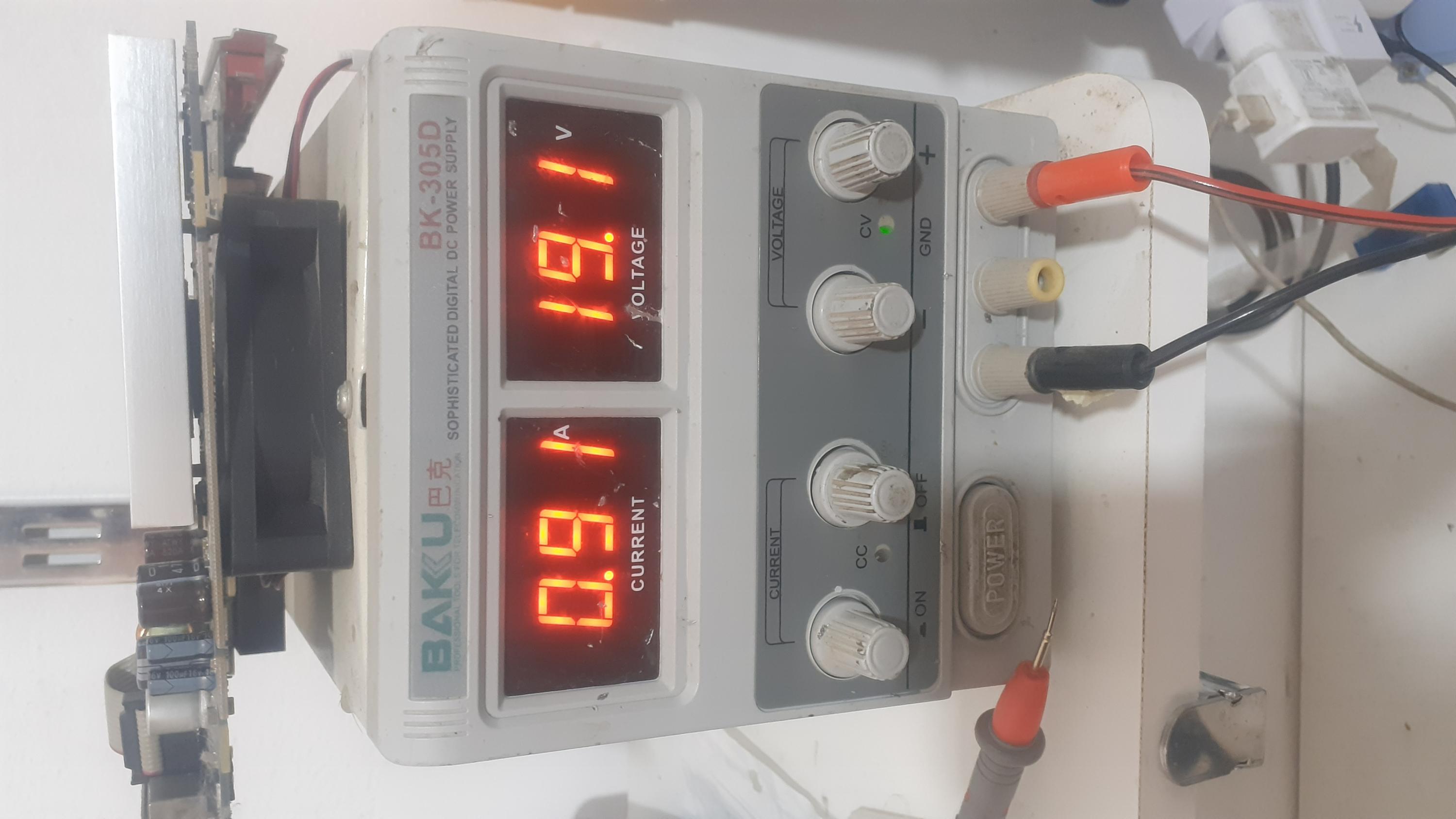

    turning on with black screen and 0.9 amps consumption
    all the voltages needed are present
    i try flash bios with different files but same result
    i suspect in cpu or chipset .

    Consumption on dc supply(after turning on)
    01.With Ram stick
    02.Without ram stick?

      Re: toshiba c850d black screen
      01.With Ram stick
      almost a same consumption .

          but i have ram voltage 1.5v and vtt 0.75
          can you clean to me the origin dump .
          i can't fine any schematic for this model just a boardview .

              yes the cpu is amd apu
              i check and found all ram requirements
              VDD SPD = 3.3V
              SDA/SCL =3.3v
              DRAM_RST# = 1.5V
              also i try a different ram and same result .

                  according to the boardview SDA/SCL connection between fch and ram slot is direct no mosfets .
                  i think i check all requirements
                  VRef_DQ
                  VTT
                  VRef_CA
                  VDD SPD
                  SDA data
                  SCL clock
                  DRAM_RST#
                  all are ok nothing missing .
