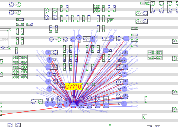

    Hello friends, I have this mac 820-02098 to which liquid spilled, I cleaned it and checking it is short-circuited, I do not have a green or orange light, PP3V8_AON is short-circuited, change capacitors and even so, it is still short-circuited, please help me to fix the macbook ,
    these voltages I have
    PPDCIN_AON : 5v
    PPBUS_AON : 12.2v
    PP3v8_AON_VDDMAIN :0v

                  Re: help! macbook a2442 / 820-02098 does not turn on
                  Originally posted by mon2
                  Consider to increase the current if possible on your power supply. If it is not possible, increase the voltage.
                  A key concern is if the high side CPU power rail is shorted with this one. This is the reason to keep the voltage as low as possible but increase the current.
                  Our short killer which claims to support peak current of 30A will often find offenders at 5-8A. Usually a bad ceramic and/or tantalum capacitor. They crumble under the current using 0v8 or 1v0 setting.
                  I have a power supply up to 10a
                  from what I see the short circuit is not related to the cpu
                  I leave you an image of the sector
                    Ok, crank up the current setting till someone cries uncle. You can apply IPA (alcohol) to see who is heating up. The heat will cause the IPA to mist or evaporate quickly.
                      I got to 8.5a and didn't notice anything , do you think I should remove the capacitors that were with that leak and discard that sector?
                      • mon2
                        • Dec 2019
                        • 14418
                        To confirm, the power supply is reporting that the rail is consuming 8.5A ?
                        At this setting, someone has to be heating up. Have you check both sides of the PCB?
                            I still can't find the shorted component, I've tried isopropyl alcohol and nothing, am I doing something wrong?
                            I inject voltage into a capacitor where the short is and nothing gets hot,
