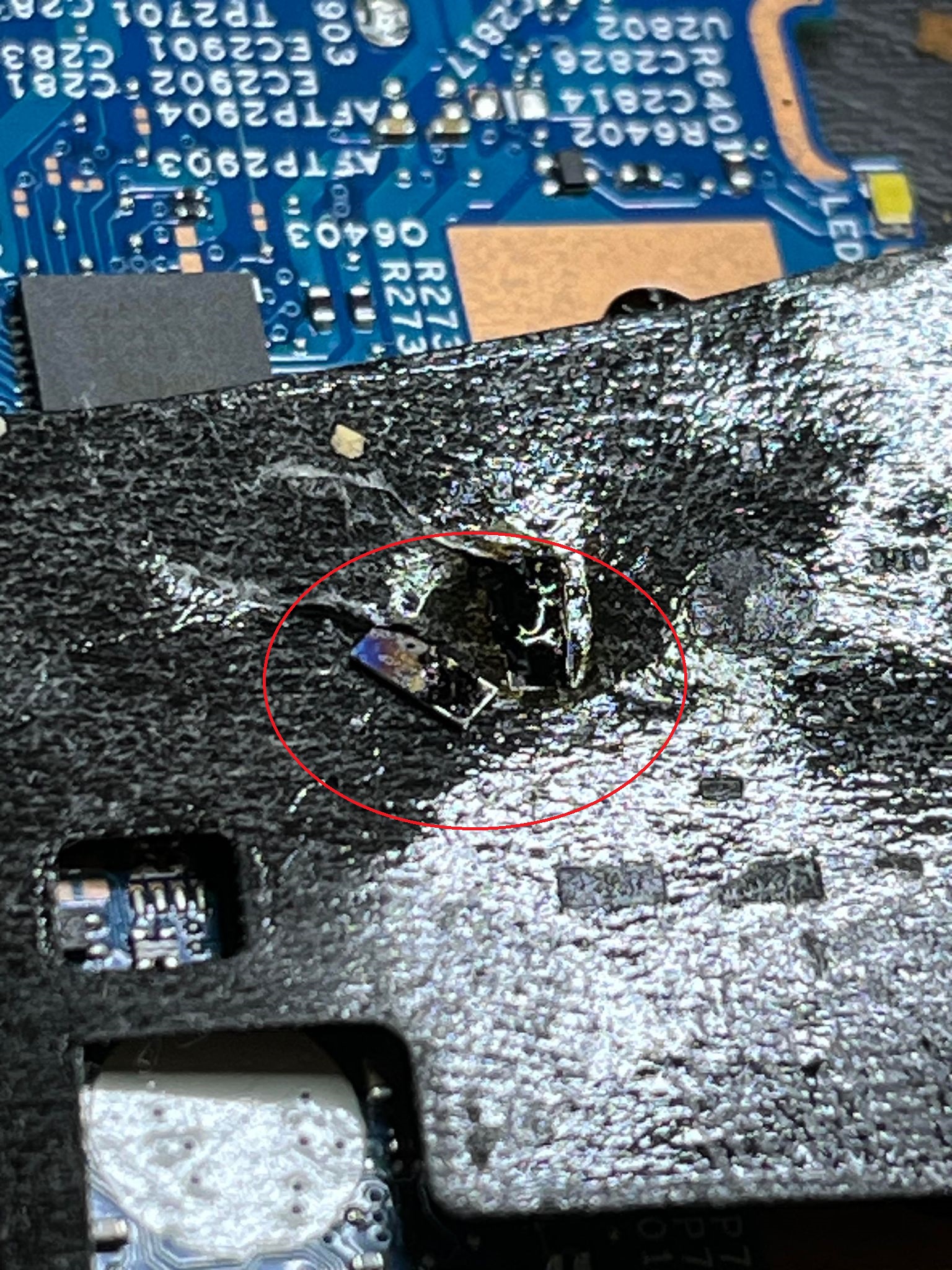

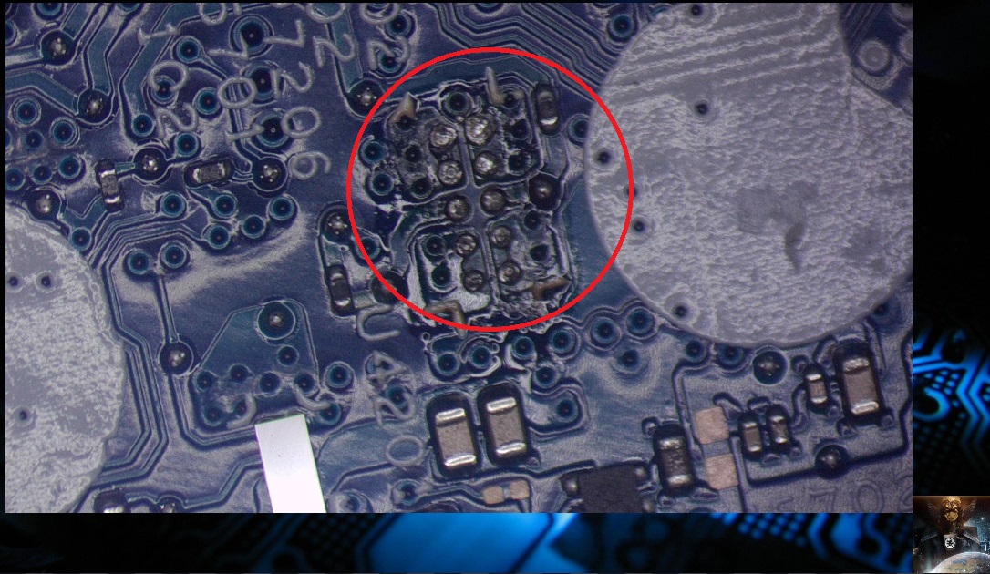

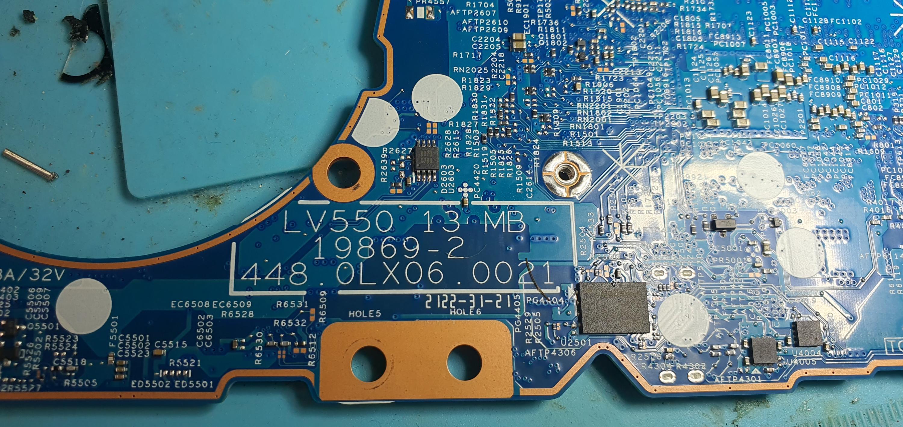

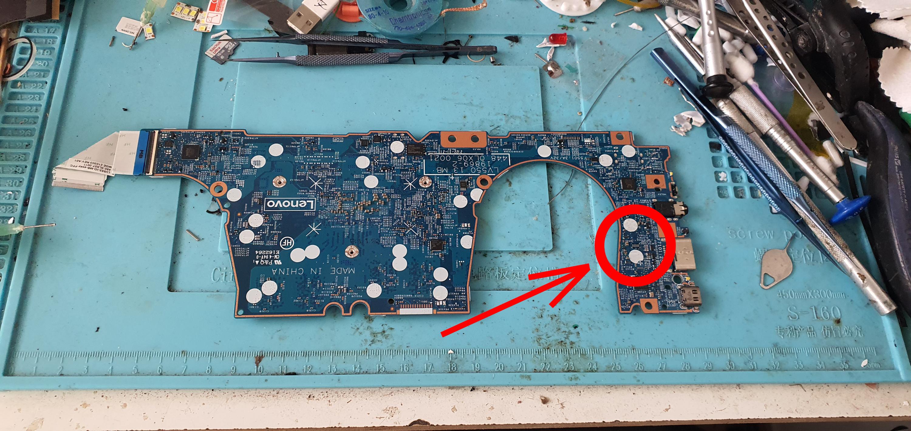

    Hello everyone
    I would appreciate it if you could help me identify the missing IC
    This is a lenovo thinkbook LV5500 13s g2 itl board

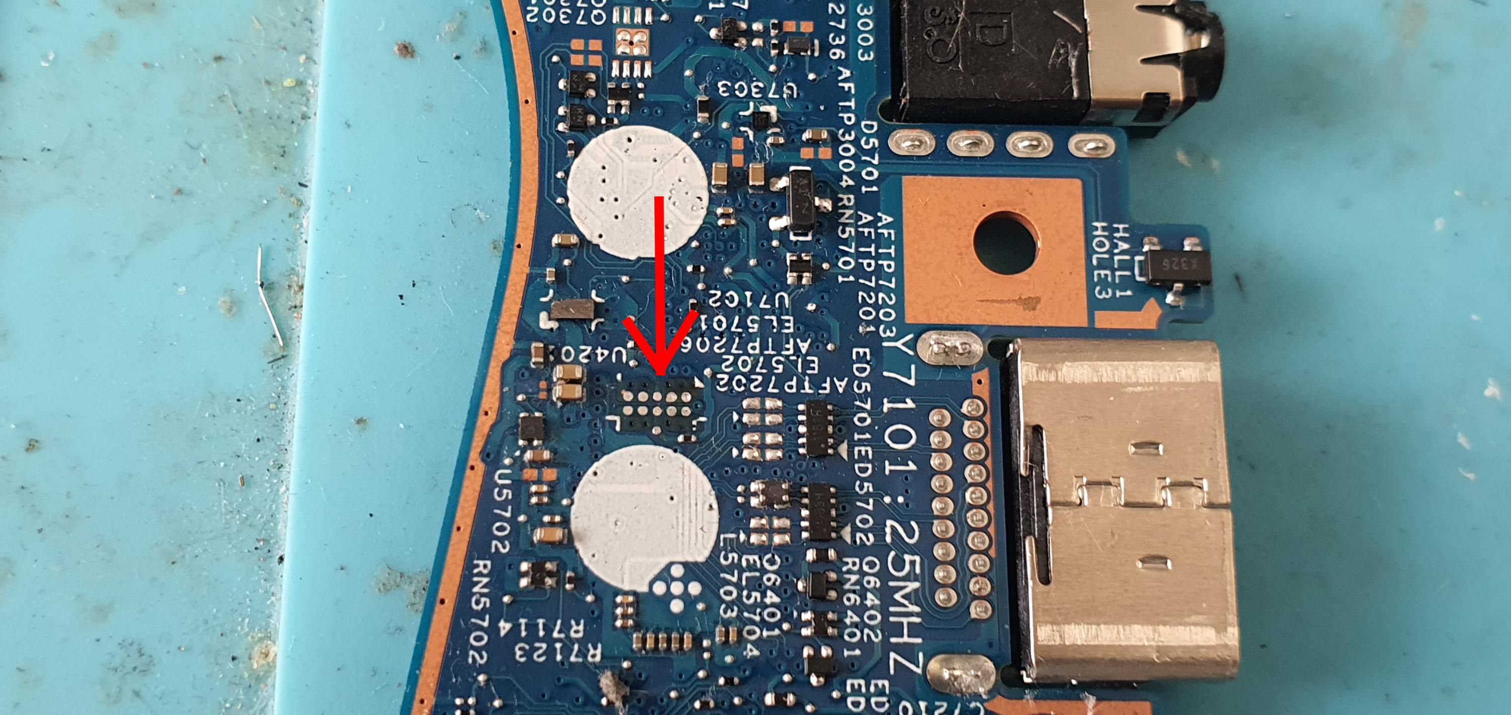

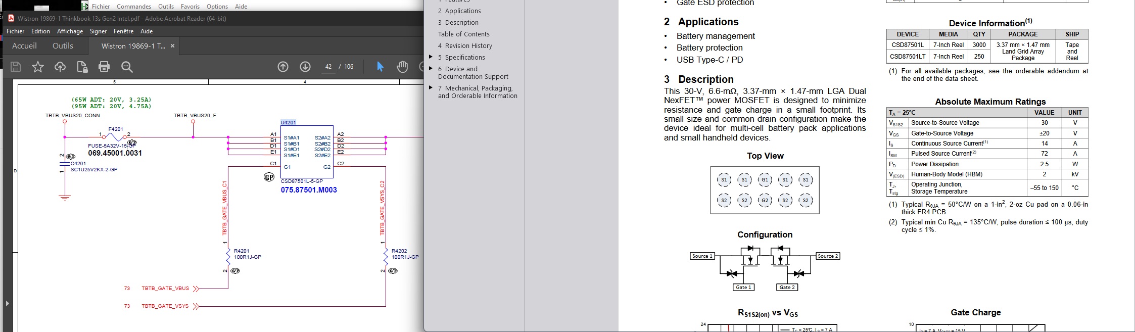

    Re: lenovo 13s g2 itl missing ic identification
    CSD87501L-5-GP
    30-V Dual Common Drain N-Channel NexFET™ Power MOSFET
              Probably.
              I ordered 5 units as it was not possible to order a single one.
              and in the meantime I have already repaired 2 more computers with the exact same fault.
              in all three cases my customer left a charger permanently connected, this is probably the key to the malfunction.
